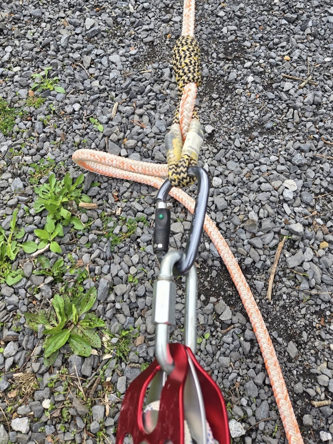

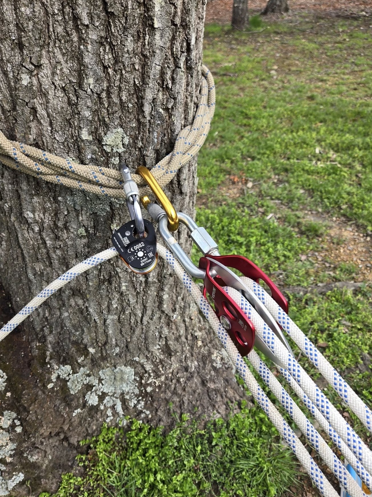

Ropes with lots of stretch are great for climber fall arrest or using a rubberband effect to pop stuck vehicles out of mud but I'll stick with the consistency of a stout 3/4" static bull rope with a 5-1 fiddleblock pulley block attached for dropping trees. I use the same set up even if I plan on pulling with a truck or tractor.
Fiddleblock attached to bull rope.
Fiddleblock attached to anchor.
