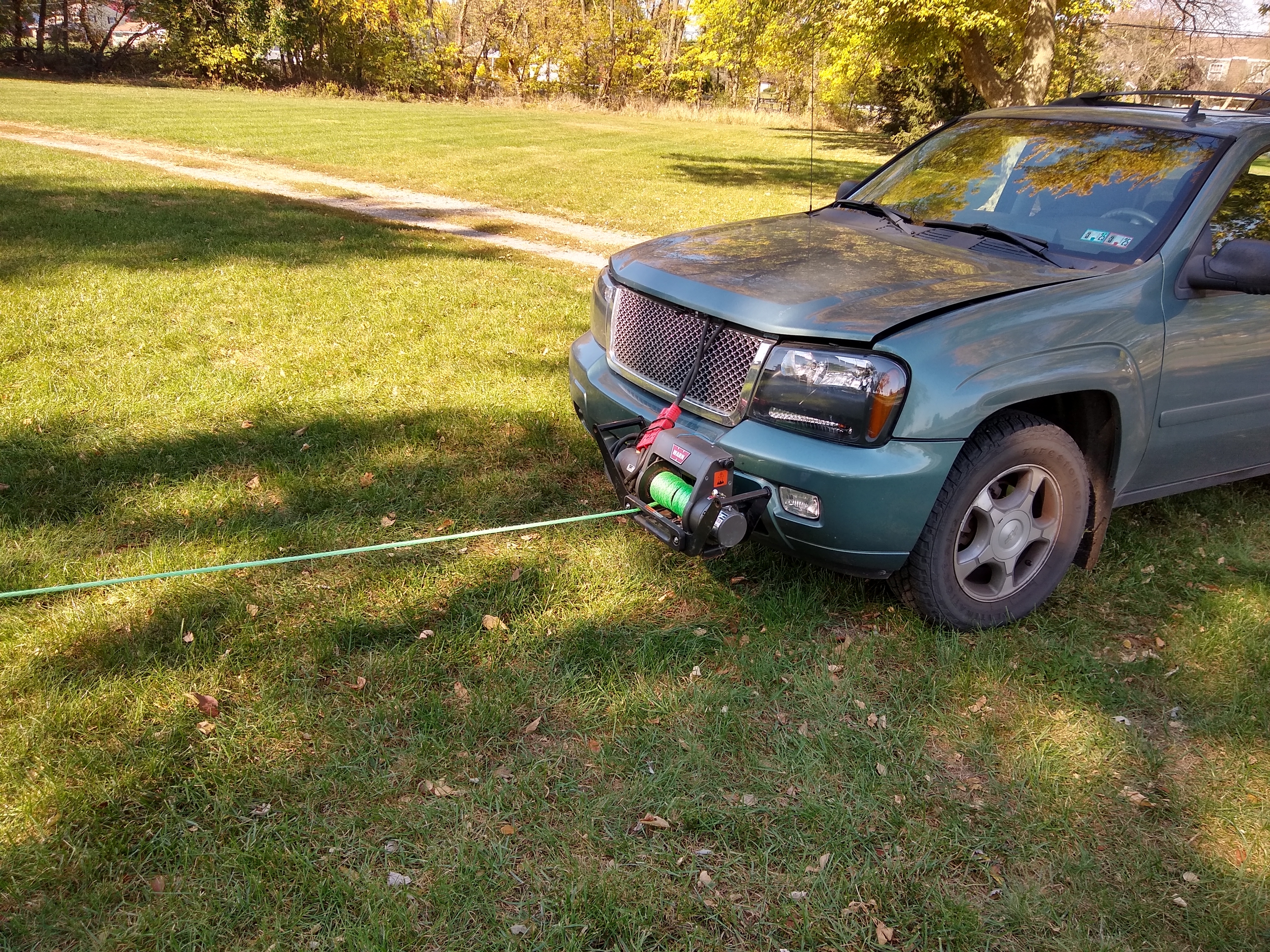

Winch with a rope longer than tree height. A little tension while notching, then complete cut while reeling it in.
