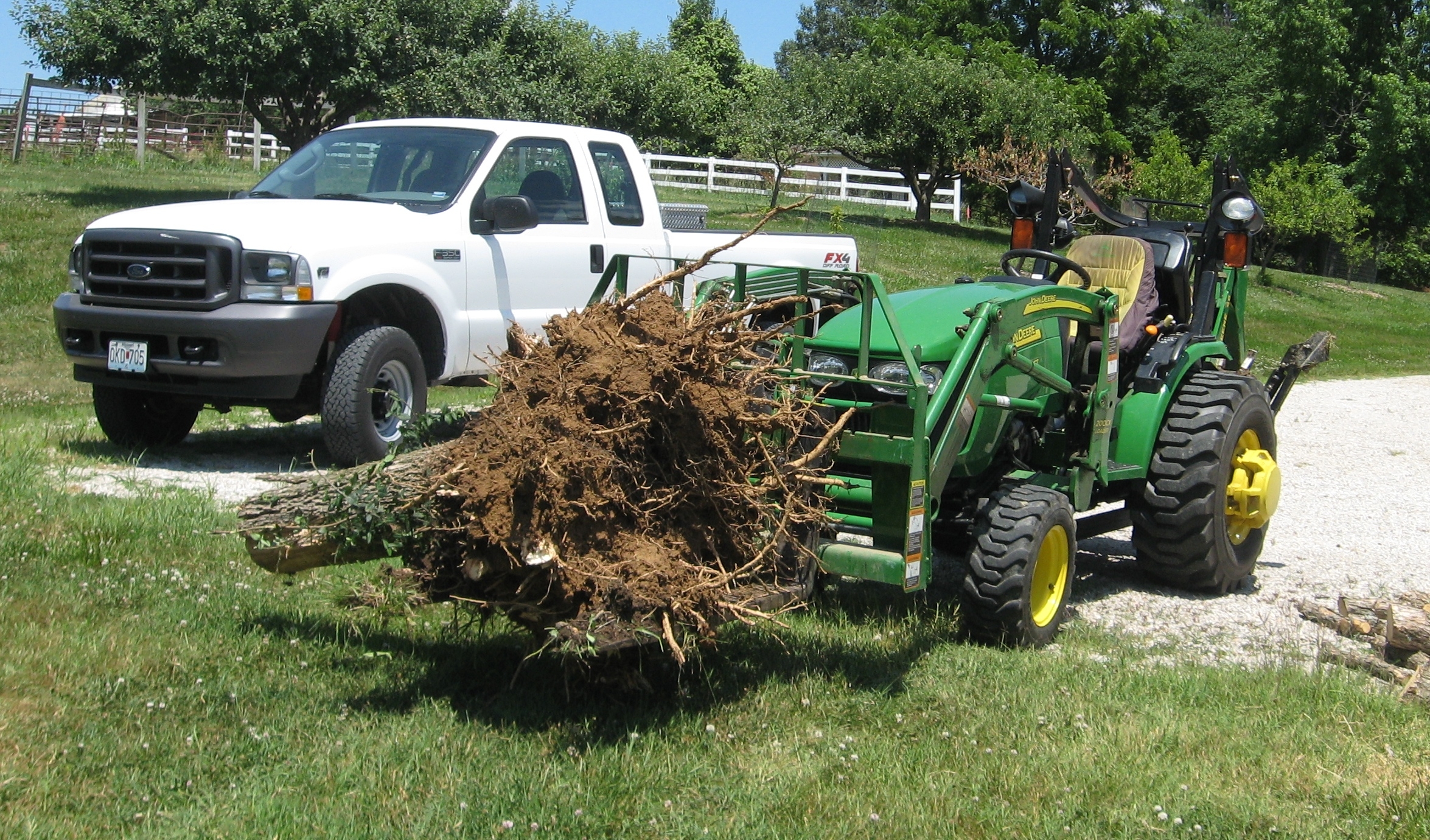

My personal cut won't do it, but the bigger machine I used last time.
I just worked the bucket under the roots and moved the tree, then back fill and smooth.
Tears up a 9' wide swath for each one, but 2' diameter trees are no problem for a loader if you work at them a little.
The 644 is faster to road to my place than a dozer, and I don't usually feel like loading on a trailer.

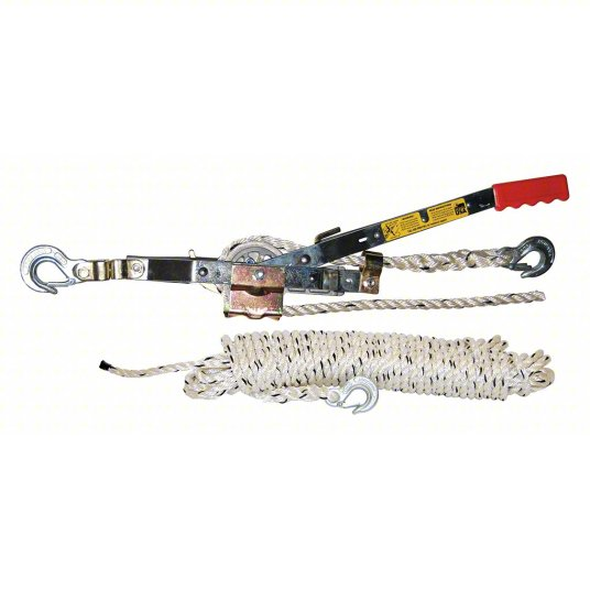

Preferred process for back-leaners:
  1. Use throwing bag, rock, or slingshot to throw a lightweight line as high into the tree as you can, looping it over a major branch.
  2. Use lightweight line to pull your heavier line up into place. There may be a medium line involved, if light line is not sufficient to pull heavy line.
  3. Tie bowline loop or other free-sliding knot in free end of heavy line (from ground), so it can be pulled up and cinched into crotch of tree.
  4. Tie bowline into far end of heavy line, and figure out what tree base you'll use for your pulling. You really want more than 1:1 scope, preferrably 2:1 to 3:1 in run:rise.
  5. Attach strap to tree base that will be used for pulling, and attach winch to strap. Play out winch line and attach to your heavy pulling line.
  6. Tension only enough to lift rig (winch + line) off the ground.
  7. Make face cut.
  8. Start back cut. As tree tries to sit down and pinch bar, either drive in your wedges or have someone tighten winch just enough to prevent cut from closing, but not enough to put tension on tree.
  9. Finish back cut, get you and your saw out of the way, and then start cranking on the winch.
When you see trees barberchair, and basically explode while someone is in the middle of their back cut, there's a good chance a too-tight winch was involved.
Most of the time I put a line in a tree, it ends up being nothing but extra insurance that the tree doesn't fall backwards onto whatever I'm protecting, and I never end up having to even use the winch. You can do a lot with a few plastic wedges. But the point is, if you're going to use a winch, don't tighten it beyond the point of just holding the tree, until after the cutting is done.
