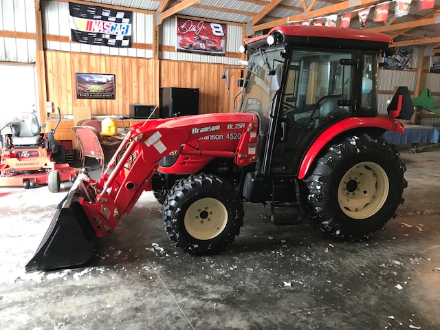

How do we know you really have this tractor, WITHOUT PICTURES !!
Gotta have the pictures.....:D
/ Purchasing a used 2014 4520C
#22
Branson 4520C 2.jpeglol. Here it is...
#24
Nice Machine !
I have 4520 no cab, with 12 hrs on it. I think I paid a little more than you for it, but you got a SMOKIN deal.
Do you really think it was that great of a deal? My father-in-law seemed to think it wasn't a good deal.
/ Purchasing a used 2014 4520C #25
Well, I paid 21k for a new 4520 with loader and no cab.
You bought one for 19.5 with a loader, cab and only 38 hrs.
I would call that a smokin deal, I used to sell Branson tractors in another life time...
