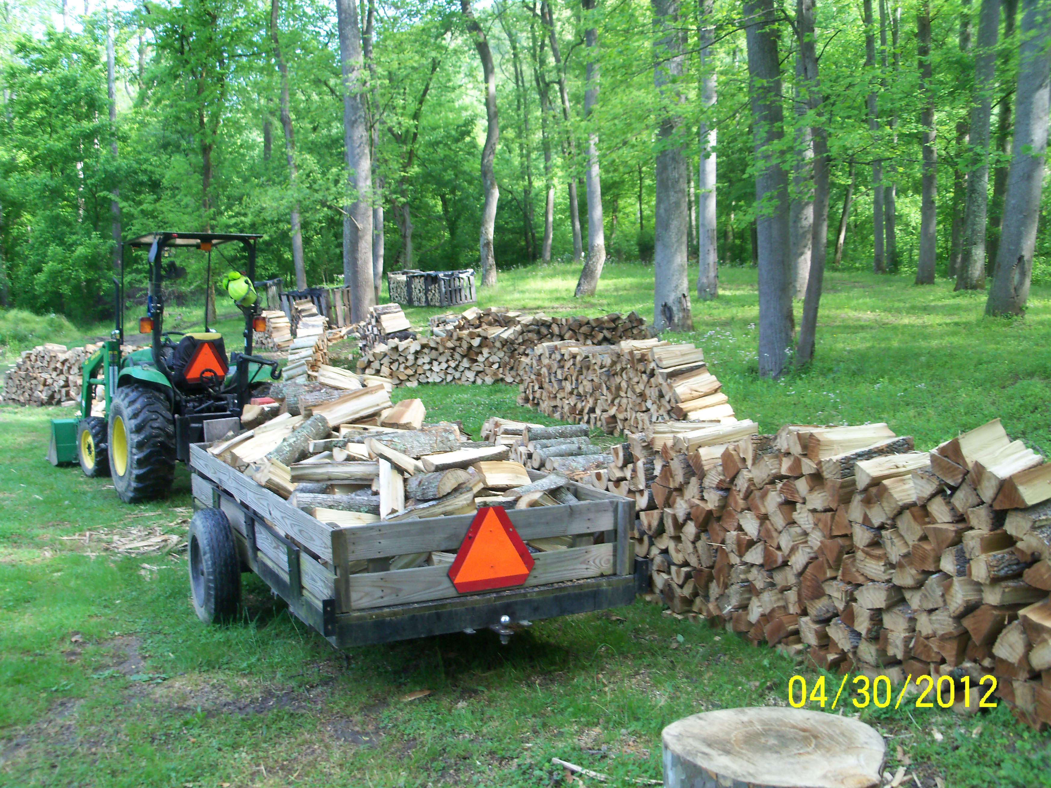

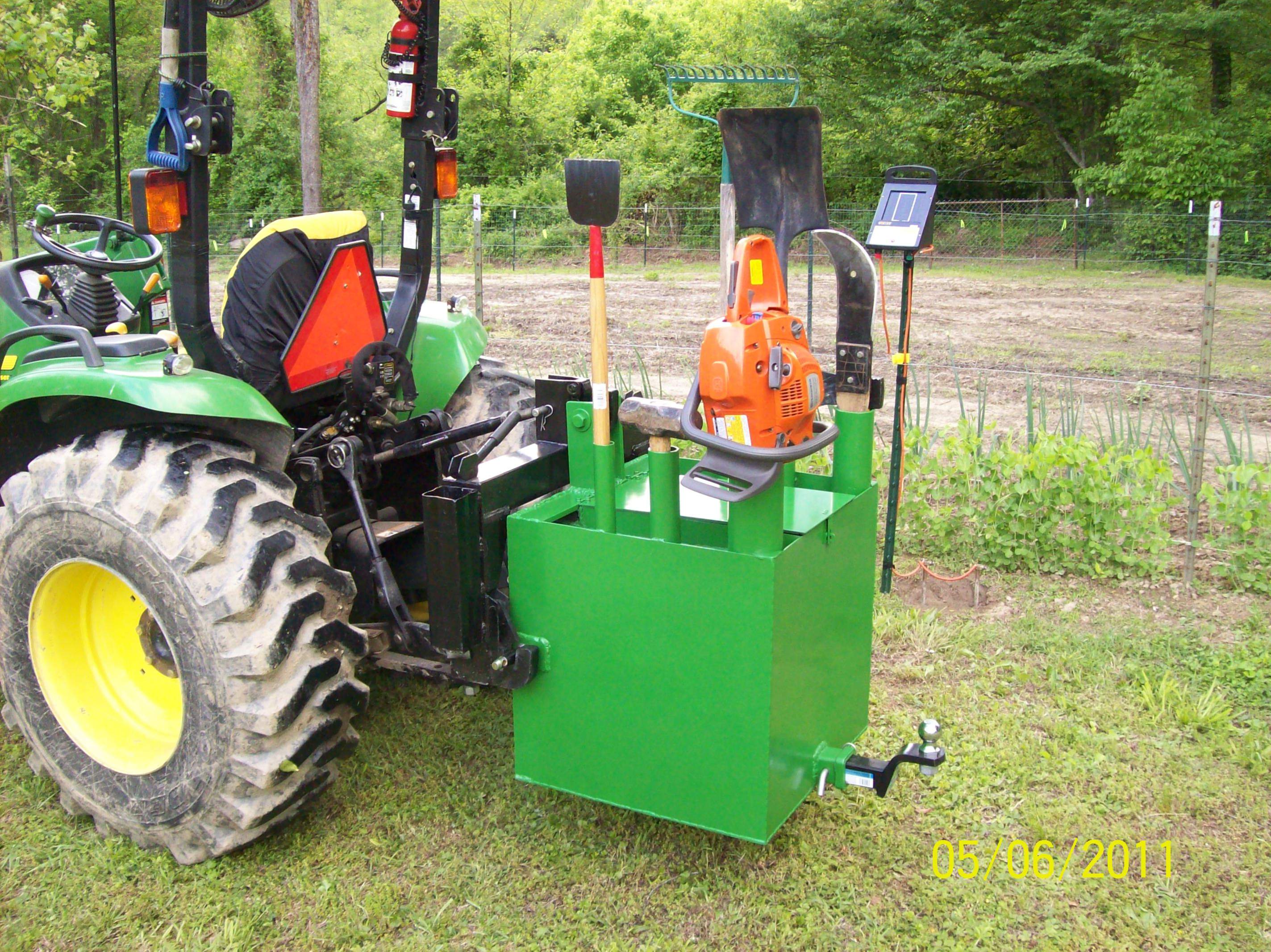

My Ballast Box weighs 1381 lbs. and since I use my QH, That would add about 65 lbs...So 1446 lbs. on my 3PT Hitch.

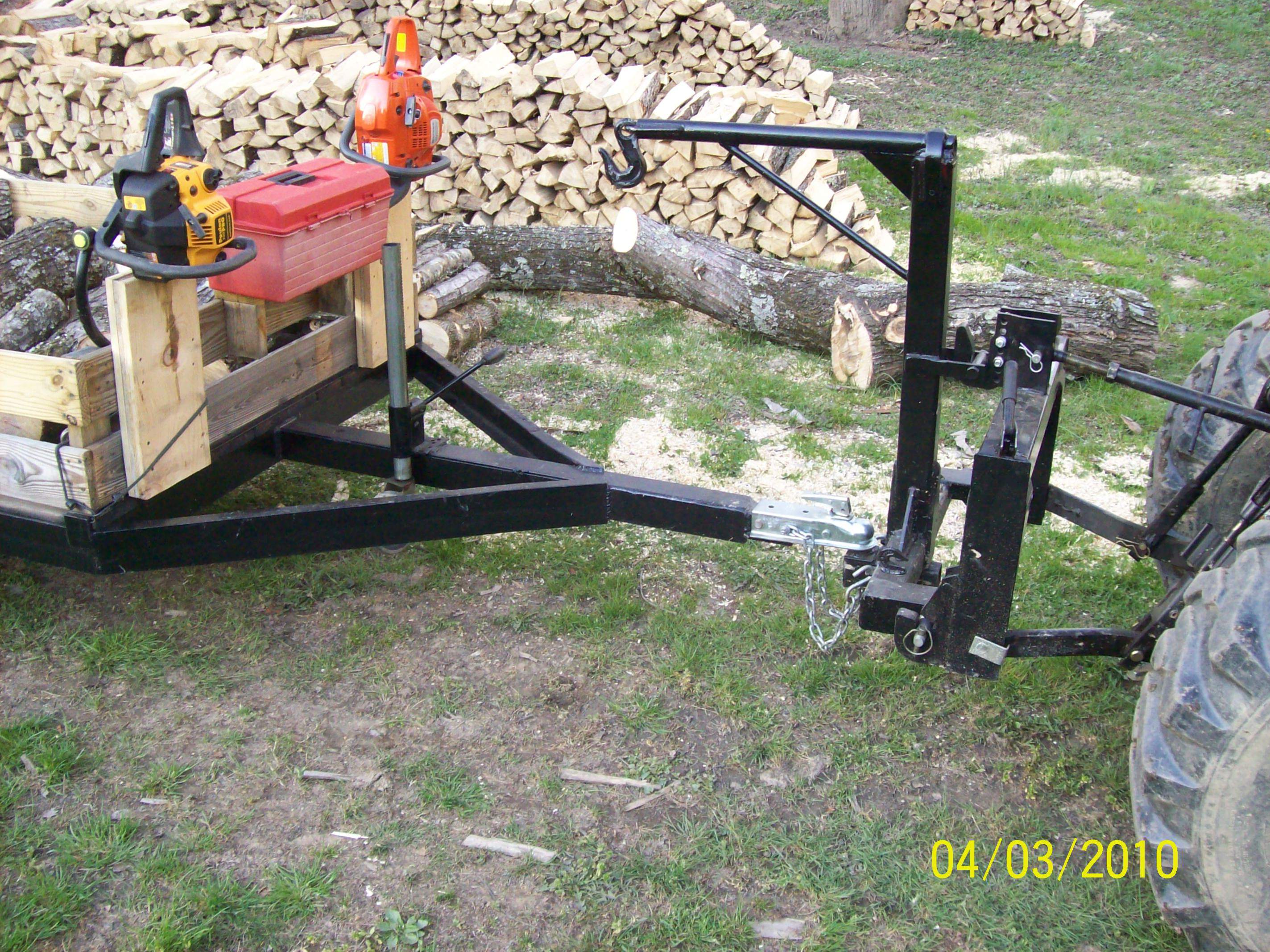

I've been hauling firewood in the past couple days, and using my homemade log/trailer hitch to pull my homemade firewood trailer.... Also, The log/trailer hitch doesn't weigh much at all... Probably not over 170 lbs.
I don't know how much my firewood trailer weighs empty, But when loaded with wood it's kind of heavy!... Especially pulling up the hill loaded!!!
Question:
If I pulled the firewood trailer behind my Ballast Box... Would that be ''too much weight'' for my 3PT Hitch ??
I have a steep hill to go up and down when hauling firewood... When I have my log/trailer hitch on and have to pull the empty trailer down the hill, I don't have enough traction on my rear tires!!! :)... I have forgot to put my tractor in 4WD a few times and slid all the way down the hill! :eek::D... I go down the hill in 2ND gear!
If we get any rain.. I don't haul wood because the hill gets slick!!!.. Been-there done that!!! :)
So what do you all think about pulling a loaded trailer with the Ballast Box on ??
Thanks!!!

I have a box like that and it will change the point of connection further back, and I had trouble with the trailer wanting to jacknife me going down a hill. It can really push the front back and forth because of where the trailer coupler is, so far behind the tractor. Just a thought ..

If it were me and wanted more weight on the rear tires I would move the trailer axle rearwards instead. Shifts more weight forward and forego the ballast box hooking up to the drawbar.

You have an unusual hitch & crane that moves the hitch back quite a bit in the first placce. This hurts you on the hill.
The weight box will add more traction, but move the hitch back farther yet. Might come out even, but you have a real jack-knife setup there.
I think a lot depends on how you load the trailer - more weight up front, or about balance weight....

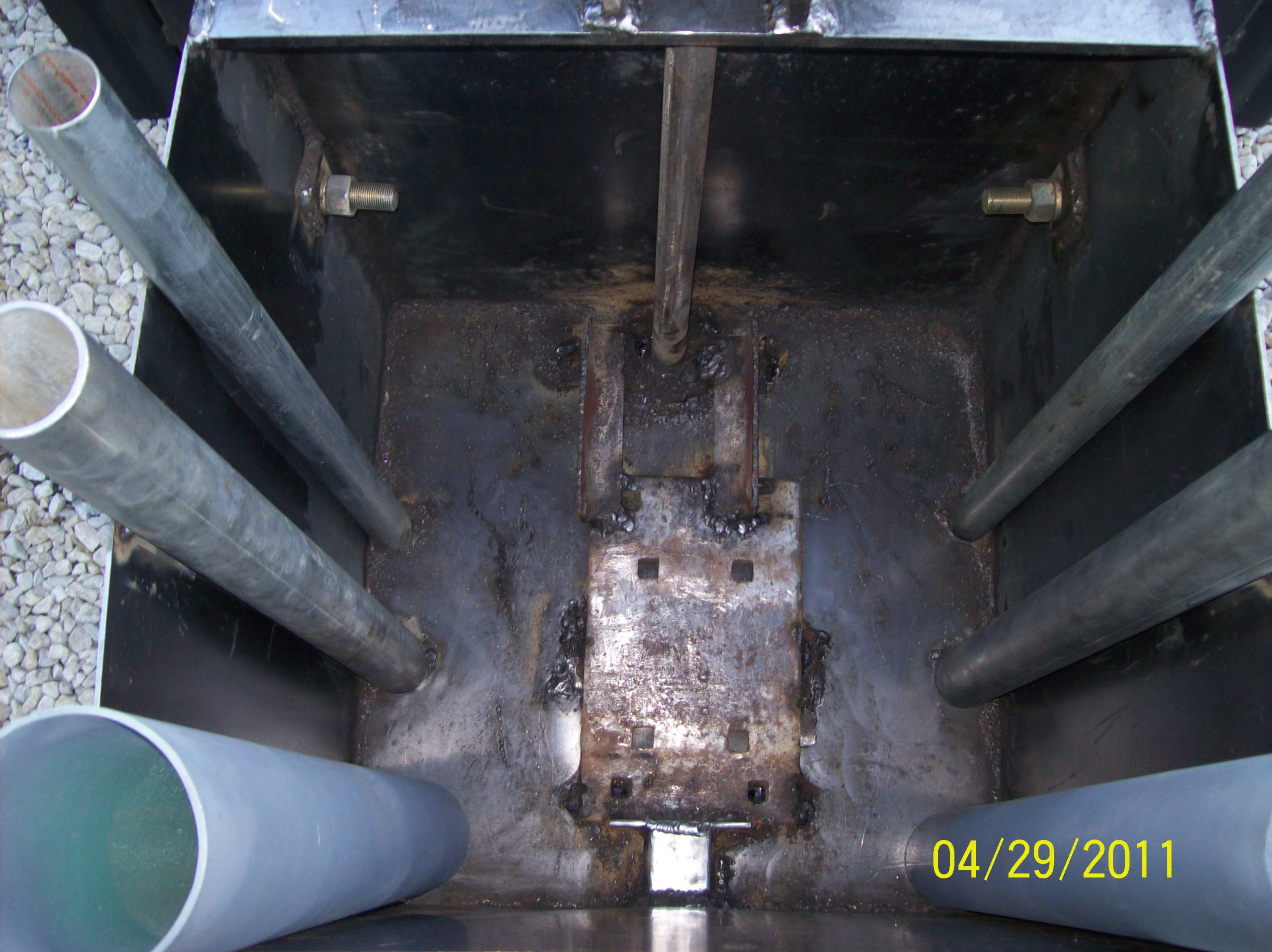

Question for you...is the hitch on the ballast box butt welded?Or, did you cut a hole in the box for a more substantial weld? Just curious...
The hitch goes all the way through and welded up good!
Here's a picture:... (This is the ugly part of the box!):)... It was hard welding down in the box because it's 2'x2' and 2' deep!... Hard to stand up and reach down to the bottom to weld it, and the smoke and arc flash was bad!!!... Had to watch out and not burn a hole through the bottom, Because I used 1/8'' metal to build the BB.
I didn't try to clean my welds up on the bottom, Because concrete covered it all up!:D
The hitch is welded to a railroad plate, and the RR plate is welded to the bottom... It also has 2 pieces of angle iron that's welded to the front part of the box with a piece of flat-bar under the angle iron!... I wanted to make sure it was welded up good so it wouldn't pull out!

If you have a welder and you are handy consider making the rear axle slide to adjust the load on the hitch. You can have it adjust and pin in place, similar to big rigs. The reason I prefer this method is the tractor has less overall weight to deal with compared to adding the heavy ballast box.
