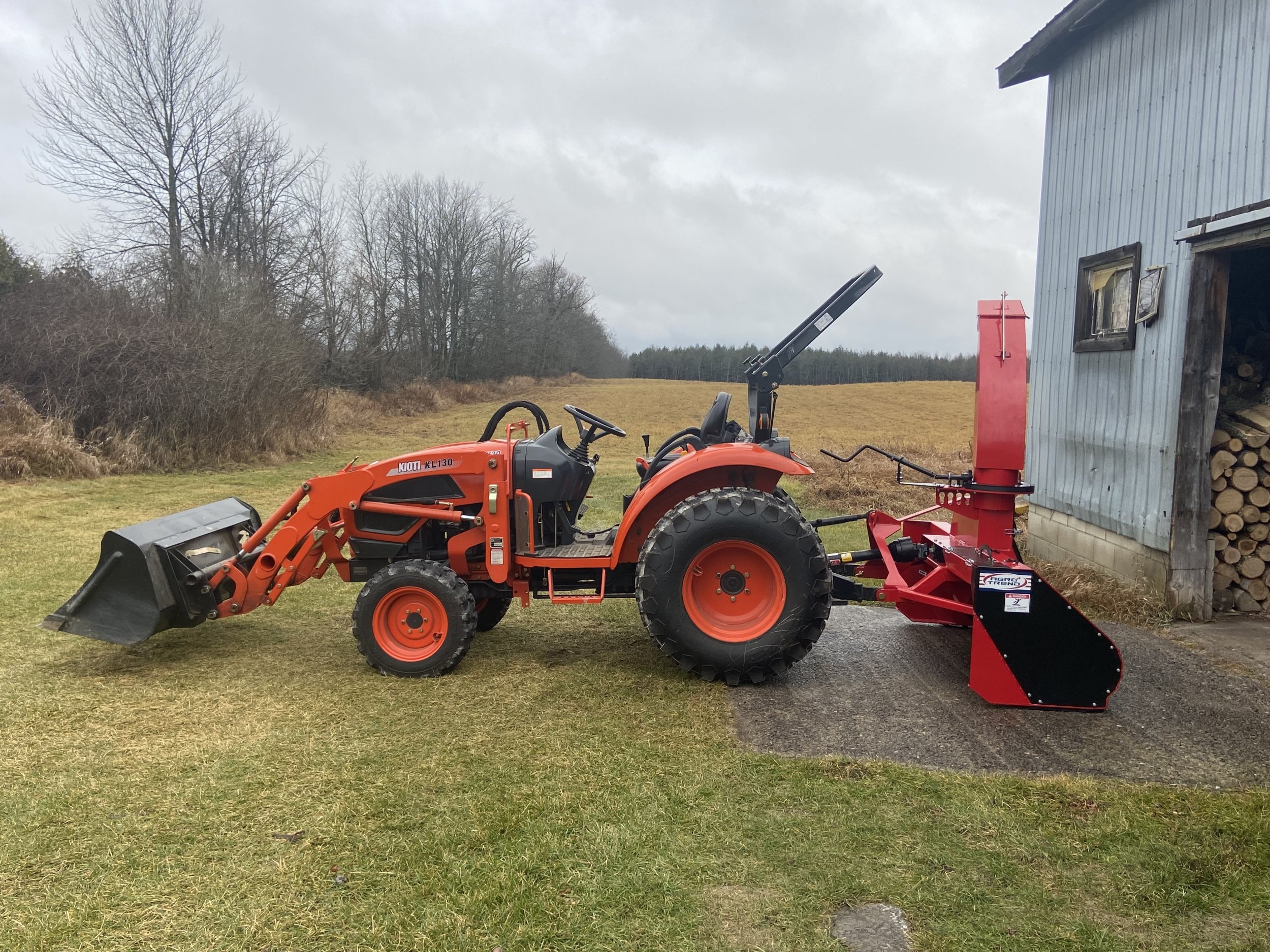

Back a few pages I mentioned that my Kubota/LandPride hybrid snowblower presented a puzzler because we couldn't raise the back of it and thus couldn't use it on my gravel road. The folks at the dealer went to work and modified it by getting rid of the goofy spring suspension thingy at the front and welding an extension on the skid so I could raise the back end and set the whole thing level.
Here's the result after an 8" snowfall. I call this perfect. I just drove around and let that rascal float up and down over the bumps in my road. Beats the heck out of working.
Here are some thumbnails to show what they did. Click on them to embiggen.
This is the way it sits now -- level, 2" off the ground.
This is the view from the inside, showing how they modified the trailing edge of the skid.
