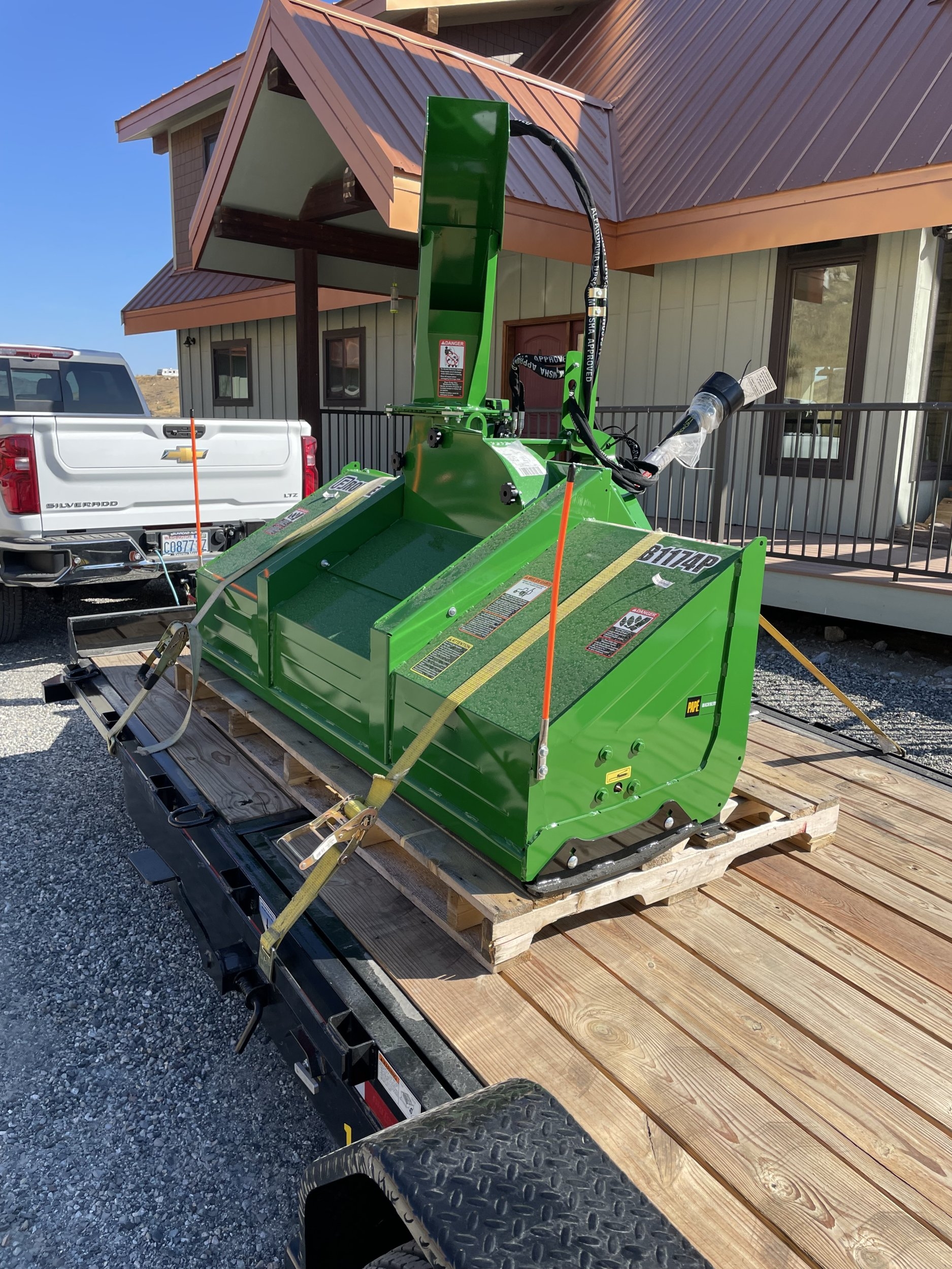

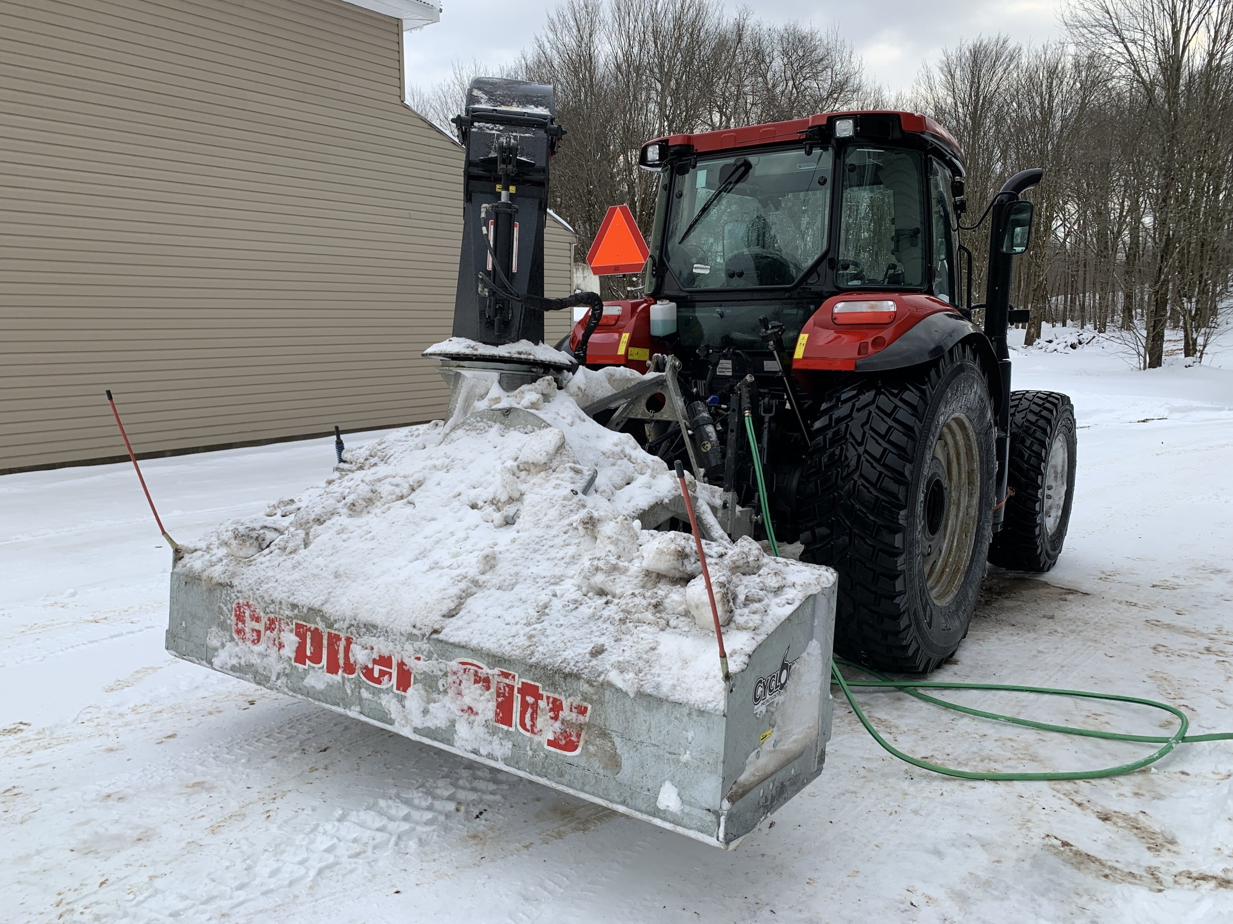

Thats odd. They look a lot like a Cyclone. When a Cyclone is sitting level the cutting edge has a 6 degree pitch. Lowering the front makes that pitch more aggressive and raising the front makes it less aggressive.

It pivots on the shoes that sit closer to the tractor. Put more pressure on the shoes and the cutting edge raises up...within reason of course.

Little diff idea than I am use to but sounds like it should work

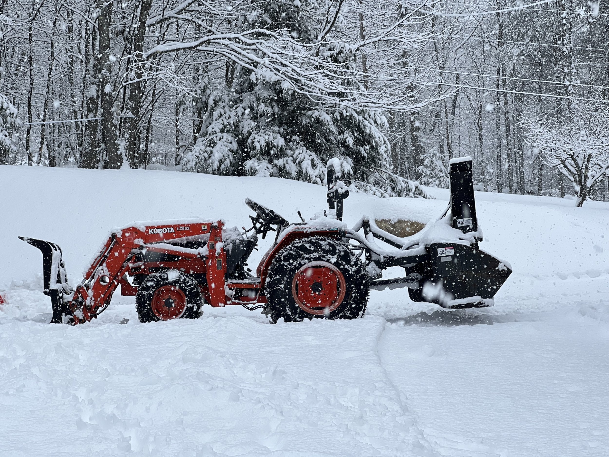

WIFO WBPT84
They call it an 84" but with the bend on each side panel making wings it cuts an 87" swath.
Just a basic inverted not Hybrid, but it works really well with
20" auger and 27" x 10" Impeller.
It saves time doing the drives and parking areas versus old method of bucket forward and then plowing in reverse with the Gannon Box blade.

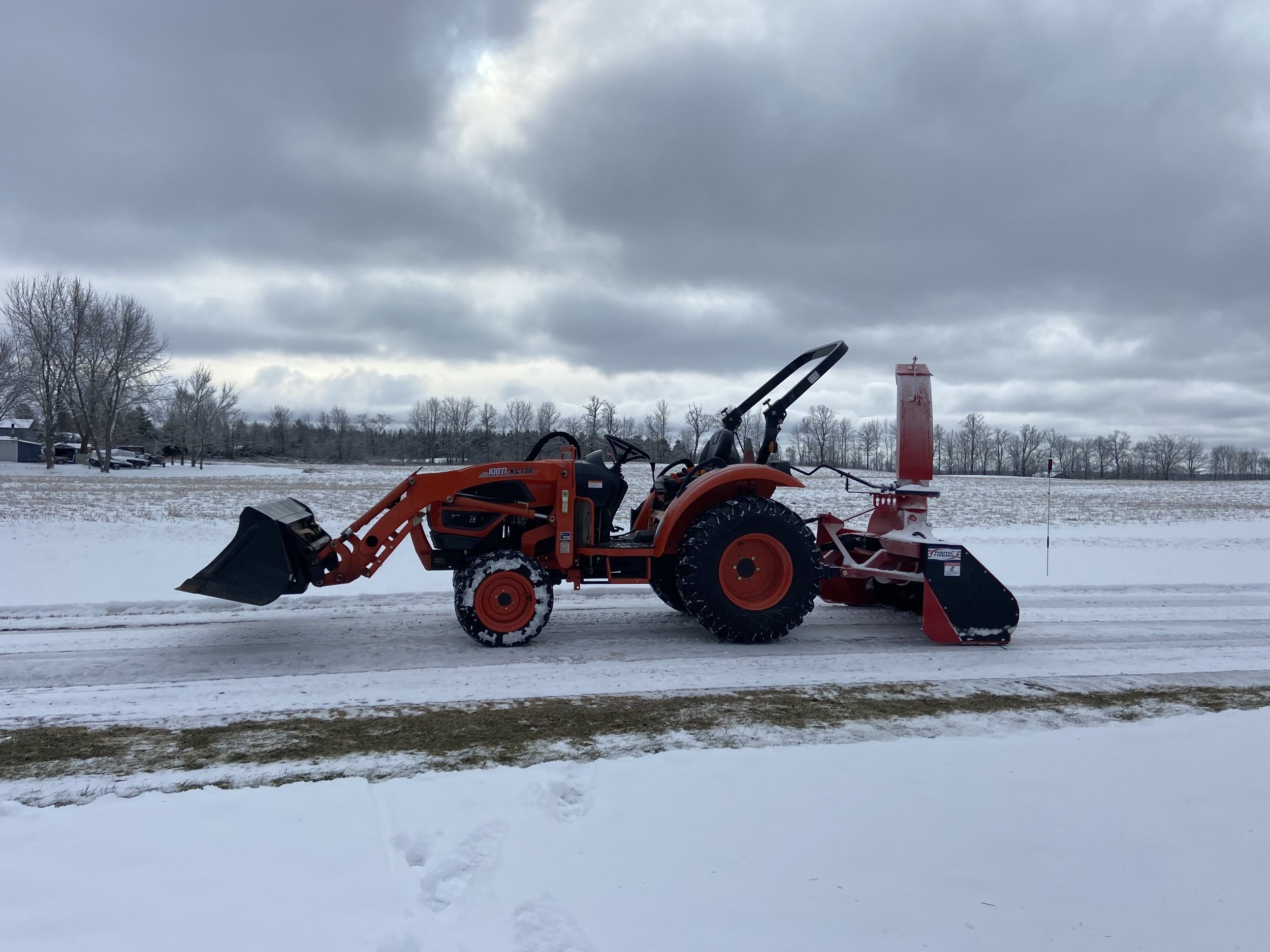

Well we finally had enough accumulation to try out my new Agrotrend Inverted snowblower. It’s different in the sense that I’m not blowing the snow at something/somewhere as opposed to swiping it away. Not sure if I can quite explain it. As you can see it scrapes the driveway like a close shave with a razor. I did install washers between the frame and sliders and I’d like another 1/2” of height but it is the first blow of the season. As the ice pack builds it should be easier to leave the gravel. Although I didn’t catch much. I like the fact that I’m driving forward (obviously) but because I’m driving in snow the traction seems better. It’s VERY easy to go slow when required without much tire slip, and the cutting edge totally removes any tire tracks. I’m sure that the more I use it the more I’ll be able to adjust to this style of blower. But for now I like it more than my previous back-em-up blower…
Ominous clouds in the picture due to the pending storm that’s just hours away….😬

I think we're finally seeing the US market wake up to Inverted Snowblowers as myths are dispelled.
