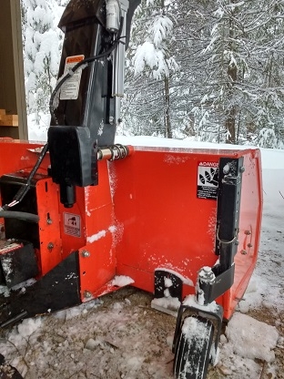

   / Modification to reduce gravel ingestion on SnowBlower #6
These are adjustable so the edge can be set to any height. By the time winter is going full bore, the wheels are adjusted so they are just dangling, and the skids keep the edge very close to the ground.
