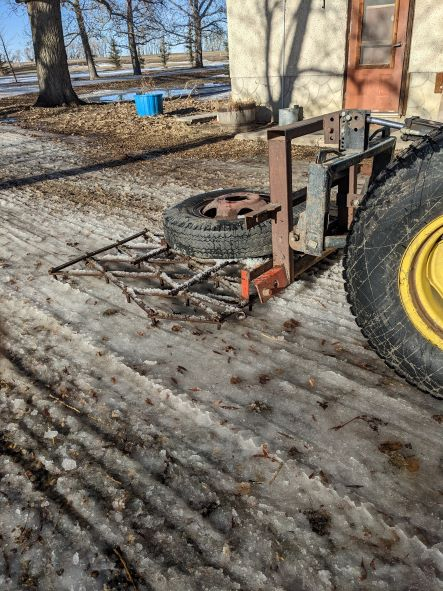

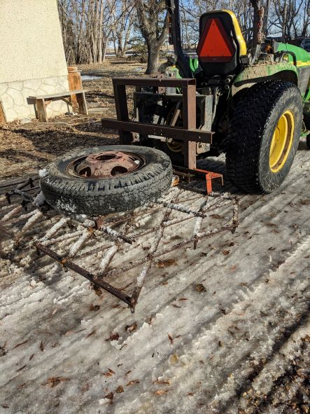

I usually like to pack down about 3-4" before I use the blower. If it get's icy in spring I just run my diamond tooth harrows in reverse and it chews up the ice enough that there is good traction.

The disc harrow sounds like a neat trick. I spread some sand in critical areas, if it gets icy.

This is what I use on ice and it works great. Just go in reverse and the teeth shave the ice and you end up with ice that isn't slippery.
