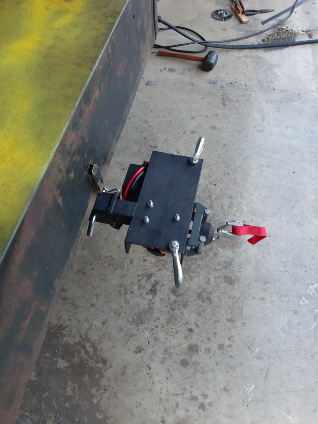

Separately from your questions, today I fabbed up a receiver hitch and custom hitch extension to be able to rear mount my winch or tow a trailer. the front receiver was a much easier project. you can see that I do not have the electric/hydraulic lift for the bed, would love to find the specs of what is needed there.
custom extension just clears the bed, and the receiver itself just clears the bed's footwell when dumping. of course the bed cannot dump with the extension in place.
extension clears the rear by just over an inch. pay no mind to the upside down winch, i was using it as a trampoline to see if i could get the front tires off the ground.. i could not.
