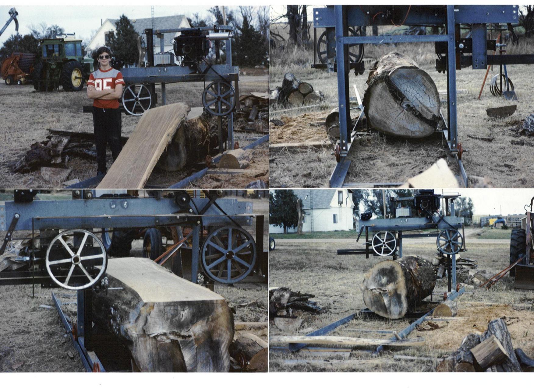

Lindsay's Technical Books at one time they had a book on the old type of saw mill
but if your going to try that I think I would consider building a normal type of band saw mill, and then just use Hydraulics to power it, yes a few hoses would be needed, but it would save a hole lot of problems in redesigning the unit and you remove the hazard of the PTO shaft, if your tractor does not have enough Hydraulics to operate it then consider a PTO powered pump, but then you can make a entire Hydraulic operated unit,
one of the considerations I had when I built mine was how heavy a log is and I built mine on the ground, (it sets flat on the ground) so logs do not need to be lifted, just rolled, on to the bed,
with Hydraulics you have a valve, and no need of a clutch, of any type, and there are a lot of plans out there, little to engineer, or redesign.
below is what I built nearly 20 years ago, no it is not hydraulic powered, but would be simple to power it with a hydraulic motor of the proper type and RPM.
put up a line with a few rings on it so the hose does not get tangled,
you can see how the bed is on the ground,

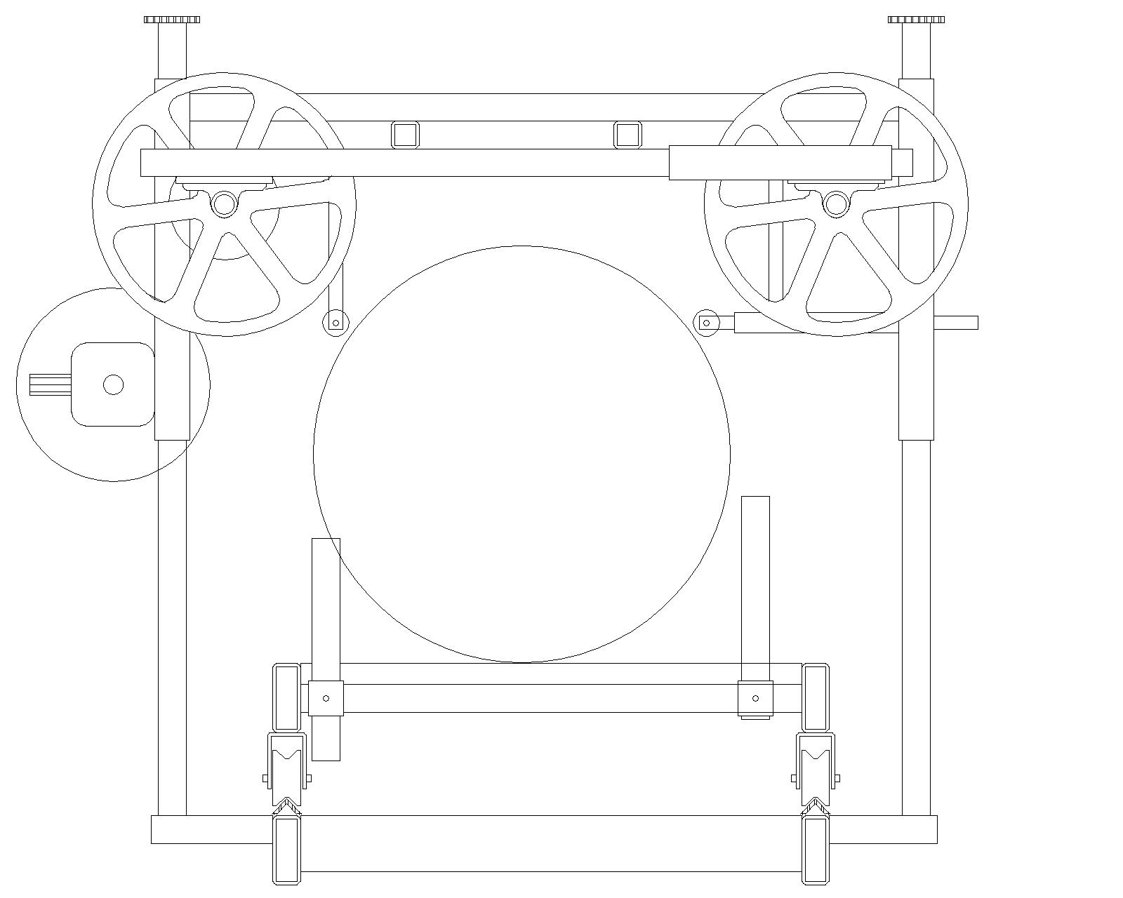

The log will move parallel to the rear axle of the tractor. I would mount a right angle gearbox on the saw carriage. I intend the mill to be used just at my home, possibly in an open shed. (built from home milled lumber of course)

Do you have a sketch of what you have in mind?
Have you operated a bandmill sawing logs, or a circular mill sawing logs?
Been around a Belsaw mill or operated one?
Just getting an idea where you are at. Wish you well with this plan.

Here is a quick AutoCAD of where I'm at. I just a quick line trim and turned off hidden lines to give a sense of where things are. Lots of details are missing! The log would ride on the carriage towards us. The tractor would be stationed on the left and plug into the gearbox shown. The operator, log loading and board removing would happen on the right.
Looking like a good basic plan.
Wondering about your previous experience with sawing logs, with log carriages, and with bandsaws. Any hint for us? :)

None. Well, I've milled a bit of lumber with a chainsaw following a 2x4. I also have a 5' sled for my woodworking bandsaw that I've used to mill lumber up to 12" diameter or so. We're looking to scale up a bit!
/ PTO powered bandmill #20
Then my advice would to at least get more information/experience/knowledge about the carriage systems used on circular sawmills. More info on what makes a bandmill tick-tock would be a good investment as well. Just so you don't have to reinvent the "wheel".
I think your plan has merit. But I can see some headaches too. But you may have all that covered in your final plan.
