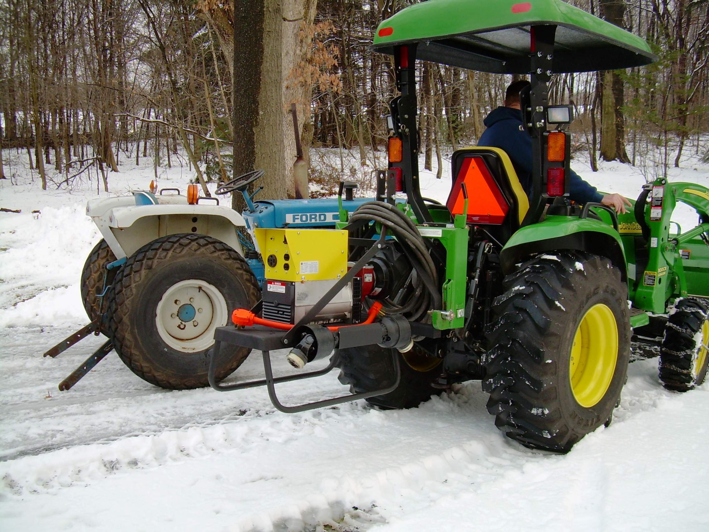

I like the generator discussions that start up at this time of year which happens to corresponds with the time I have to be on TBN (short days and long nights). I learned a great deal here from some very knowledgeable people. it is a personal preference but sometimes turns into an argument.
I have 3 portable gas gennys 3-5KW's that I use for work, one is a Honda 170 amp DC welder, recently bought a 10 kw pto unit. IMO the portables are great for just that, job sites, moving around the yard etc. but when I think about a real emergency worst case situation like a week or a month with out grid power in the middle of winter then to me the only way to go is diesel power (fuel storage/availability and engine life/reliability being the main factors)
First choice would be a stand alone diesel powered 4 pole (1800 rpm), 3 cylinder unit (check out Norpro) but they are very expensive and to me would be a shame to see the beautiful little engine sitting around 99.999 percent of the time doing nothing except collecting dust. so the next choice is to utilize the power plants we already have under our hoods, like was mentioned you can get alot of kw output for the buck, of course your not going to buy a tractor to run a generator, but we all have them already and some have more than one which makes the pto option more reliable.
I have an older diesel powered 2 wheel drive ford (2nd tractor) that is not worth very much but has a very strong reliable power plant, so it's worth it to keep it around knowing it might come in very handy to run the pto genny, but also of course can still be used for other chores.
JB,
