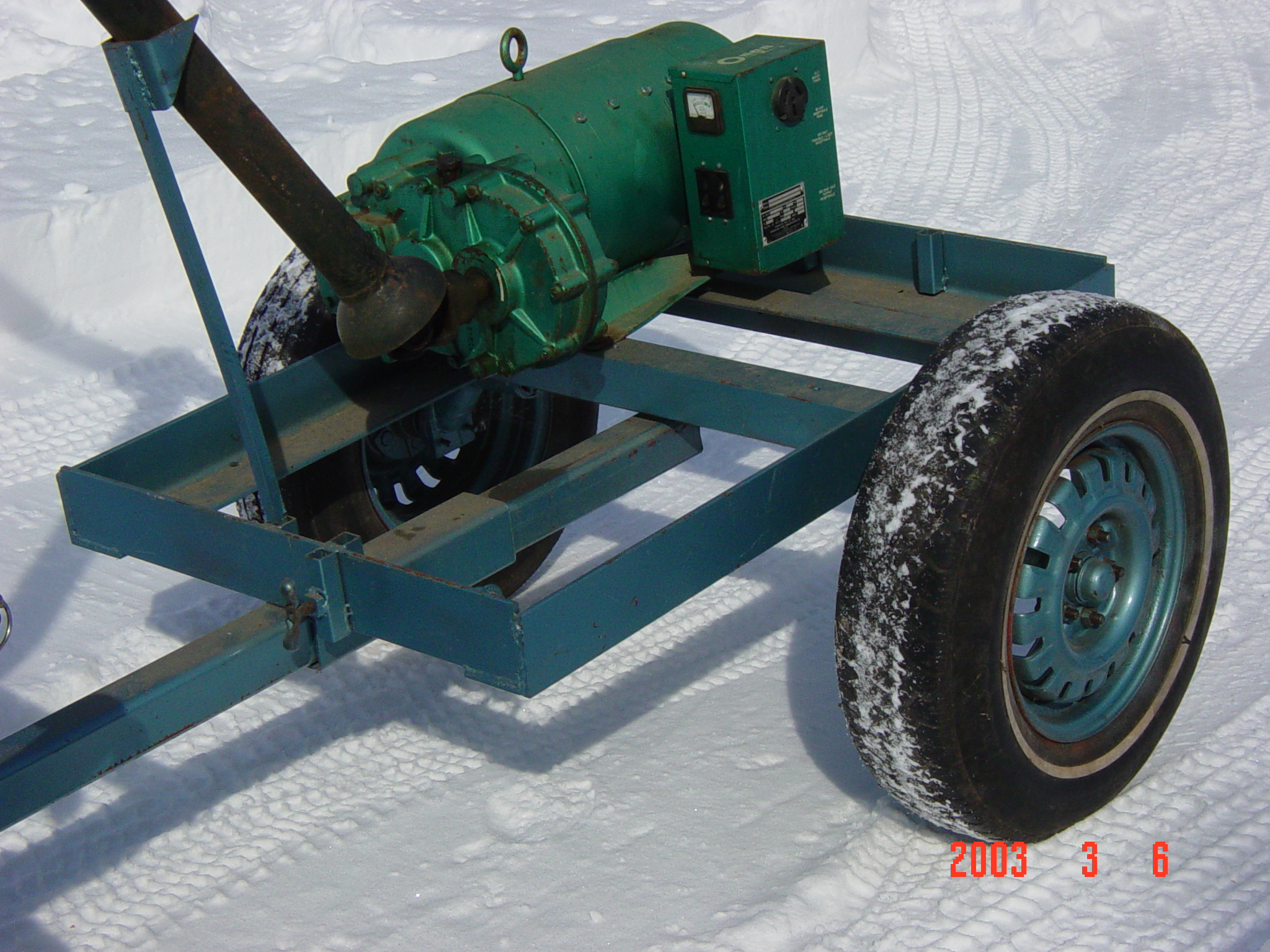

These are the two machines I used twenty years ago. Both pictures taken for selling the equipment. 15KW High Speed rotor Onan. I have an electrically heated house, and I once tried to kill the generator by turning on every load could, and couldn`t. Sorry, I don`t know the numbers. But it is interesting that given that, using a 540-1000 JD gearbox, I could not spin that same genny with no load at all. Must be all about the governor settings.

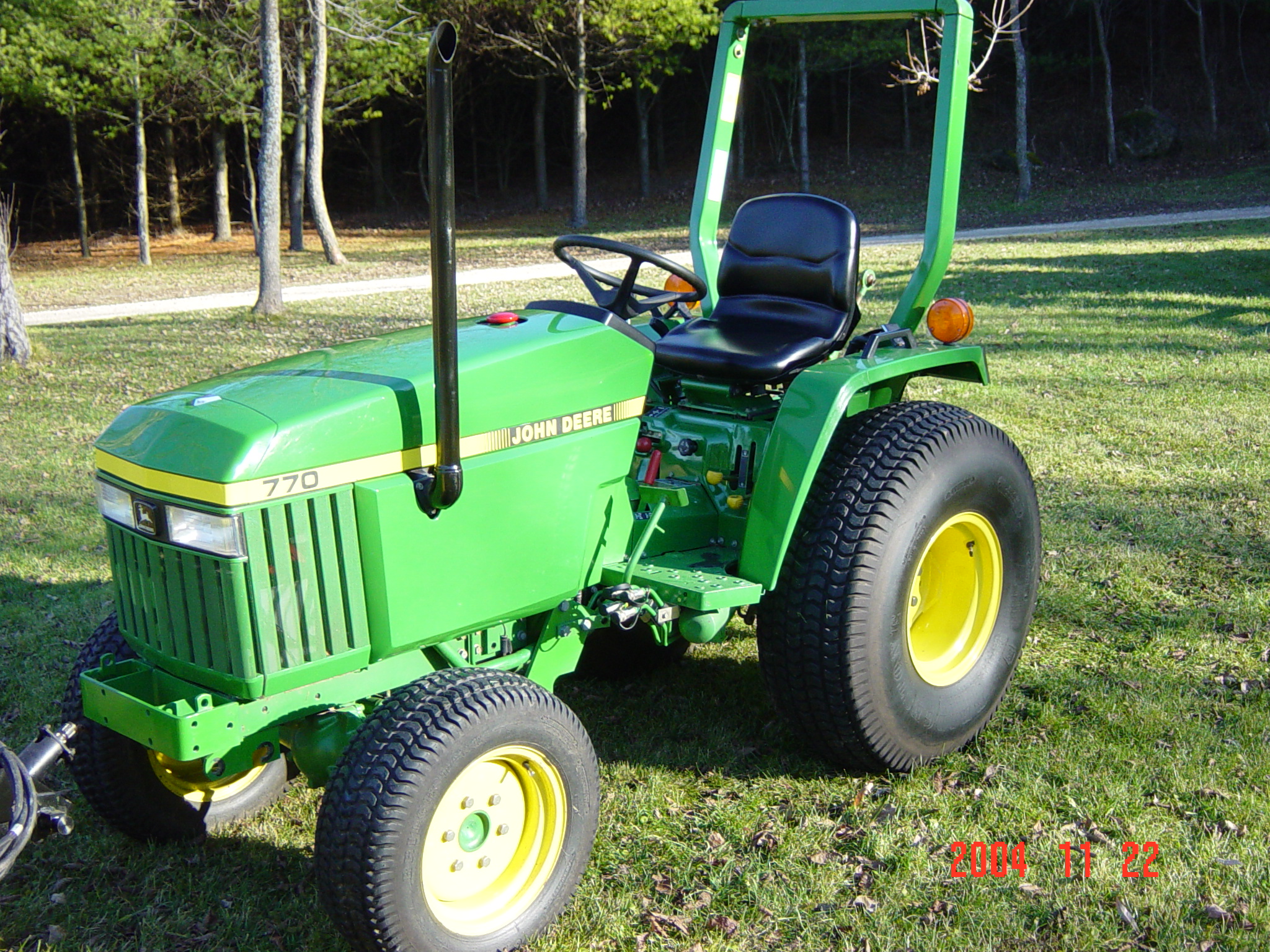

I think PTO sets are great, but a pain. I don't miss using one at all. But at least they are Diesel and you get the superior performance from that for a generator. Also, if I ever did again, I would rig up oil and temp shut down on the tractor. I would never be able to sleep with my tractor running out there at full throttle. And yes, on the JD770, that was the throttle position.
