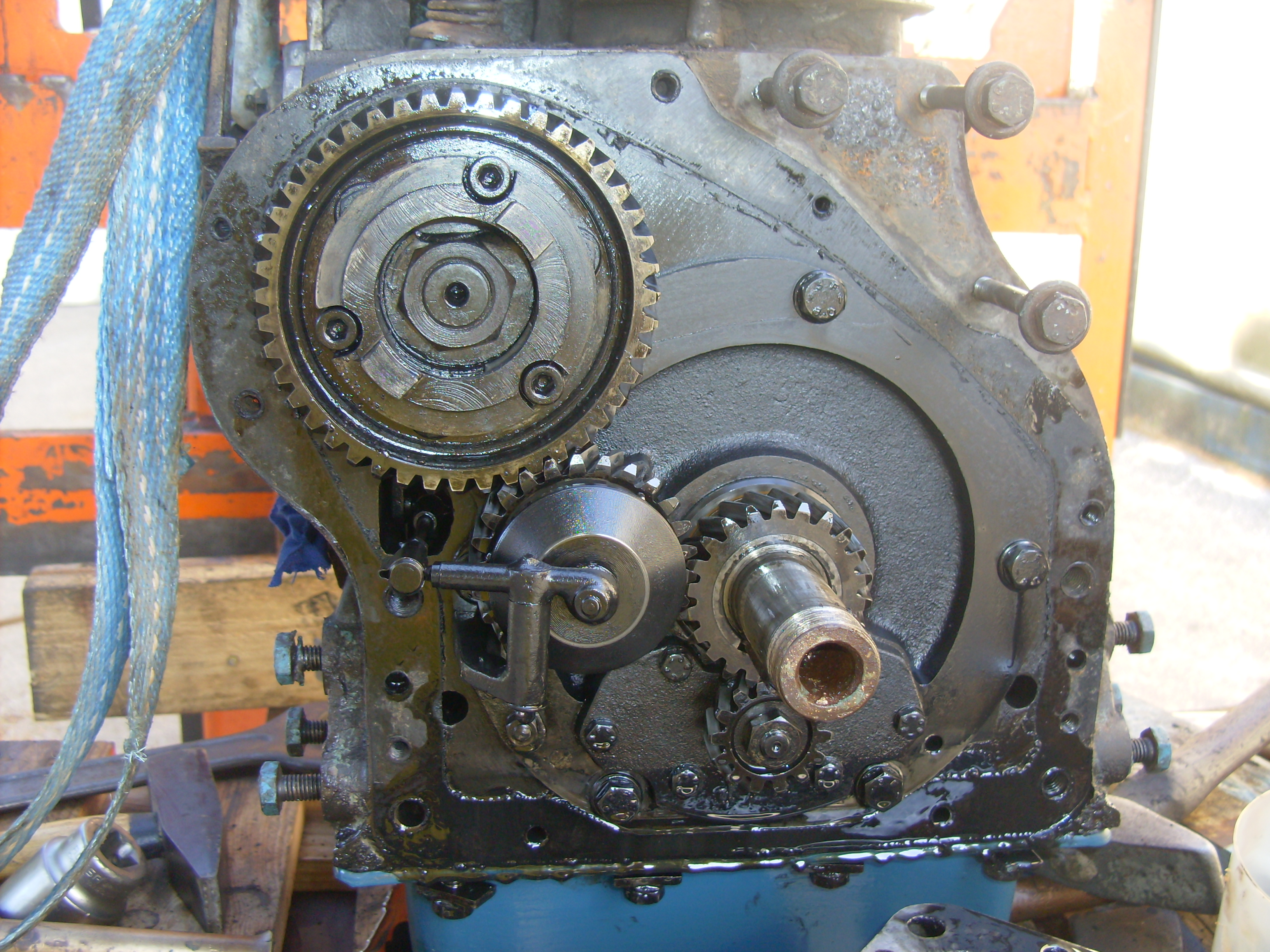

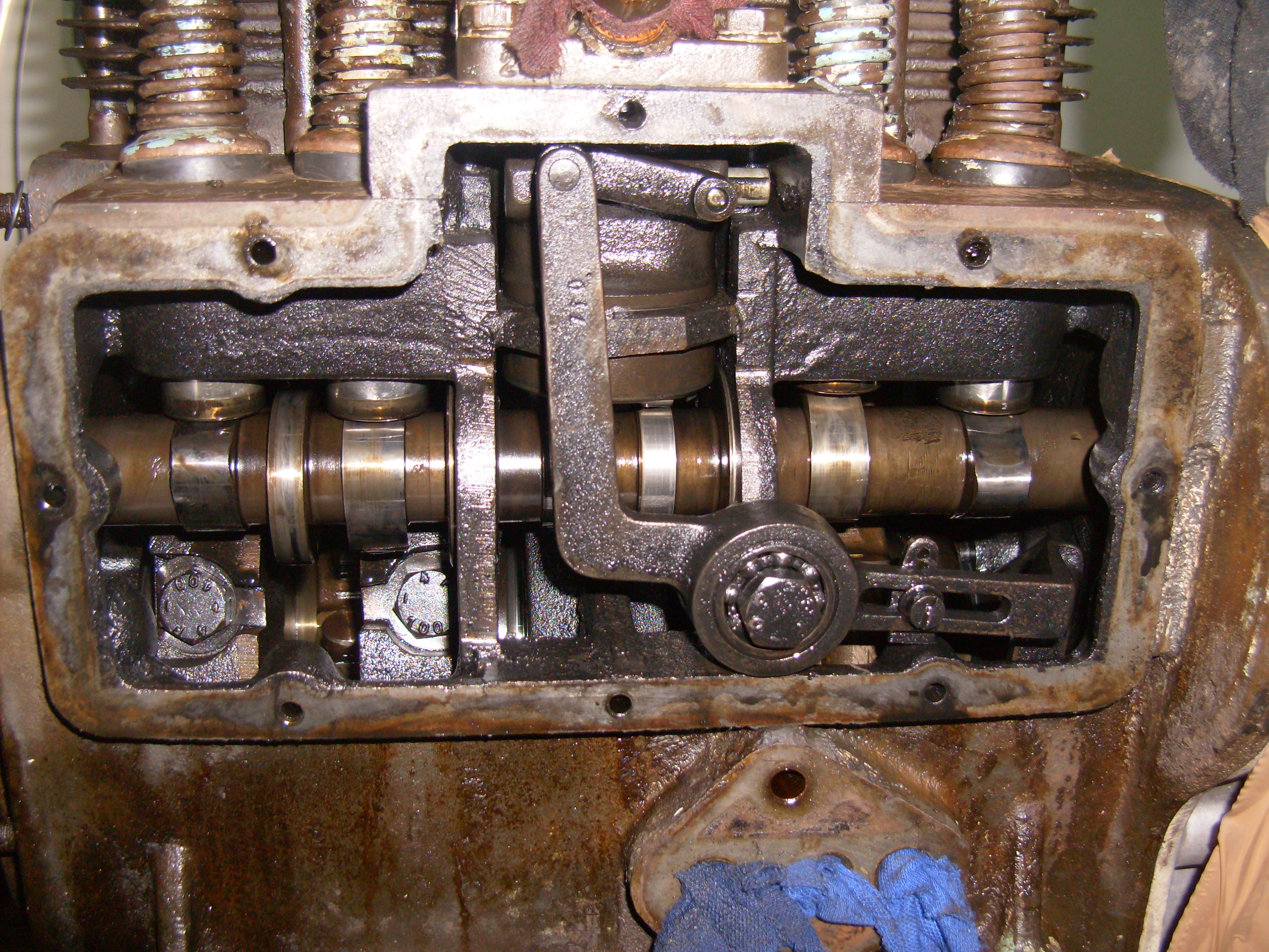

Here is a governor setup on an old 1962 VM 2 cylinder engine. It's pretty much the same as the old steam engines, just built in a slightly different way.
/ PTO Generator Question #22
I know all engines that are rated for a specific RPM have to have a governor or in some cases an RPM limiter. I dont know exactly how a diesel engine governor works but I do know that it puts extra fuel to the engine when it loads up, just note the black exhaust when the engine overloads. Of course the engine is limited as to its response so if the extra fuel isn't enough to overcome the load, then RPMs drop just like any other engine.
