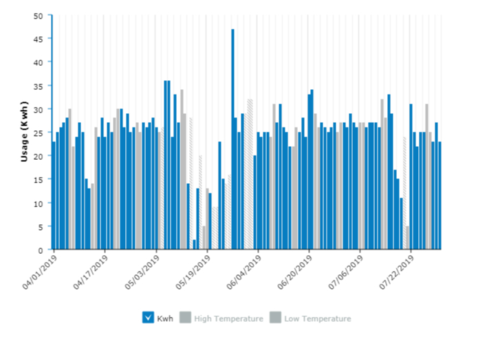

Your post sent me looking at the electric power usage feature our power company offers. I had hoped it offered hourly usage but it doesn't, just daily. So couldn't see directly the effect you describe, but do see some interesting data around the times we were gone on vacation. We are retired, so are in or around the house much of the day. Our heat is propane, and we have no air conditioning, so our usage isn't much effected by temperature, though you would expect the lighting load would increase during the darker days of winter. Here's what I found:
You can clearly see our long weekend away in mid-April, our 12-day vacation in mid-May, and a shorter trip in mid-Jul. The data in May is pretty dirty because of so many estimated days that week, but it's clear we have a base load of about half our normal usage. I'm surprised it is that high. We have two frigs and a freezer, so that's probably most of it. And we had someone in during our week plus trip to feed the cat, so she ran lights and water (pump) some. But that means our "variable" load isn't all that great, on average.

That shows your total energy use on a given day, but what the genny cares about (trips off on) is the power demanded any given second (milli-second actually).
For example, on the largest energy day, it may have been a 10 amp load that ran for 24 hours, whereas on the lowest energy use day you might have a 100 amp load that only ran for 1 hour.
You would need a 100 amp generator.
You really need to add up the loads that will run at any given time to size the genny.
How long they run for determines the fuel use ($) and generates the graph. :2cents:
Of course. Do you think I'm stupid?
I said it didn't display what you were describing, but I found it interesting that we apparently have a base load when no one is home equal to half our normal daily usage. That says we have some decent sized loads that run automatically all day. So if I were sizing a generator I'd want to identify those loads and consider the possibility they would all want to run at once. Maybe even start at the same time.
