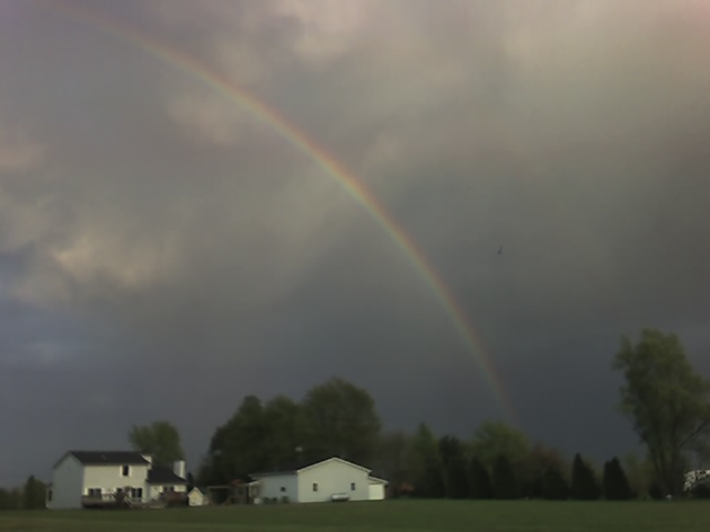

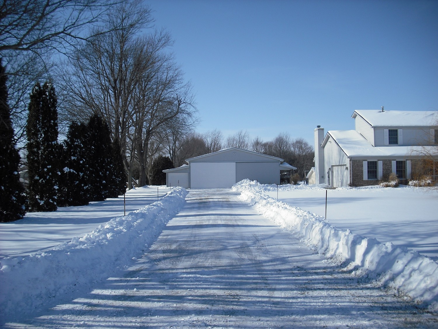

That must be one heck of a house. I also have a programmable thermostat and mine does just as yours and drops to 62 at 10 pm and back up to 68 at 6 am. I would say right now my furnace is running once per hour for maybe 10 minutes. My house is very tight and can barley hear the genny when on the other side of the wall from it which is on the far south end of the home. My bedroom plus the kids bedrooms are on the far north side with only the guest room on the south side. I would say you could hear it in the guest room and office but would never hear it in the master or kids rooms.
My genny has a good muffler that is nearly the size of a shoe box and is chrome. Not sure about it but is much quieter than say a riding mower with with the same HP engine.
The genny pad is next to the chimney which is the south end. The bedrooms with the exception of the office and guest room are on the north end and all on the second level.
Chris
