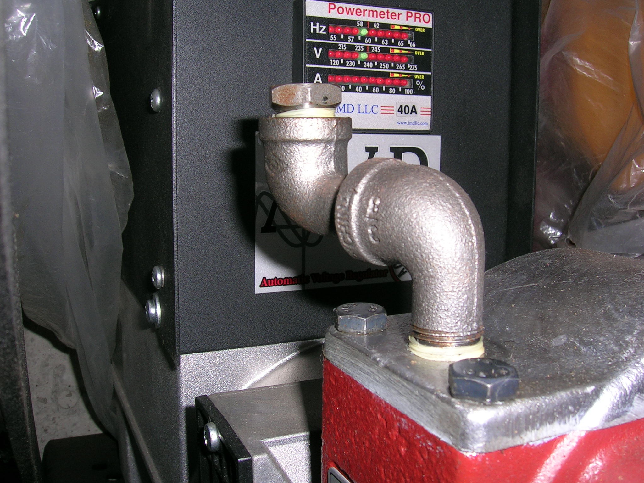

I should mention I had to make a minor change to the gearbox. The fill plug is vented with a small hole. When operating the unit gear oil would be flung under the fill plug and make its way out the vent hole. Not a lot but enough to make a mess. My solution was to install two street elbows. Worked perfect. No more oil out the vent hole and I can remove to fill without tools.

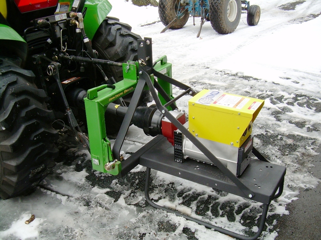

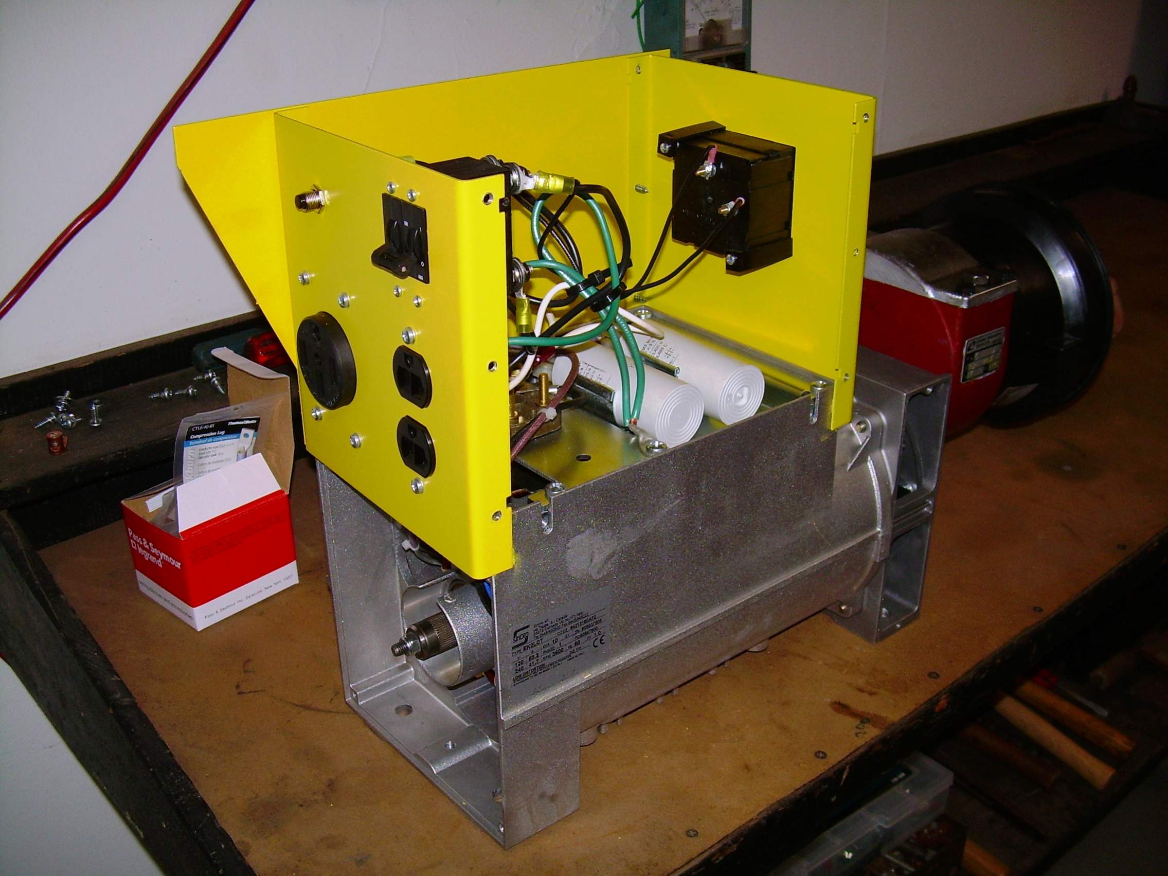

Thanks for the review, I've got an IMD 10 kw as well but have not had the misfortune of needing it. I thought for sure with Irene I would need it, but even though over half the state lost power, mine just blinked once.
I did do some testing with it and found it required some manual adjustment from no load to full load. But I got the capacitor regulated model, not the AVR. I thought the capacitor model would be less complicated and maybe be easier to maintain and last longer. Now I think I should of just got the AVR.
On the higher capacity models, they only come AVR. And yes the people at IMD are very helpful, I bothered them with many long conversations and questions, they were very patient with me.
Their optional 3pt carrier is great too, used with a 3pt QH, makes it very simple and fast to mount it and move it.

Thanks for the pics. Mine is very similar except it's black instead of yellow. In place if your two large caps is a small (2"x3") potted board with two trim pots and a handful of electrical bits. Hopefully being resin potted the avr board will be fairly durable. They look simple to replace and Shane did say he would send out another if I ever needed it.

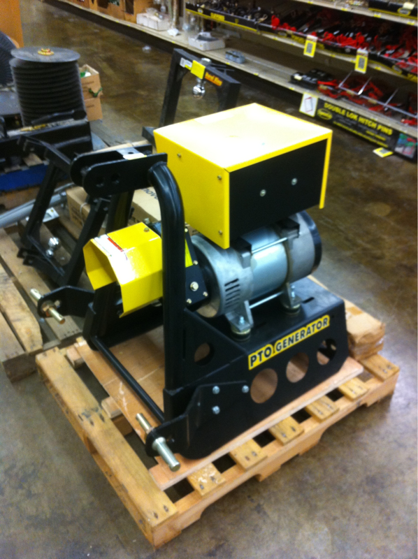

I saw this little baby at rural king recently. They were asking $1099 I think for it. It's a 15kw. Said it required about 25 PTO/HP I think. I figured the GC would probably handle it fine. It on my wish list. I too figured utilizing my tractor engine would be far more efficient than yet another engine to keep running. I have a 5kw stand alone unit that has barely been used. It won't maintain rpm for nothing. I will only use it to run the block heater on my bigger stuff since I park them well away from line power.

Theoretically it takes about 2HP per KW, so about 30 pto hp to get 15kw.
But you could run it with less hp, just wont get the full 15 kw output.
That looks nice set up on the 3pt carrier.

That's the one that I bought this past spring. It figures that ever since, we haven't lost power long enough to use it!
