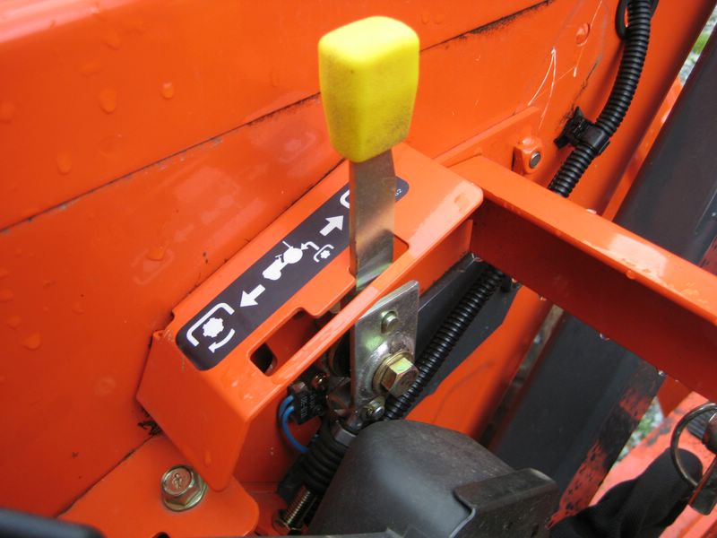

my 3400 had this exact problem. when disengaging the PTO it would not shut down, I had to wiggle the lever fwd/back a couple times and it would shut down. The dealer explained the the boot that covers the cable at the transmission end had failed and the cable rusted which led to the sticking problem. He also told me that lever housing was updated so the angle was not as steep. He replaced both and I have not had any problems since.
Here are a couple pictures of the new setup:

Good pictures, bigballer. I didn't realize that the PTO lever is different on the HST and gear models. This sounds like it might be an HST issue only? I'll go take a look at my gear tractor to see how the cable is routed to the transmission. The lever is between your legs down low near the deck.
/ PTO cable L2800/3400 #6
Those are great photos, it show what I need... ...I need to write to customer service and see if I can get that mailed to me. :rolleyes: If I had the part, I could have this done before the time it takes to get to the dealer. ;)
