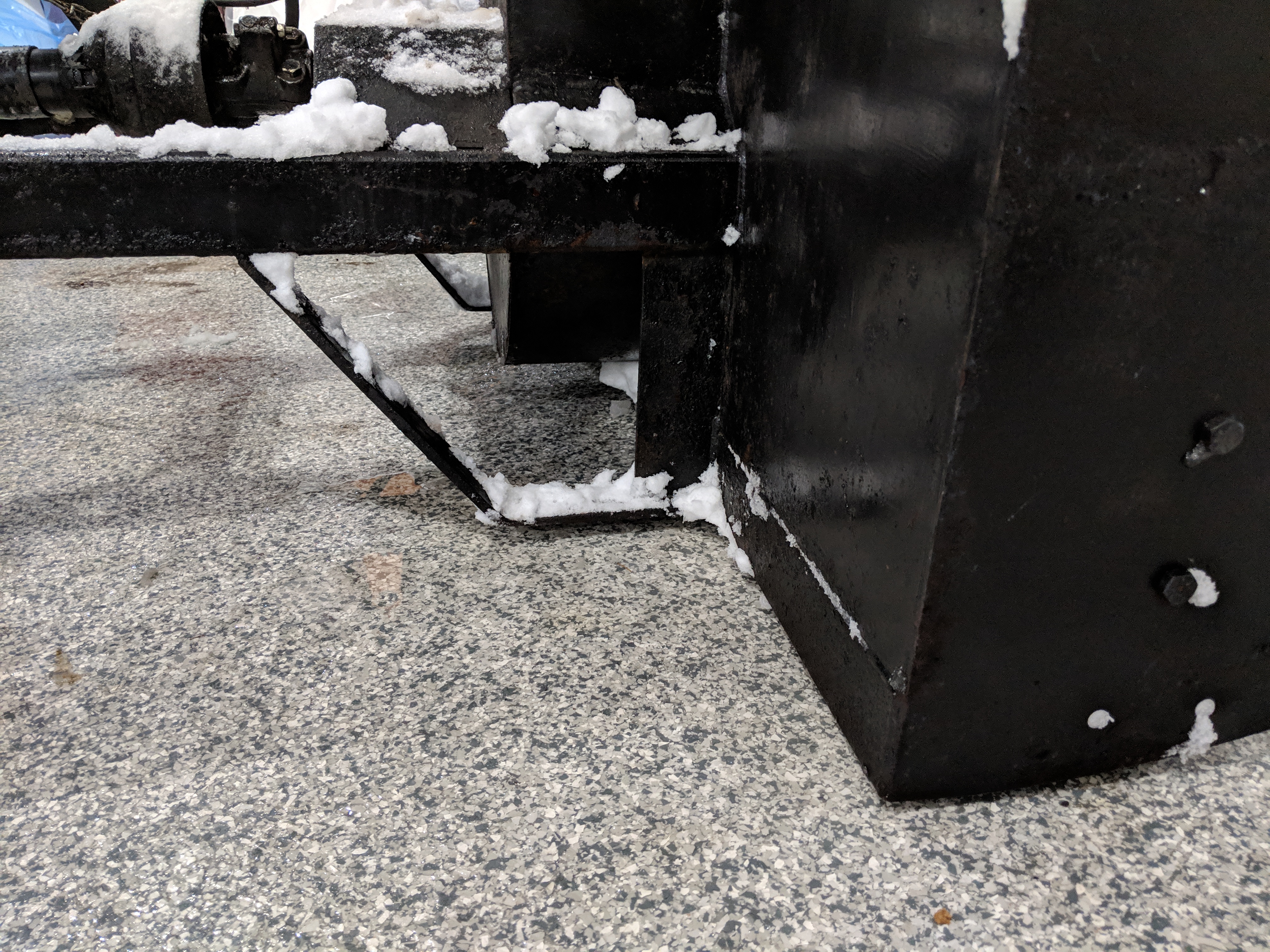

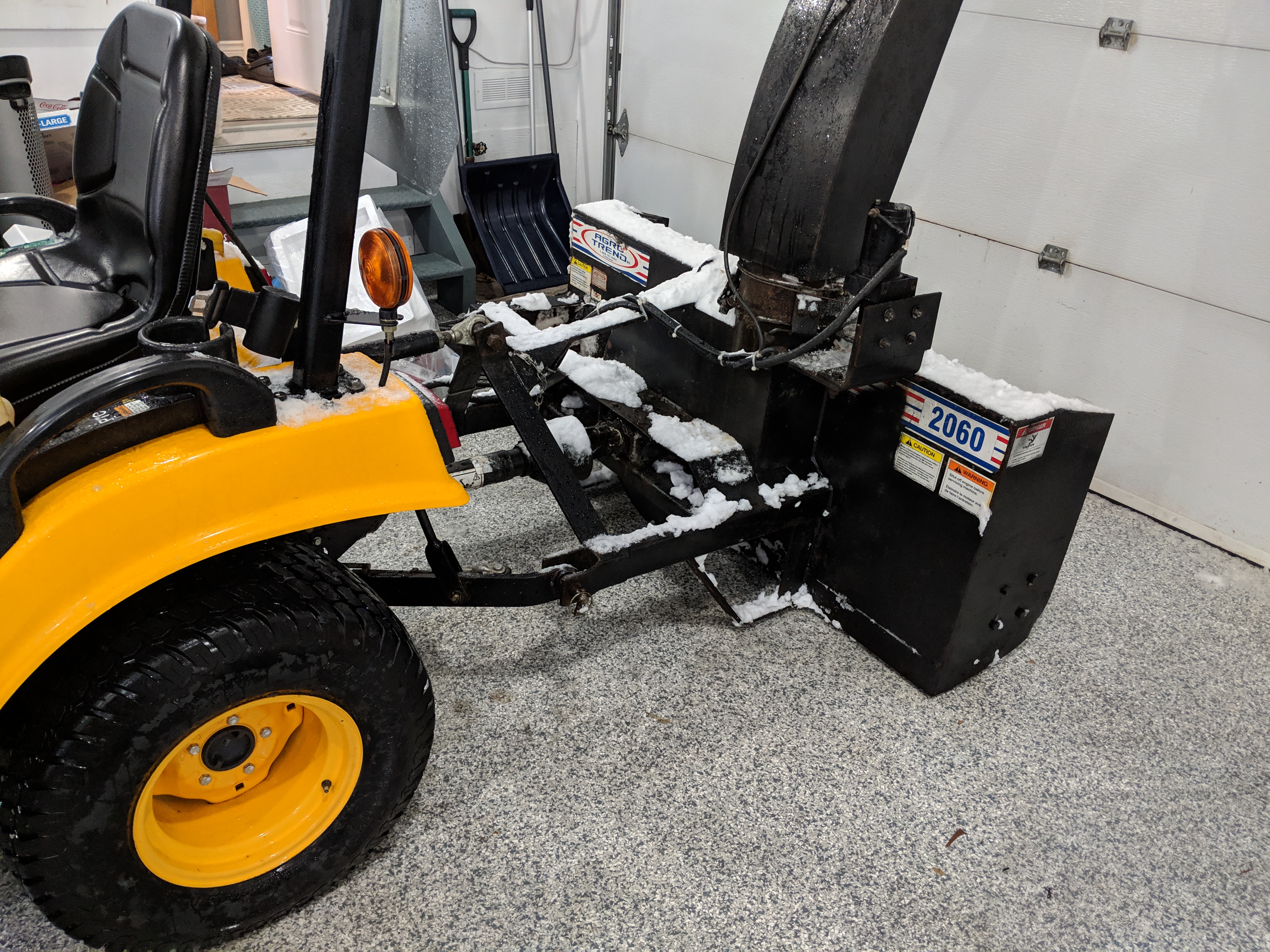

I'll try to keep it brief, but I have a few questions that I need answers to! Thanks.
My 2009 Cub Cadet sc2400 came to me used with a 60" "Agro Trend" PTO blower. I always set the 3PH to the float position, but IMMEDIATELY upon contact with snow it just rides right up on top of the snow, and within a few feet I am driving on top of 3,4 or 5 inches of (now-compacted) snow.
I've played with the 3PH angle adjustments to no avail.
My theory is that the skids on the back of the blower are preventing the 3PH angle adjustment from actually putting the blower into a position where it will cut. The feet are too big and affect the angle of the blower too much.
Note: in the photos I intentionally have the blower slightly off the ground.
So on to my questions in no particular order:
1. Is that blower just too big, too much for my tractor?
2. Should I cut off those sleds/feet on the back of the blower, and would that fix my problem?
3. Should I cut my losses and move to a completely different setup? (ie. front mount blower, or different rear blower)
Thanks!

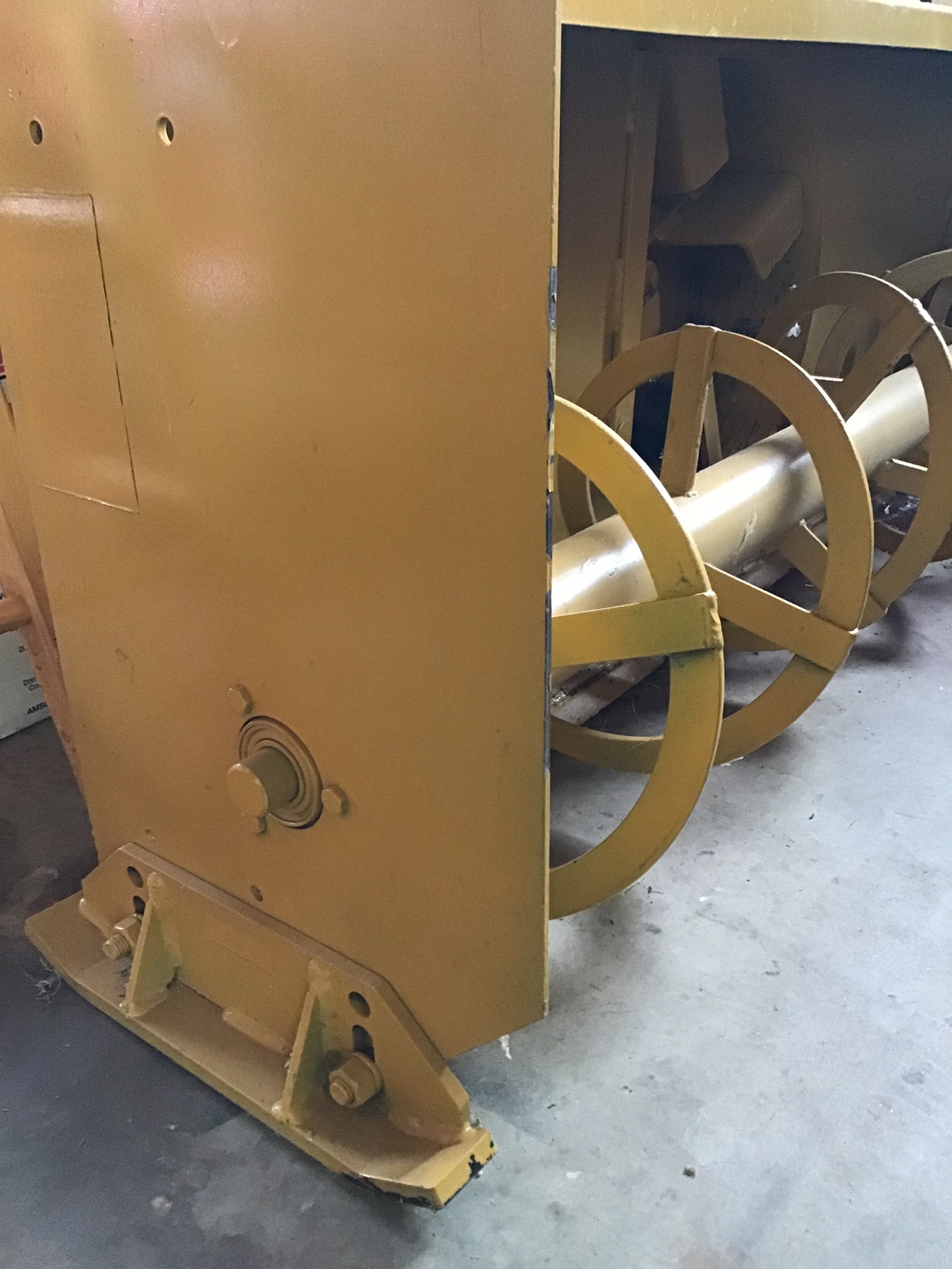

If your blower is built the same as my 48" Agrotrend, there are no shoes, the brackets(skids) are part of the frame and ride the same height as the bottom of the blower. The 60" is oversized, but used at slower speeds, or smaller bites will be ok. Your going to have an issue with traction on the front tires for steering, unless you have a loader/front weights. Do not place in float, keep the 3pt lever pushed down, in float it will rise and not return to driveway level. It will keep rising as you move along. There is no down pressure on the 3pt, all gravity. Adjusting the angle of the blower can help. You want the blower to be facing level/slightly down. On gravel , too much angle starts spitting a lot of stones.
/ PTO Blower making my life miserable!
You are correct, mine has skids and no shoes. I do have the front loader and I seem to be able to turn and use 4x4 fine with the blower. When you say "pushed down" do you mean leave it as low as possible, just before the float position?

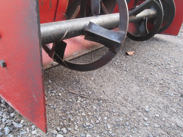

I can’t tell from the picture if your blower has a cutting edge, but my blower without a beveled cutting edge would also ride up on snow. I used it this way for a few years riding on the housing steel, then got tired of it and had a nice edge welded on. It now doesn’t ride up, and works much better.

The Agro Trend blowers are economy models. No adjustable shoes, ride on the flat bottom of the blower and skids that are part of the frame.Any upward angle will raise the blower. I found it best to angle the blower slightly with the top link.

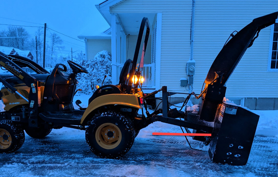

Ok, update after trying to wrestle with it some more.
Added a bunch of photos
- blower in upper position and when it first hits the driveway
- handle positions for each of those two photos
- driveway photo evidence of how it floats
- hole i dug with my boot to show how badly it floats
- close-up pic - there is no cutting blade, it's more like a horizontal strip of metal that runs parallel to the ground
- garage pic - the 3PH vs PTO angles look pretty bad to me, are they not? The PTO doesn't sound very good if I have it turned on while in the upper position.
Also: Added (as safely as I could) a 200lb person standing over the skids and it had no affect whatsoever.

It looks like your blower is tilted way from the tractor too far. The big supports going back to the blower should be almost parallel to the ground. You should be able to drop the 3PH arms down more. That will require shortening your top link a bit. I can't quite tell if you already have the top-link screwed all the way in or not. Tilting it more towards the tractor and getting the arms level will increase the attach angle of the cutting blade along the bottom.
/ PTO Blower making my life miserable! #17
Loosen the adjustable stop for the 3 pt level so you can push the lever down to position 1. At position3-4 you may still be crying the blower on the 3 pt arms so as the snow gets left behind tractor tires rise, blower gets higher, etc.
Looks like you have the top link way to long but fully understand that this was an attempt to get the blower to cut
Heavy wet snow snow or driving too fast can also cause the blower to climb due to the augers lifting the blower slightly. Probably not a concern with this size blower on your tractor.
Patience and you will get this figured out.
/ PTO Blower making my life miserable! #18
Angle is too aggressive, start with the blower flat on the skids and make small adjustments with the top link from there.
The numbers beside the lever looks like a height setting for a mid mount mower. The lever should go all the way forward to the end to full lower the 3pt.
There may be enough play in the lever to shift it past the stop, without loosening the knob at the "3" setting..
