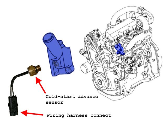

Check to see if someone has disconnected the thermistor at the thermostat housing or loosened the connection at the pump. They control the cold start advance on the pump. These often fail and cause the fuse to blow that powers the shut off solenoid, causing a no start situation, so the simple solution is to disconnect them.

I second Tractorboy88 suggestion. I have included a picture thermostat
Jd5210 posted a picture of the advance sensor . Is that what your referring to ? If the fuse blew where would that fuse be ? I saw the fuse block for the tractor but do not remember a advance sensor fuse.

If the fuel shut-off solenoid fuse was bad it would not start at all. What is being suggested is to check if the temperature switch part # is RE503242 is plugged in, this is part of the cold start advance. I have attached a write up on how the cold start advance works.
To comply with the exhaust emissions regulation, the timing of injection pump should be around 6 to 9 degrees before TDC. These timing values do not allow proper start-up operations when engine is cold. To ease engine start-up, a cold advance system gives to the injection pump a temporary over-timing.
When coolant temperature is below 50 C (122 F), the solenoid valve is activated and opens the cold advance circuit.

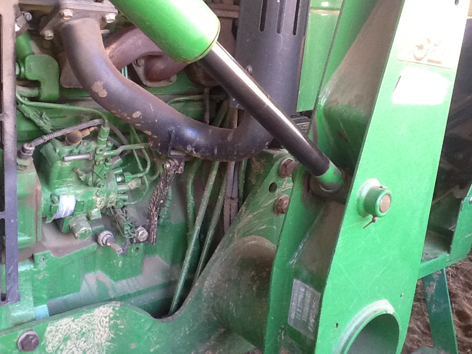

This is a picture I took the other day not knowing we needed to see this part. I'll get better pictures when I go back.

Kpack , I believe that's the sensor connector right behind the injection pump in that picture, but the picture doesn't show the thermostat housing very well.

The thermostat sensor is on the same circuit the fuel shut-off solenoid is on.
Take a look at the pictures I posted in thread#5 and you will see where the thermostat is located, along with what it looks like.
In the timing advance pdf thread #12 in the picture of fuel injection pump the connector labeled B is where the thermostat plugs in.
Hope this pulls it all together. Again if the fuse is blown it will NOT start as the fuel shut-off solenoid is closed.

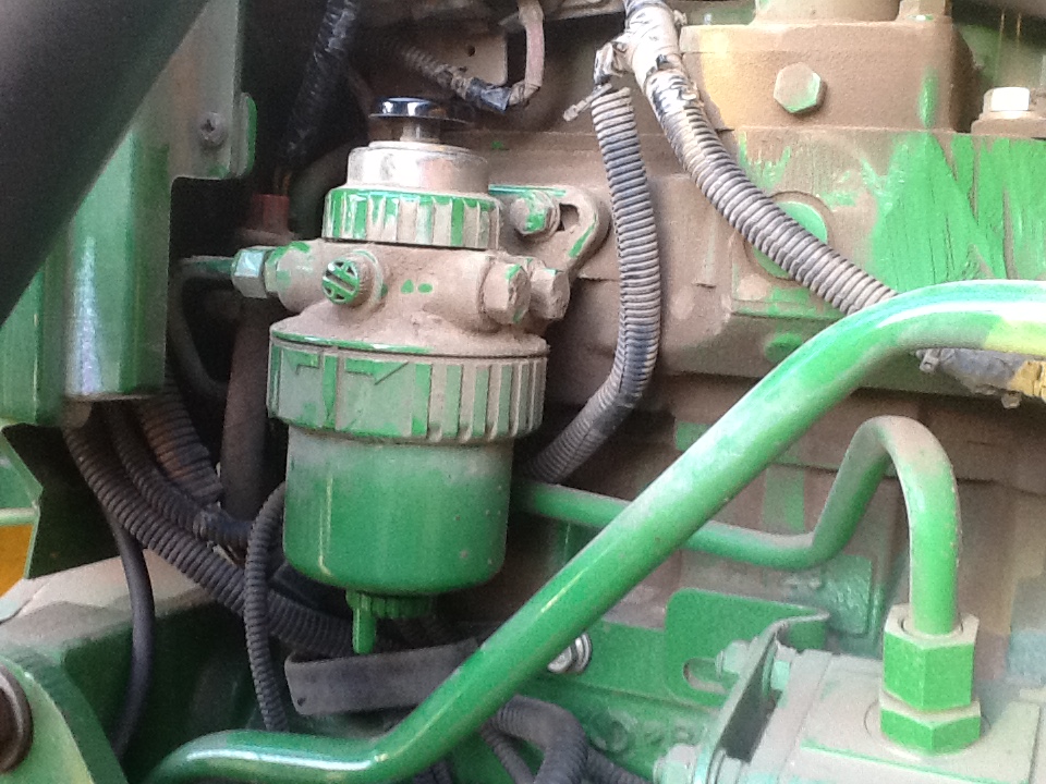

.i went to turn screw on the bottom of fuel filter to drain any water . I barely cracked it with it running a soon as it started dripping it died. It's low on the fuel gauge but she says it has fuel. I've bleed the fuel filer and pump for air as manual says and have plenty of fuel coming out. Now I can't find in the manual about cracking injector lines at the block like I do my tractor. :eek: no fun right now I'm going after a can of diesel.
It says something in the manual about the pump prime button on top of the fuel filter the black round button there. image.jpegimage.jpegneeds to be left down but I don't see how I could lock down.
