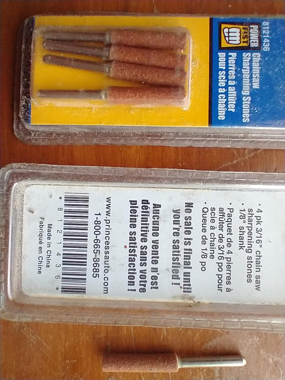

Oregon makes a dremel style chain grinder that comes with different size stones. Once you try it you'll be hooked. It sharpens the chain in one third the time and does a great job. It runs off 12V so you can sharpen at your work bench with an old battery charger or anywhere in the field with your tractor/car battery.
I bought a similar unit a while back, mine ran on 110V, not battery. I think I was halfway thru when the grinding stone broke. It only came with one of each size, so I finished it off with my old clamp on sharpening guide.
Any suggestions for bits for the dremel-style sharpeners that stand up a little better? Reviews were all over the place on any I looked at on Amazon.

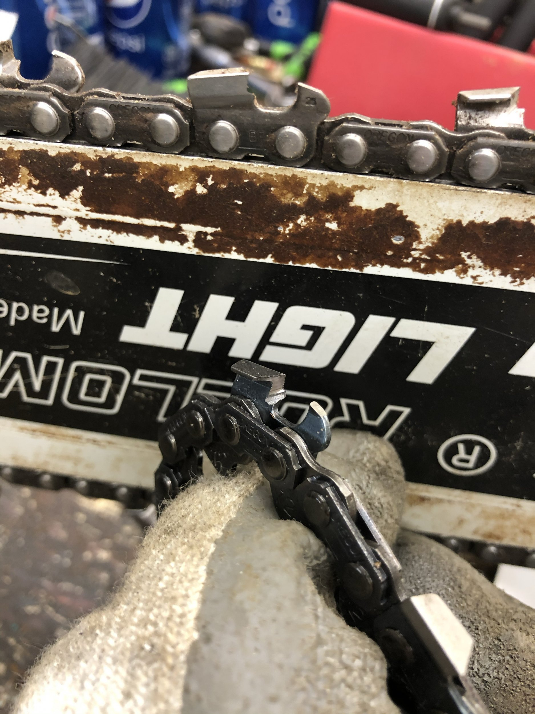

New factory chain tends to have a gullet burr left over from the factory grind. That burr will snag a file on the first sharpening resulting in file chatter.

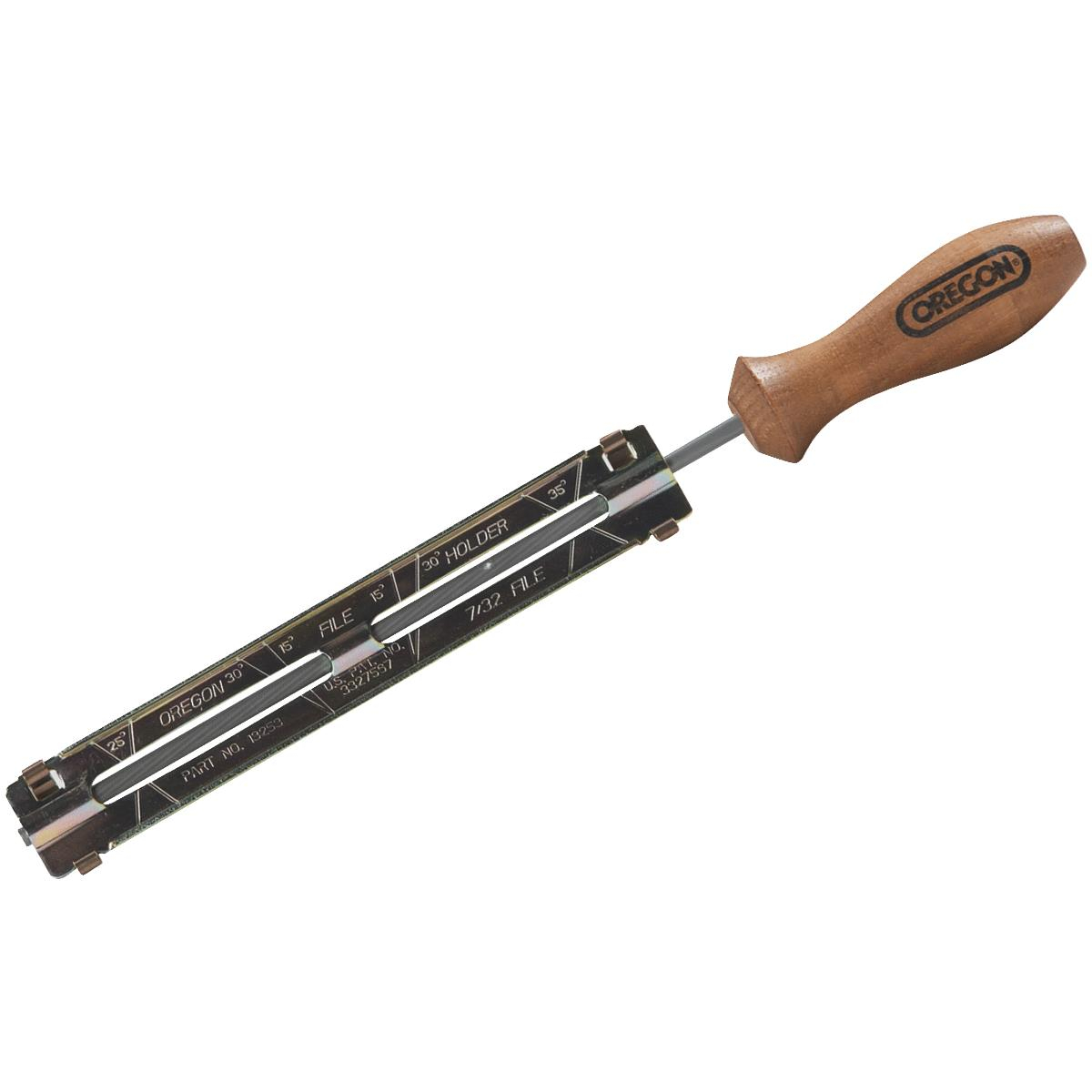

I use this type of file guide for hand sharpening my chains although mine is Stihl brand. I don’t really want to buy a new system as this normally works fine.
The problem is on a new chain something on the guide hangs up and doesn’t allow me to sharpen the chain with the guide install. Not a big deal I just remove the guide. After I have run a few tanks of fuel on a new chain and sharpened it a few times I can reinstall the guide. What is happening with the guide catching on a new chain? I can’t really see what is hanging up. This is one of those questions I’m more curious of what’s going on than really needing to know.
Just not a good guide.. a "wannabe" guide.
This has proven to me to be the best guide for me.
I believe that "burr" you speak of is really the profile of the stone used in the factory that is not round like the file you use. The first filing needs to make that round profile so the file fits. After that first sharpening, the chain will cut better and the filing will be easier.
   / Problem sharpening a new chain #34
@beenthere Could also be the fact the even though 3/8 LP uses a 5/32 file and .325 uses a 3/16 file they are both sharpened with a 1/8 grinding wheel. and the large 3/8 and .404 uses a 7/32 file but sharpened with a 3/16 grinding wheel. Which would set up a smaller contour than the respective file.

Hi Oaktree,
I also had trouble finding good grindstones for the Oregon sharpener. The 3 stones Oregon supplied with their sharpener (3 sizes) worked great, but the Oregon stones purchased later turned shiny on first use because they had no grit, but they would never break. They were too hard.
Then I found great gritty stones at Princess Auto here in Canada and bought a lifetime supply. Unfortunately, they stopped selling them because the gritty texture resulted in a weaker stone that would break when not gently applied. It helps to use the outer tip more on a new stone so the inner section of the stone has full strength. A proper gritty stone should sharpen a chain ~60 times.
A rule of thumb is to cut a cord of wood and saw it into 16" firewood- then sharpen. If nothing damaged the chain, about 3-5 quick strokes on each tooth will bring back sharpness. Sharpening both sides of the chain from the right side of the bar (the Dremel turns clockwise) causes a small burr to form that can be felt with the fingernail or seen with young eyes. Then it's crispy sharp and ready for the woods again. It takes about 4 minutes to bring a chain (on a 16" bar) back to the state where sawing wood is fun.
Sorry I can't offer a present source of gritty stones for a Dremel but surely someone offers them? A good stone needs to be gritty but fairly strong. That's a difficult thing to search out with Google. Perhaps your local chainsaw repair shop has a source for good stones. A good stone should scrape the fingernail similar to a good nail file. I attach a photo of the discontinued good stones from Princess Auto that might help. Princess Auto does sell a similar "looking" stone on their website today. It might be worth a try. Search "princess auto chainsaw sharpening stones".
Thanks for the info. I picked up a 3-pack of similar-looking stones last week at HD, we'll see how they work out next time I need to sharpen. Good idea on using the tip first so if it does break/wear you'll still have some stone left.
I'm sure I need to work on my technique with the dremel too, always used a file before.

Very late to reply but. I have one of the guides that clamps on the bar and sets all the angles. Most common setting is 35* across and 10 degrees up. At that setting the first and sometimes second filing will hang up on the raker. I decrease the across angle a few degrees and just use that the life of the chain.
