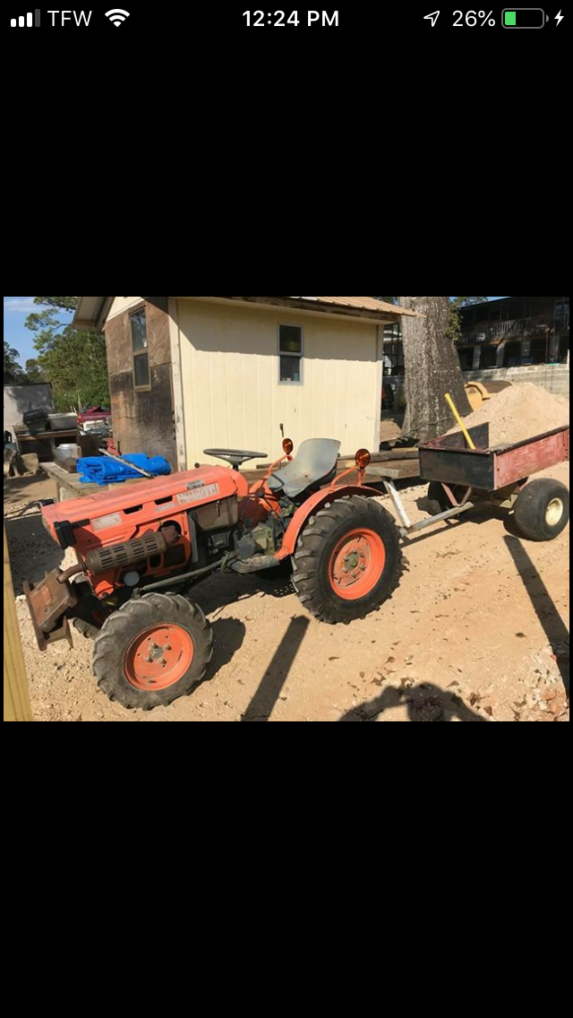

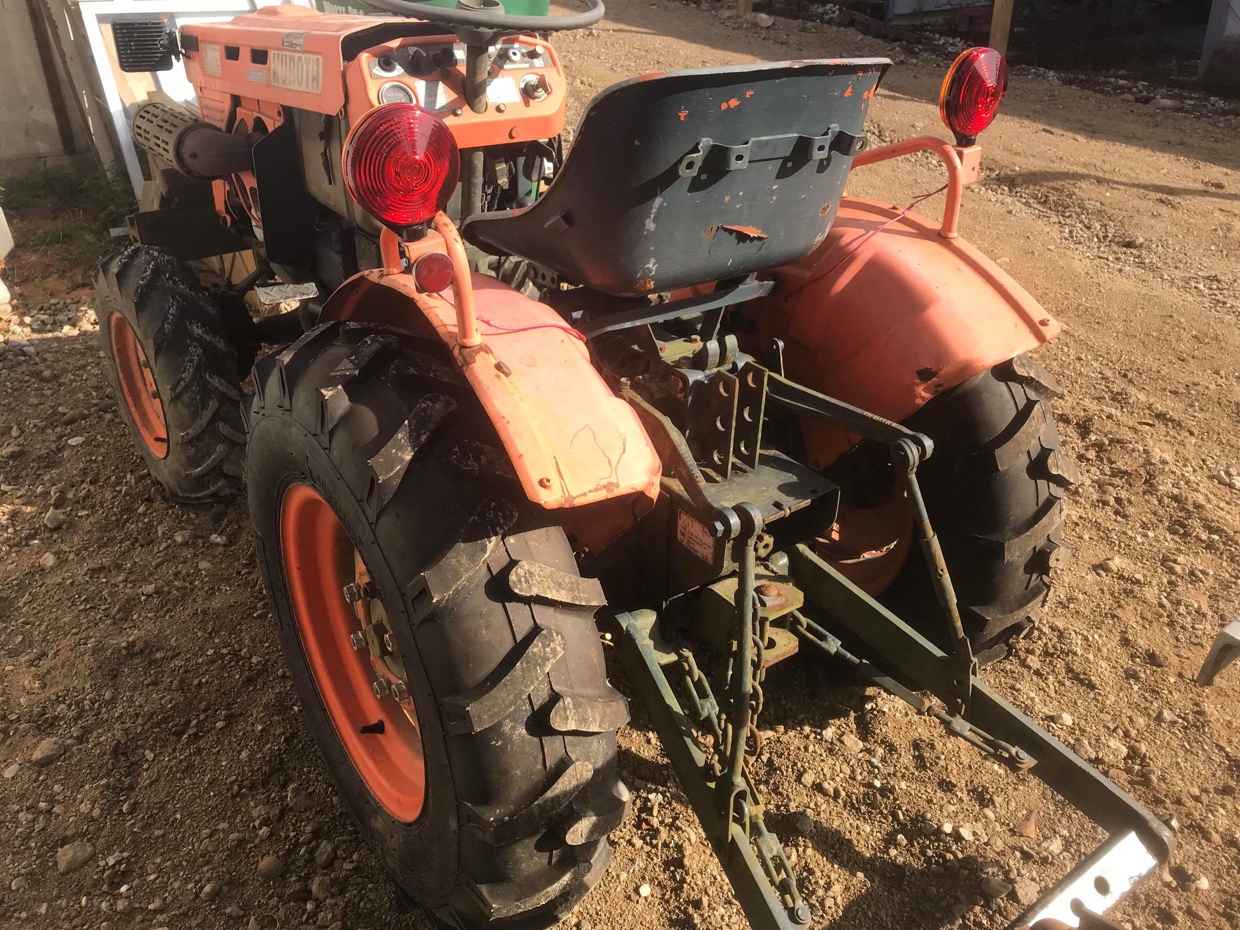

I Am thinking about getting this B6100 4x4 that I found. What is a reasonable price. I know that depends on a lot. Im going to look at it tomorrow. As far as I have been told. Everything works, motor runs good and doesn稚 smoke, 1600hrs, new tires and battery. They had it listed at $4000 and keep dropping the price. There asking $3000 now. That includes the little trailer. I offered $2200 without the trailer. Any thoughts

It looks like the tires are new which is a plus. Around here a 4x4 unit with a FEL is in the 5k range. $2200 seems pretty good if it runs well.

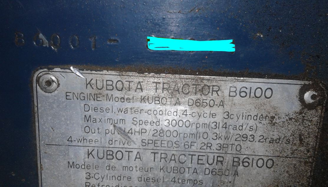

Chris, you PM'd me the question below and I am answering so it may help someone in the future. My tractor also has the B6001 stamp, you can see it in the picture. My tractor was bought from a Kubota dealer so it's not a gray market one. You should be fine with the tractor above assuming the metal plate says B6100.
I assume the second number is serial number derived so I blued it out.
"I just happened to hear about this "gray market" thing. I went to look at the tractor and passed cause of the serial numbers stamped in the tractor above the aluminum spec plate. It said B6001-23068. Since I saw the B6001 on Kubotas no no list I passed. although the aluminum spec plate said it was a B6100."
