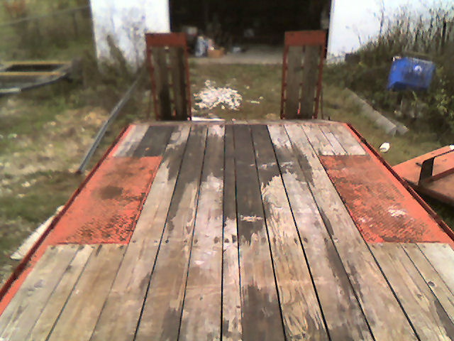

What is the better way without replacing them, they are pretty descent and it has some oil stains on parts of them and I was thinking about using a paint roller with some used motor oil to re coat them and pressure wash the biggest part off after it soaks in pretty good and did I mention Thompson water seal is a 2 month fix and a joke, I've used it before with not so good results
The trailer is a 1999 trailer and I live in Florida
Thanks
Jim
here are some pictures of it with oil stains

My always first and evident suggestion is to keep a trailer out of the weather and UV.
I commend you on your observations with Thompson's Products < SPIT >. I will never waste not one more copper cent on any Thompson's Product < SPIT >.
I'd pressure wash it, coat it with an epoxy or enamel / stain and enjoy the trailer.
In my opinion, motor oil, etc... will do nothing but make a mess. Once it gets on your shoes, etc, it goes everywhere else.

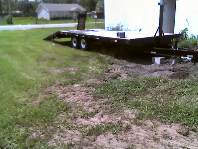

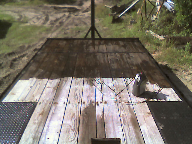

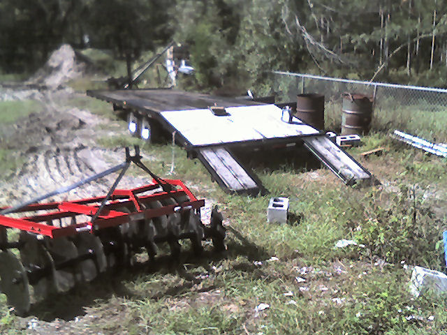

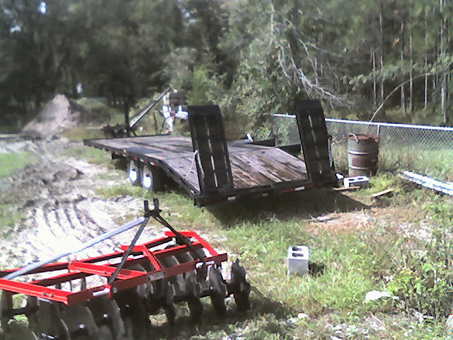

Sorry about the time lag but here are some pictures of what I did and how it turned out. I am very pleased with the results
Thanks
Jim

Looks good. Bet it will last a long time too. Wonder if after it sits in 100 deg. weather if it will smell? That might be a good thing, might keep the dogs from trying to mark it as theirs when they come by.
