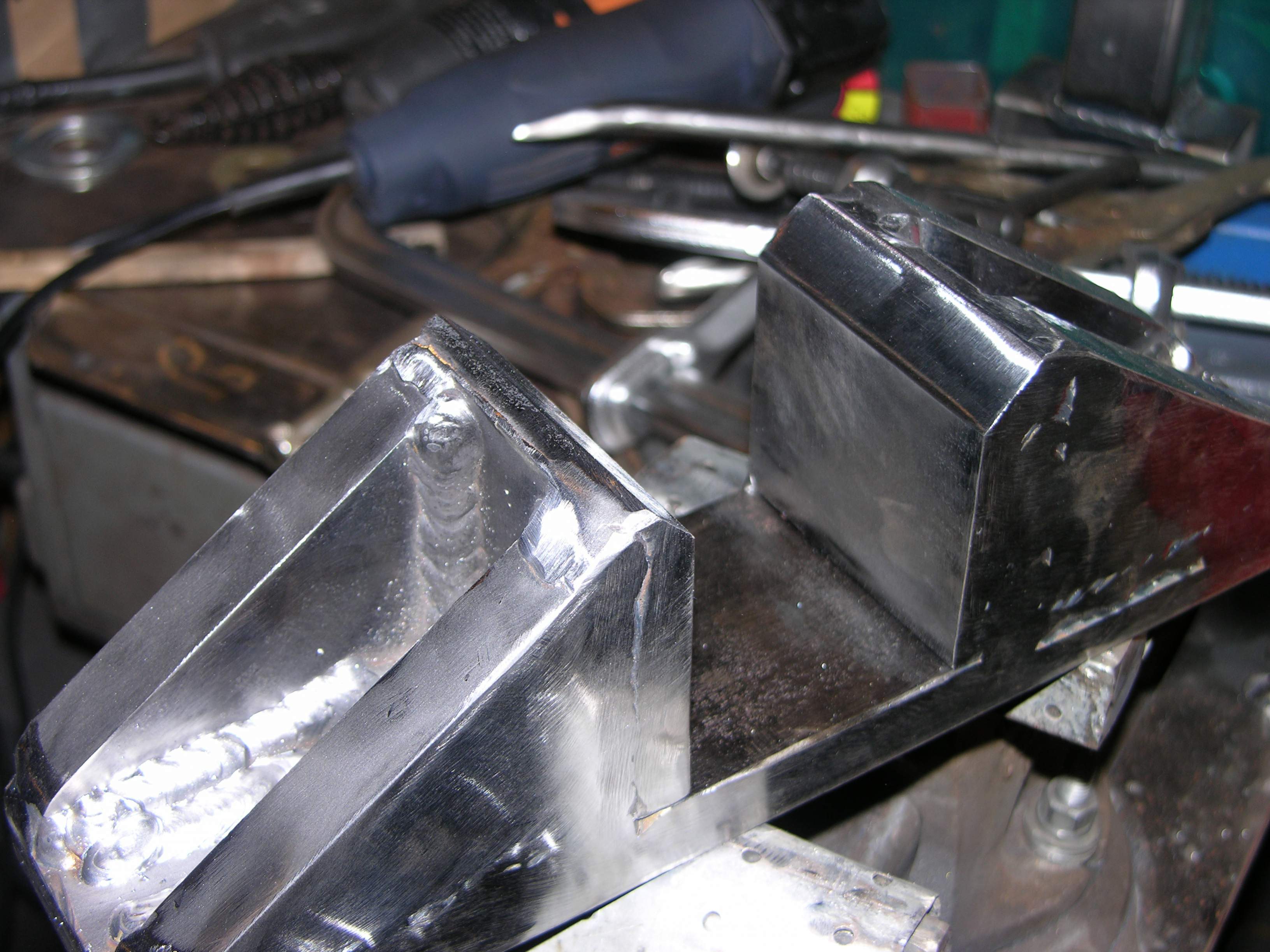

I beveled the inside tops @ 45 degrees, used the bigger table that came with the Jet saw and clamped a cheap plastic "miter guide" from Rockler to the base of the jig, it has a bar that's supposed to fit the miter slot on a table saw - held that bar against the edge of the bandsaw table firmly and pushed the jig into it. Not perfect, but it worked better than trying to keep both sides equal with a side grinder :rolleyes:

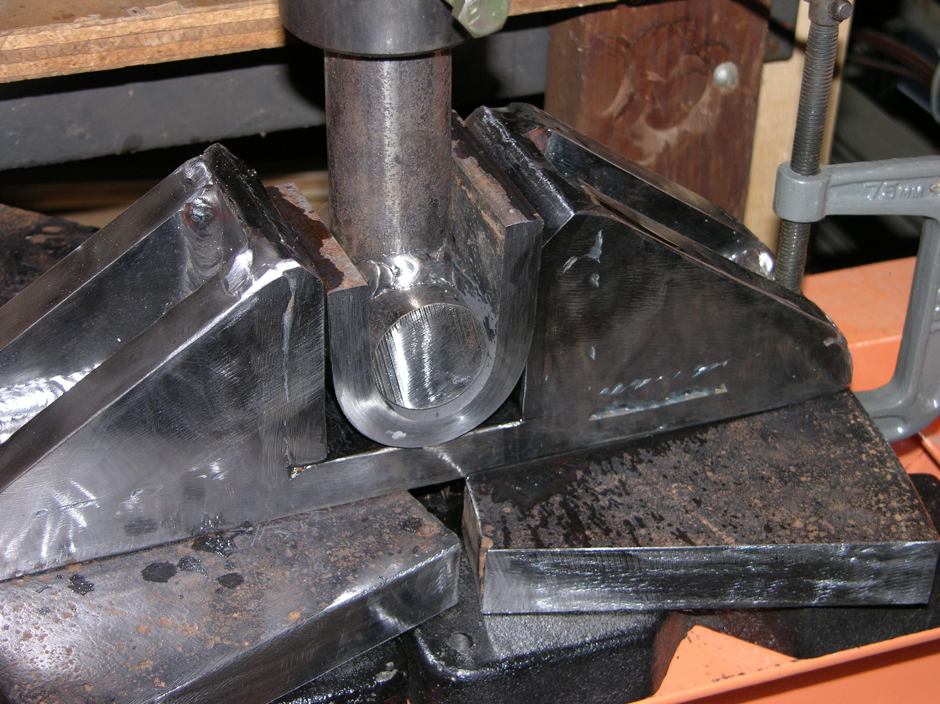

wider bevels on mouth

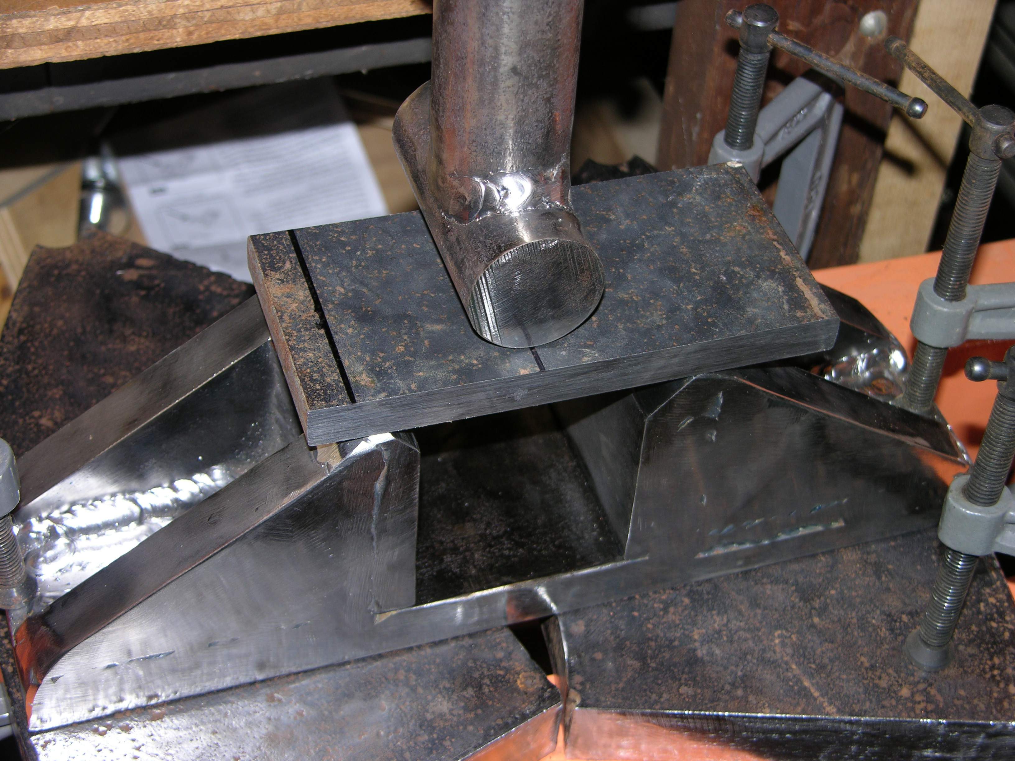

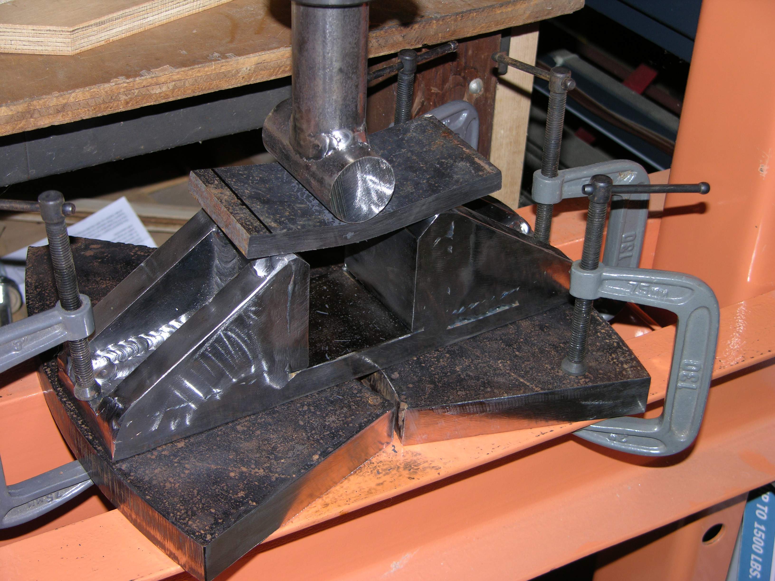

setup for first attempt

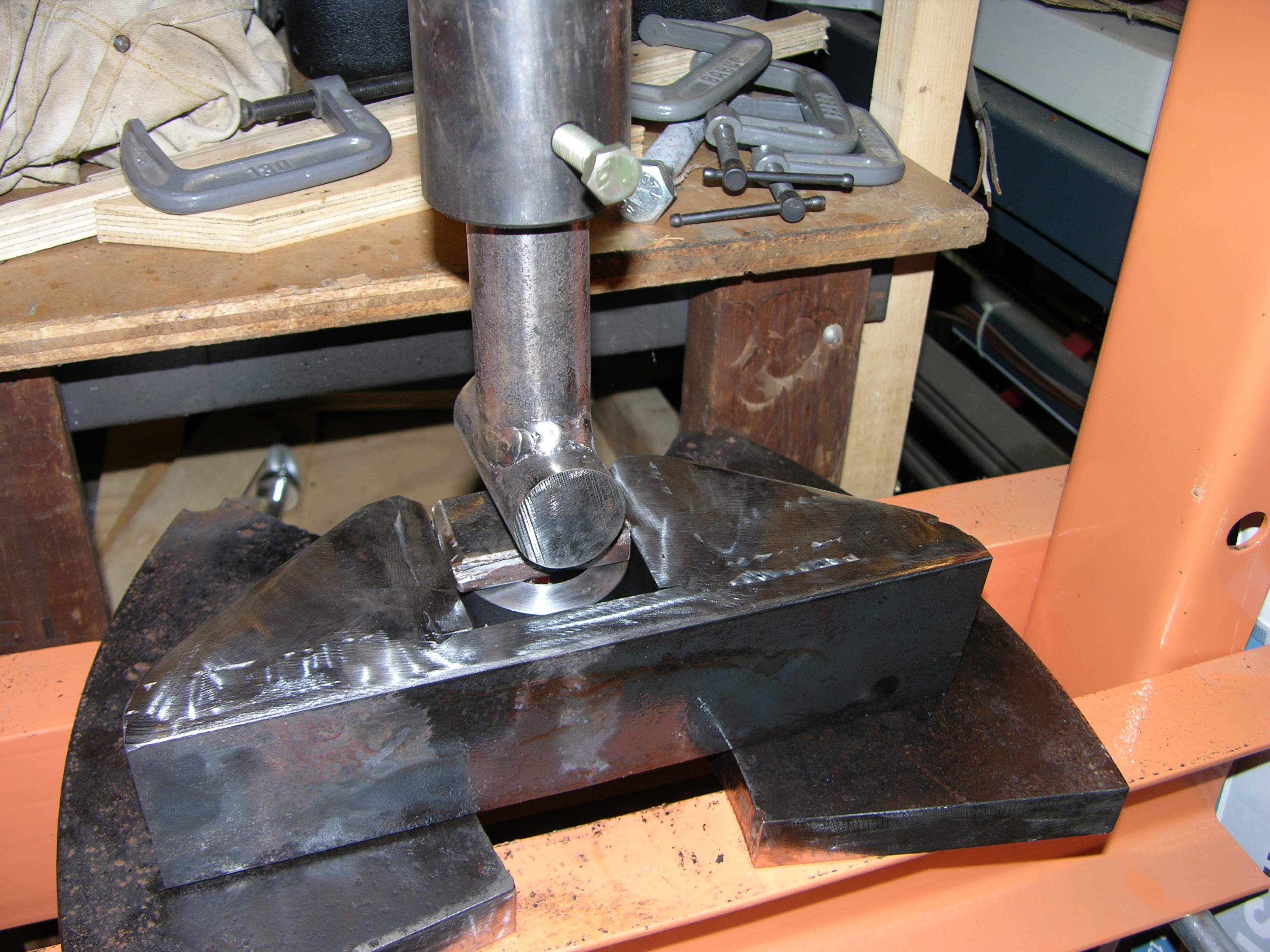

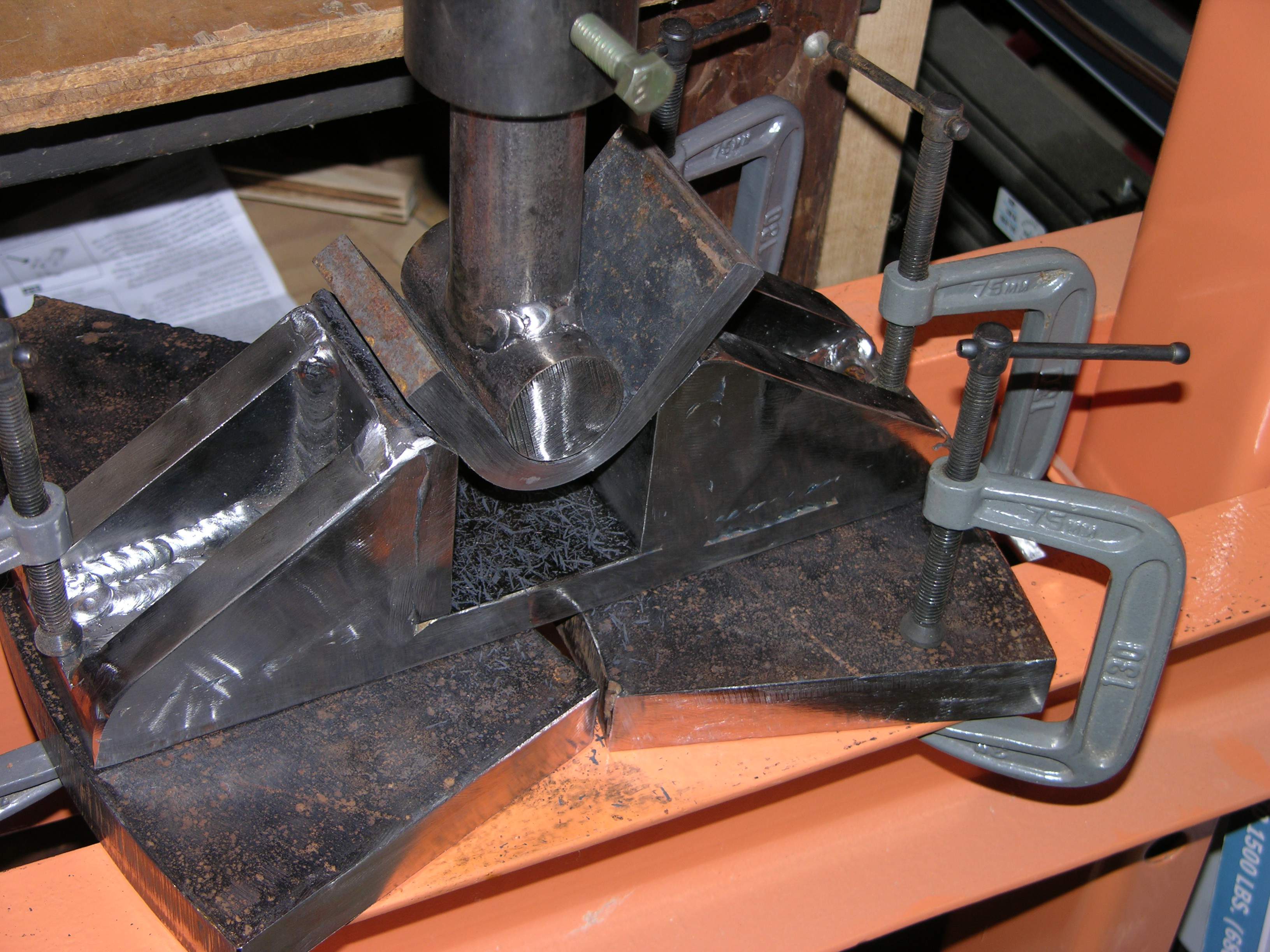

start of push
20 tons with no lube
slick does the trick
Oops, good thing I made more blanks
Second push, corrected error

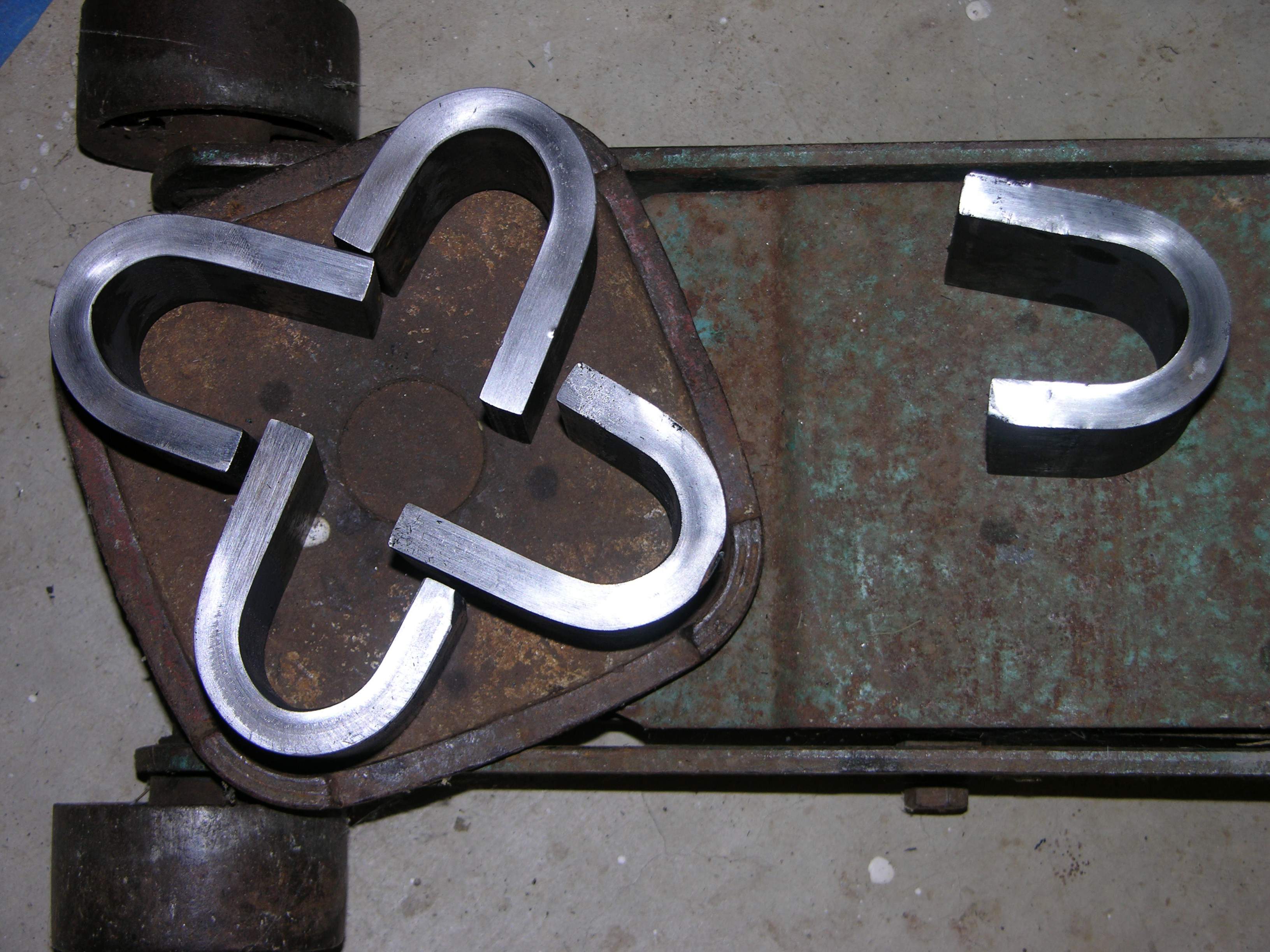

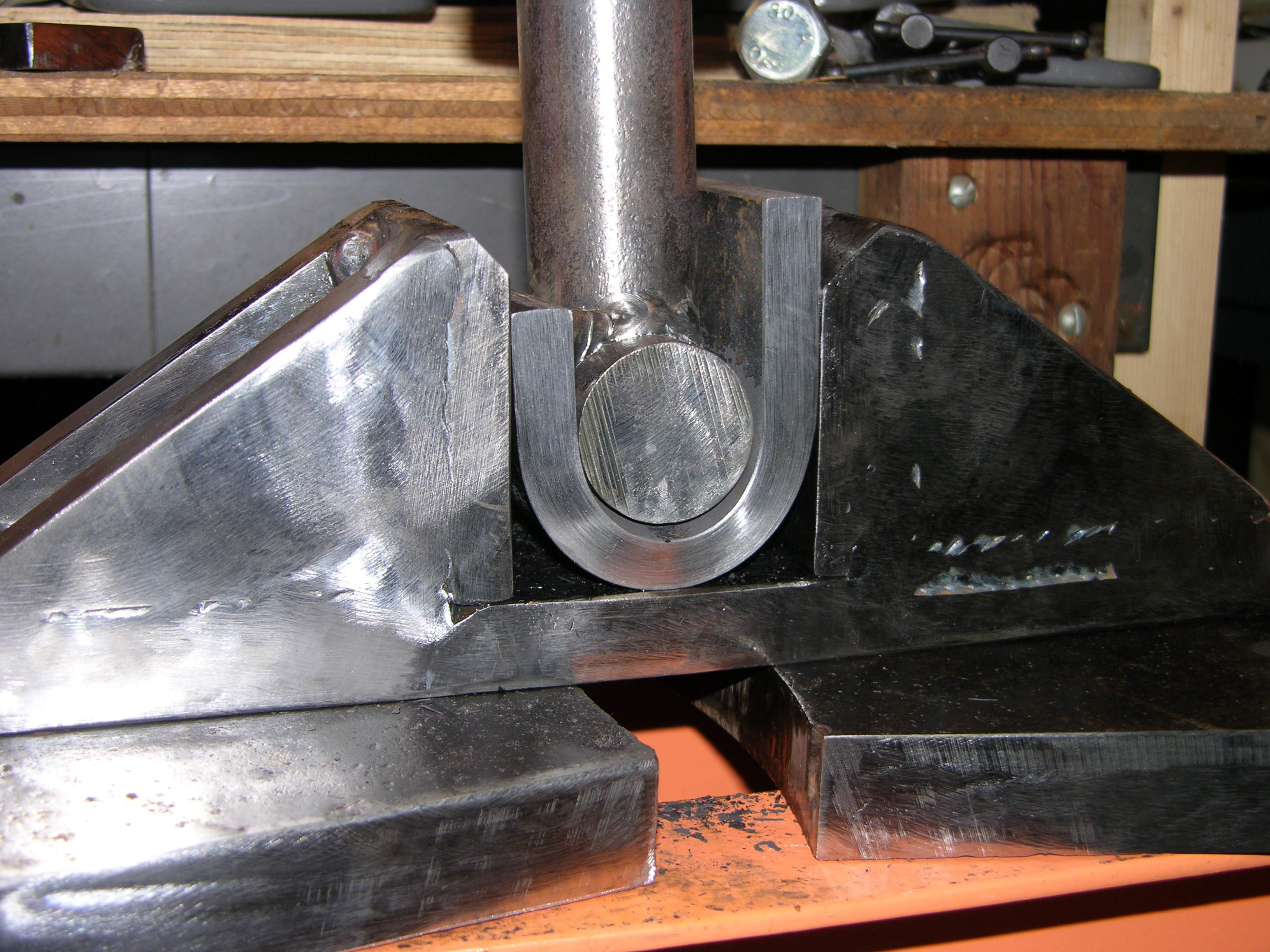

Pushing out the finished part
One lonely boo-boo, 4 winners
Observations - I think that if you applied 20 tons + 4 pounds to HF's 20 ton press, you should do it in another county :eek:
I think I'd have been in trouble if I hadn't increased the bevel on the mouth of the fixture - also, without lube I would have needed to crank up the rosebud for sure. The first third of the push was easy, then it stalled out - at first, I thought "typical HF jack, probably low on fluid", till I tried pulling on the handle instead of using the air actuator - thought I was gonna break the handle and still no movement.
The fixture flexed a little, but other than that just a slight amount of galling on the top bevels.
I sanded down and broke the edges of each piece before pushing, didn't wanna take the chance on a stress crack boogering up an otherwise good part - don't know if it was necessary, only know nothing bad happened ;)
What fixed the first one's problem? As soon as the pusher comes in full contact with the flat bar, make SURE that the horizontal part of the pusher is EXACTLY square with the bar, and that the pusher is EXACTLY centered over, and SQUARE to, the female jig.
Any questions please feel free to ask, I know I learned sumthin' today and I'm glad to pass it on (go TBN :cool2: )
Tomorrow I'll make some messes with the plaz, Friday the rest of my hydraulic parts get here, it's gonna be a busy week or three ;)
Later... Steve
Oh, forgot to mention - only 3/32" of spring back on those parts, that's perfect for what I'm doing. Upper bucket pin will snug down in the bottom, and the slight flare will make hookup easy...
