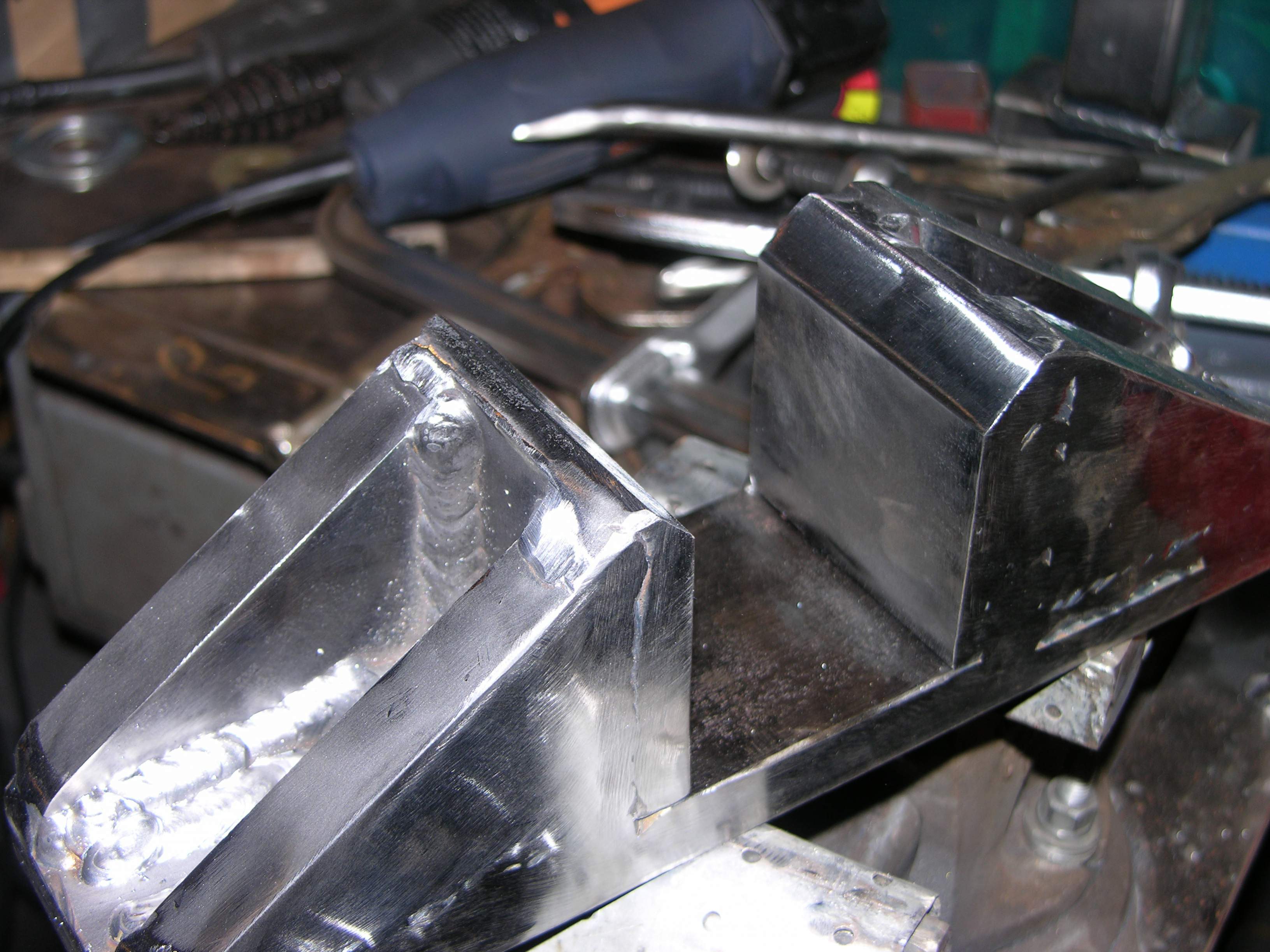

Terry, I like it - I'm thinking I should have made a wider mouth like yours, may need to change that. Guess I'll find out later tonite -
How does/did yours work, and what (if anything) would you have changed? Steve

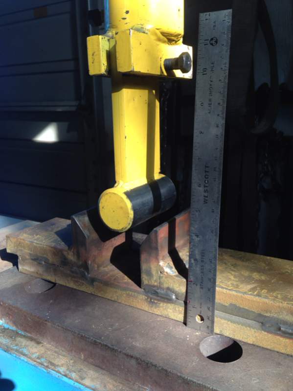

I've bent 1/2" x 3" flatbar with a much flimsier jig than that. I was using a 50T press. I don't know about 20T, but the 50T bent the 1/2" flatbar like butter.
If you want to pretend you are setting up for a production run……. (of more than 2 :laughing: )
Consider to flip it over and bend it "open" a little wider (with the press). Then you release the down-force it automatically springs open a little to release your part.

Terry, I like it - I'm thinking I should have made a wider mouth like yours, may need to change that. Guess I'll find out later tonite - How does/did yours work, and what (if anything) would you have changed? Steve
I don't think I would change anything Steve. Actually surprise myself sometimes when something I design turns out okay. Using a 50 ton press. Wish I had an eighty ton, but then......:) Terry
Edit: the wider mouth is nice. You can always tack in spacers to narrow it up.

Sodo, I know I only need two, but if they're not right they'll be a pain in my ***-embly every time I switch implements :mad: So I went overkill (I usually do) -
From this
20 TON Finger Brake Heavy Duty DIY Builder Kit
I think the 20ton won't have much problem, but then again I'm doing a 180 degree bend not a 90, so I won't be 100% confident it'll work til it actually DOES... Besides, I made this so it'd take spacers to do narrower things if/when I need to, so maybe I'll get more out of it than two pieces and some experience :rolleyes:

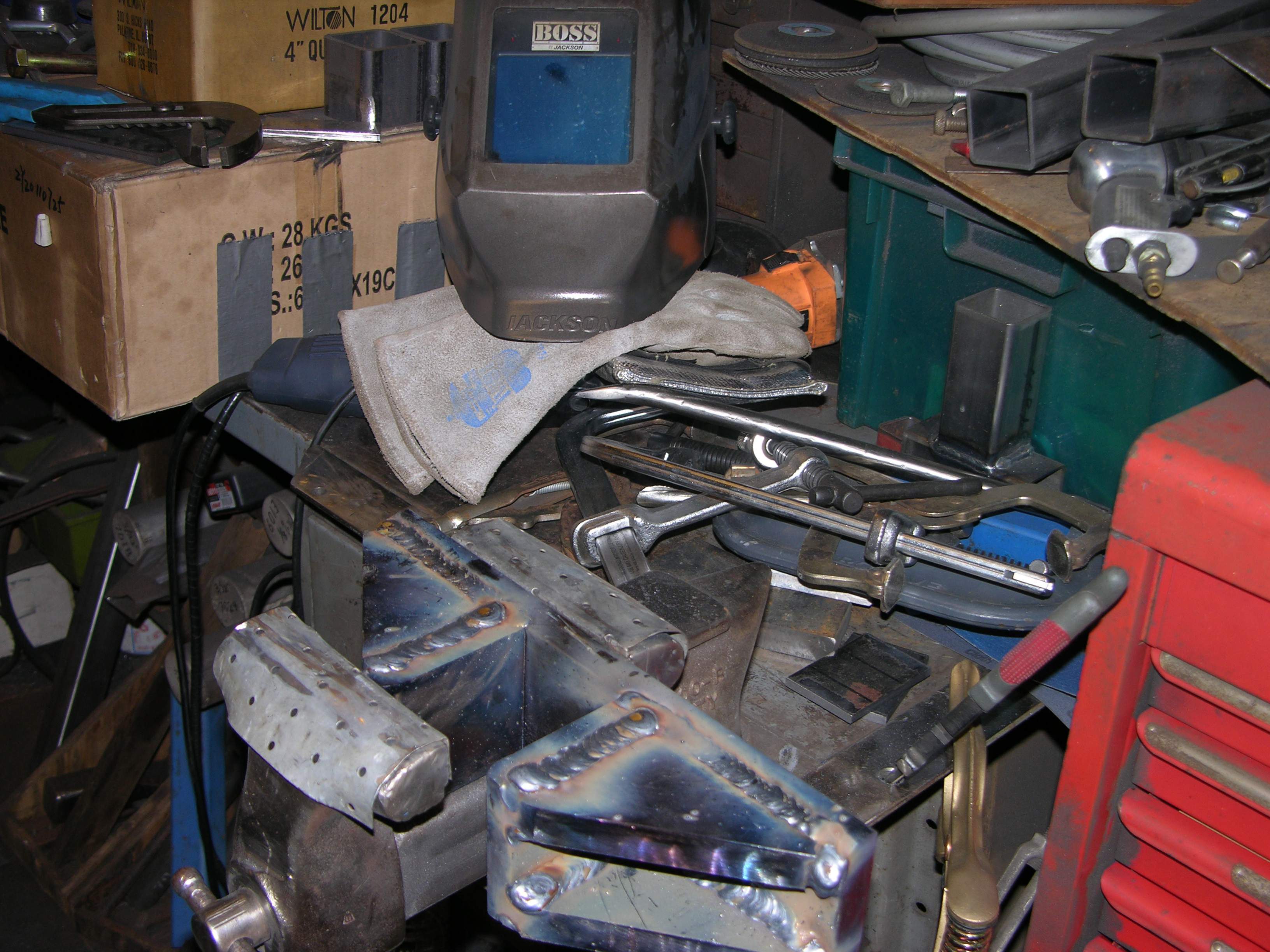

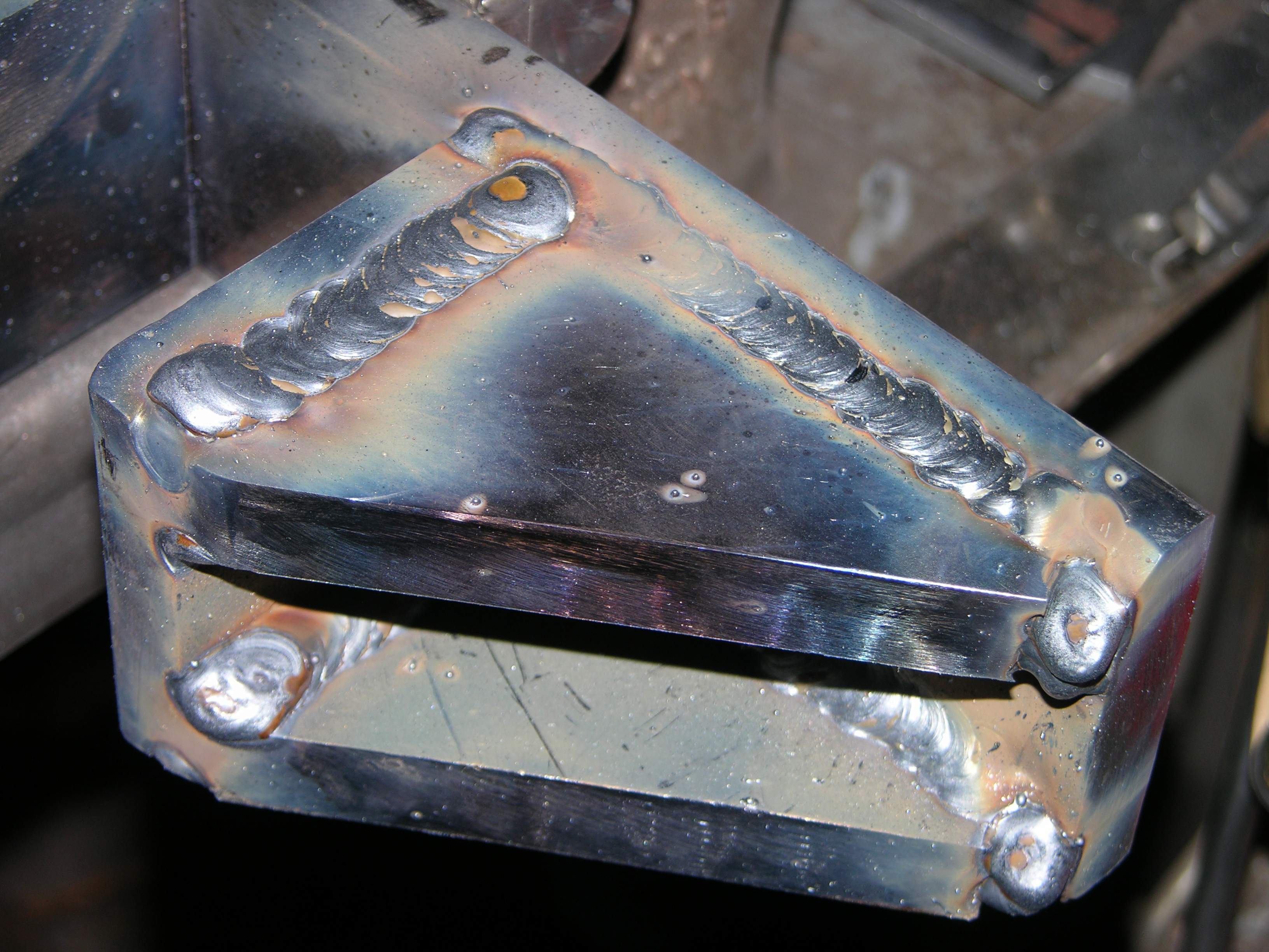

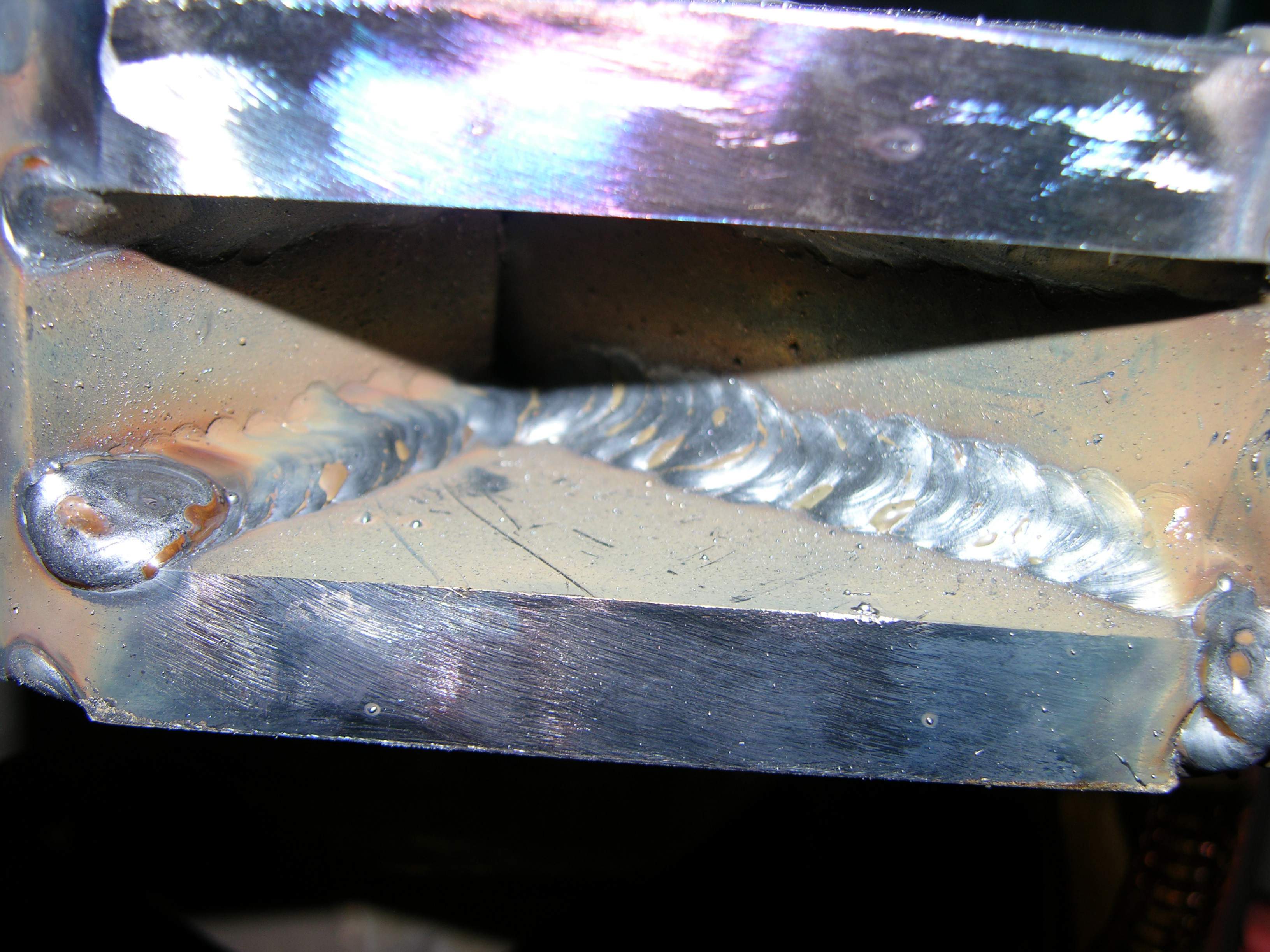

No actual parts bent yet - cooled it, welded between gussets, ran a couple stringer beads (your #10) on each gusset, ground the outside welds flush and blended so it would sit flat on either side (better support if/when I need to lay it on its side to push out the part), found the scrap piece of 1" plate to make new press plates, cut that in half.
After things cooled, I measured the distance between the uprights - it's dead on 2-9/16" both sides, top and bottom :cool2:
After seeing Terry's version (thanks Terry), I'm gonna make bigger bevels on the "mouth" next - Gotta clean up the new(old) press plates a bit (bit of slag here and there, 10 years of Oregon "patina")
Sooo, probably see some "proof of the pudding" sometime this afternoon (did I forget to mention I'm sometimes just a teensy bit OCD ?) :rolleyes:

Shield, used yours (except once when I forgot) and once when I welded both long welds on one side then both inside opposites of those.
Took more pics, will upload later, probably around 5 or 6. (that's "retirement time", got a grain of salt??!? :laughing: )
Sodo, at this rate I'd be money ahead to take a part time job as a Wally-world greeter and hire somebody ELSE to do this, but (in spite of the humor in watching WallyWorld freaks) where's the fun in THAT? :D
I beveled the inside tops @ 45 degrees, used the bigger table that came with the Jet saw and clamped a cheap plastic "miter guide" from Rockler to the base of the jig, it has a bar that's supposed to fit the miter slot on a table saw - held that bar against the edge of the bandsaw table firmly and pushed the jig into it. Not perfect, but it worked better than trying to keep both sides equal with a side grinder :rolleyes:

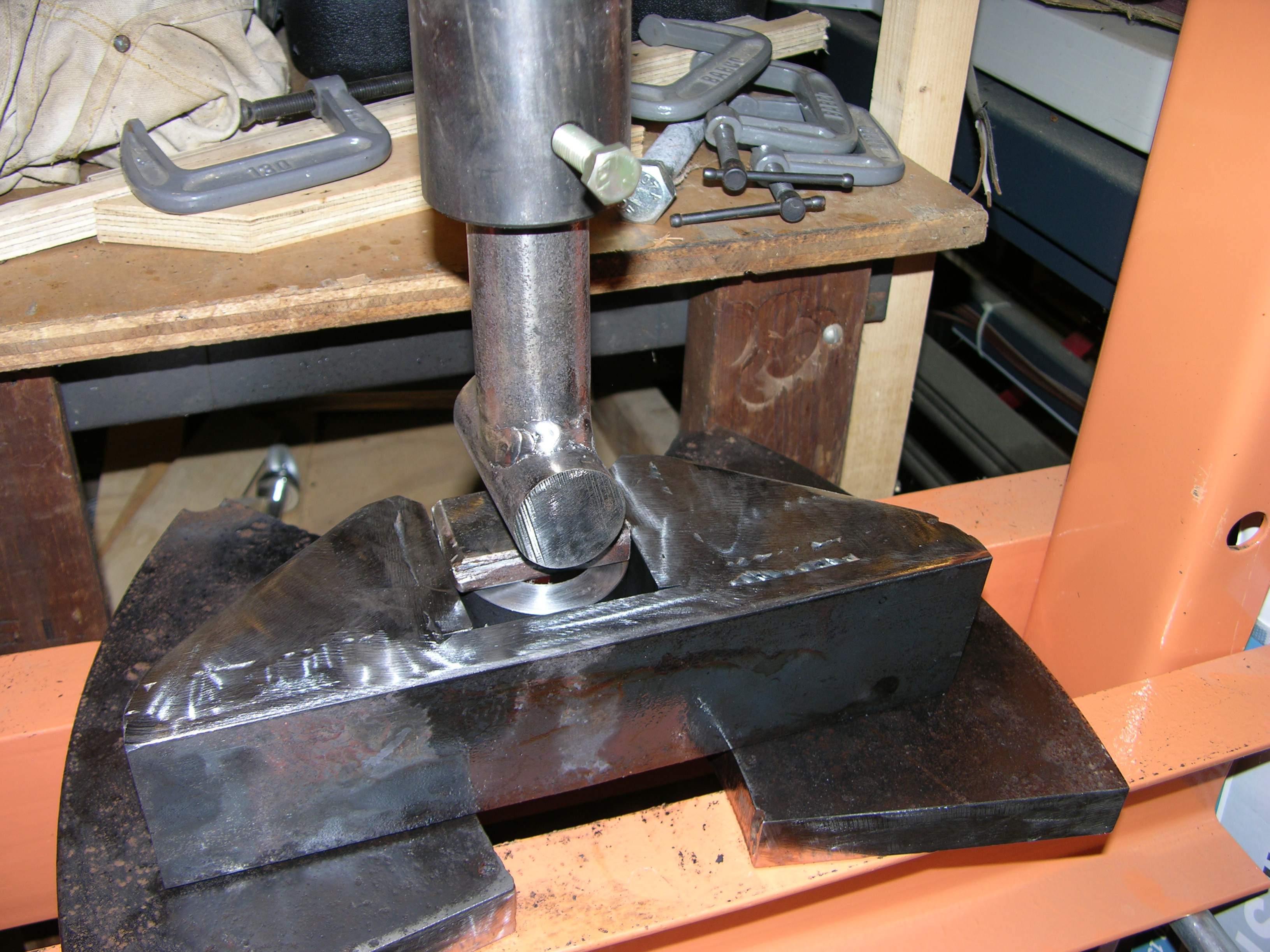

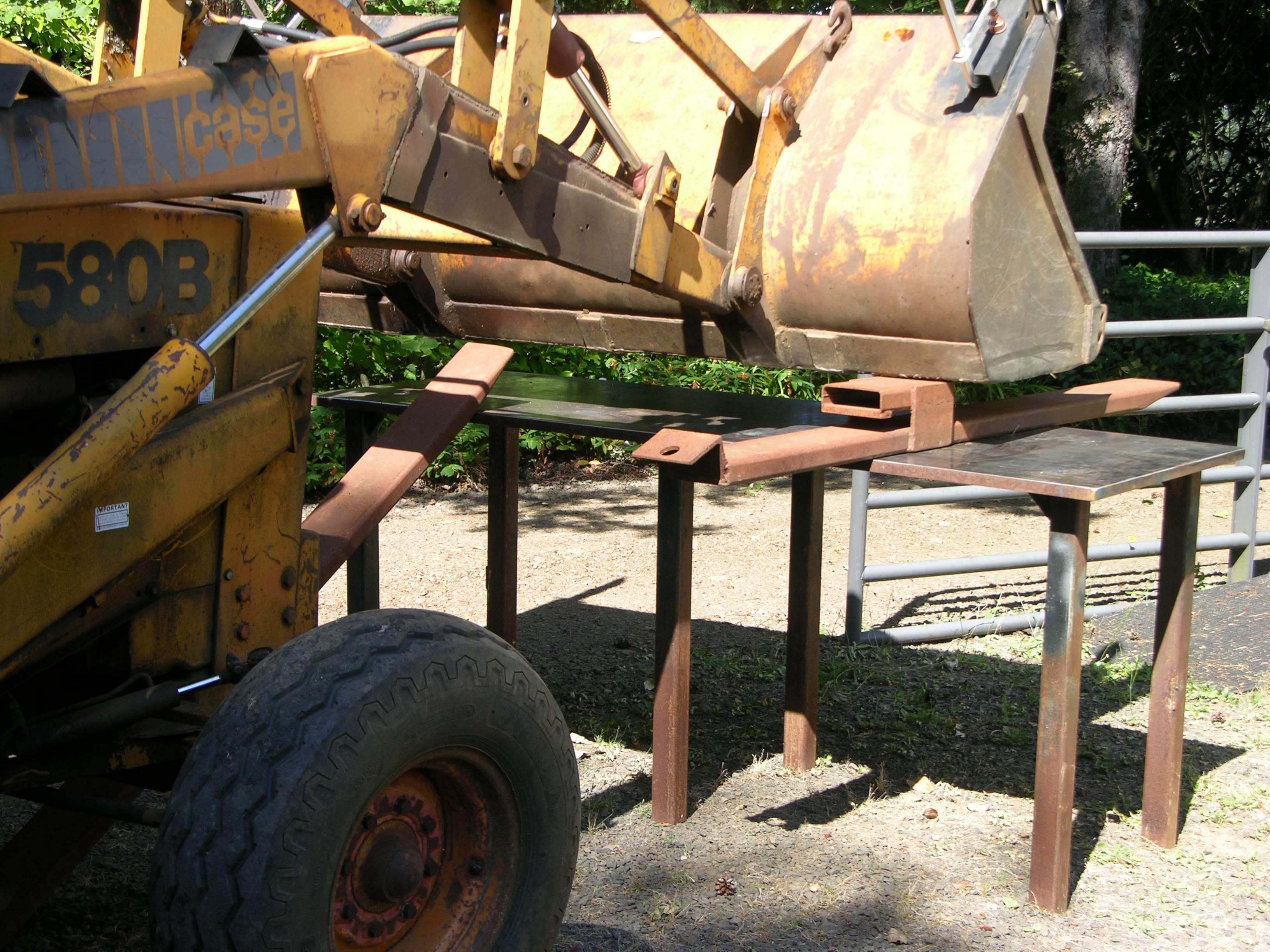

#33
wider bevels on mouth
setup for first attempt
start of push
20 tons with no lube
slick does the trick
Oops, good thing I made more blanks
Second push, corrected error
Pushing out the finished part
One lonely boo-boo, 4 winners
Observations - I think that if you applied 20 tons + 4 pounds to HF's 20 ton press, you should do it in another county :eek:
I think I'd have been in trouble if I hadn't increased the bevel on the mouth of the fixture - also, without lube I would have needed to crank up the rosebud for sure. The first third of the push was easy, then it stalled out - at first, I thought "typical HF jack, probably low on fluid", till I tried pulling on the handle instead of using the air actuator - thought I was gonna break the handle and still no movement.
The fixture flexed a little, but other than that just a slight amount of galling on the top bevels.
I sanded down and broke the edges of each piece before pushing, didn't wanna take the chance on a stress crack boogering up an otherwise good part - don't know if it was necessary, only know nothing bad happened ;)
What fixed the first one's problem? As soon as the pusher comes in full contact with the flat bar, make SURE that the horizontal part of the pusher is EXACTLY square with the bar, and that the pusher is EXACTLY centered over, and SQUARE to, the female jig.
Any questions please feel free to ask, I know I learned sumthin' today and I'm glad to pass it on (go TBN :cool2: )
Tomorrow I'll make some messes with the plaz, Friday the rest of my hydraulic parts get here, it's gonna be a busy week or three ;)
Later... Steve
Oh, forgot to mention - only 3/32" of spring back on those parts, that's perfect for what I'm doing. Upper bucket pin will snug down in the bottom, and the slight flare will make hookup easy...
