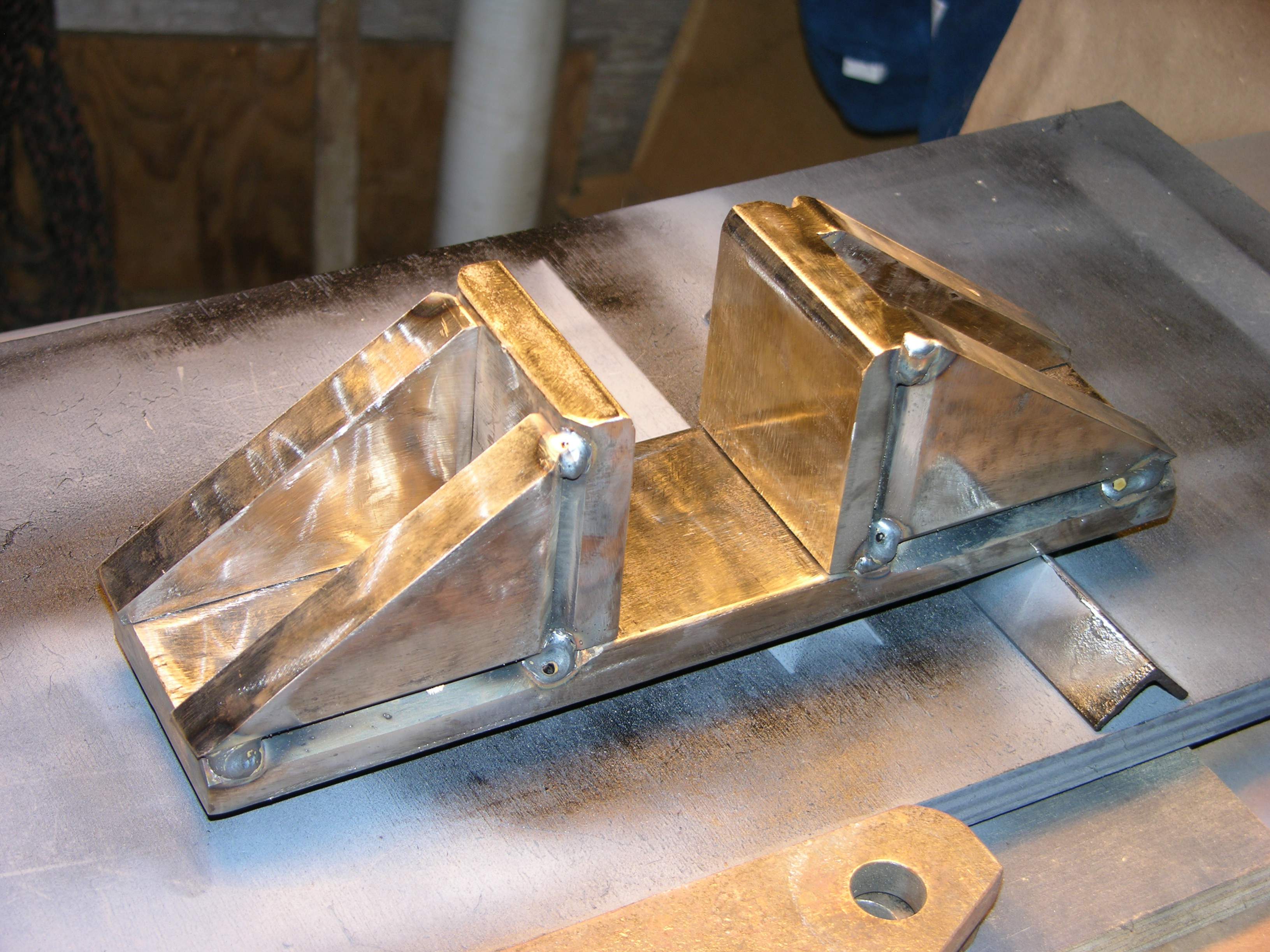

Built this bending jig for use on my 20 ton press - all flat bar is 3/4 x 3, long dimension is 12", gap between uprights is 1/16" wider than the 1.5" male plunger plus two thicknesses of 1/2" x 3" bar stock -
The intent is to bend a couple of U-shaped 3" x 6" pieces of 1/2" mild steel by pushing them down between the two uprights.
It's only lightly tacked at present, and it's EXACTLY the size and shape I want it to be - hopefully when I'm done it won't explode when I try to cram a piece of 3" wide 1/2" flat bar into it :rolleyes:
I'll be welding it out with my mm252 and .035 Lincoln L56 wire, C25 gas.
Question - would you preheat it (and if so, how hot) and weld it out hot then let it air cool, do small stitches and let cool between, fill the gap between left and right sides with solid bar stock and clamp in a vise and just go for it, or ??!?
I know it's tempting to voice opinions based on conjecture, but I'd prefer experience since I don't want to build another one of these just to get it right - it will only be used for sure on two un-even legged U-shaped pieces which will be the upper "hooks" of a quick-attach system for my Case 580's FEL. I want to be able to switch from bucket to grapple to hydraulic flail to forks to brush bucket without taking the whole day.

I don't think preheating is necessary. Even if you welded like crap, I don't think a 20 ton press could break that in the way you want to use it. I would be more worried about spring back, but I assume you have have thought about that and have a plan for dealing with it.
With a properly designed and welded piece, the welded part should never be the weak point, it should be as strong or stronger than the rest of the steel. I don't think that is what you are looking for here, nor do I think it is necessary. My vote says weld away, just make sure you get decent penetration. I personally would stick weld it with 6010 followed by 7018, but that's because I don't have a mig welder.

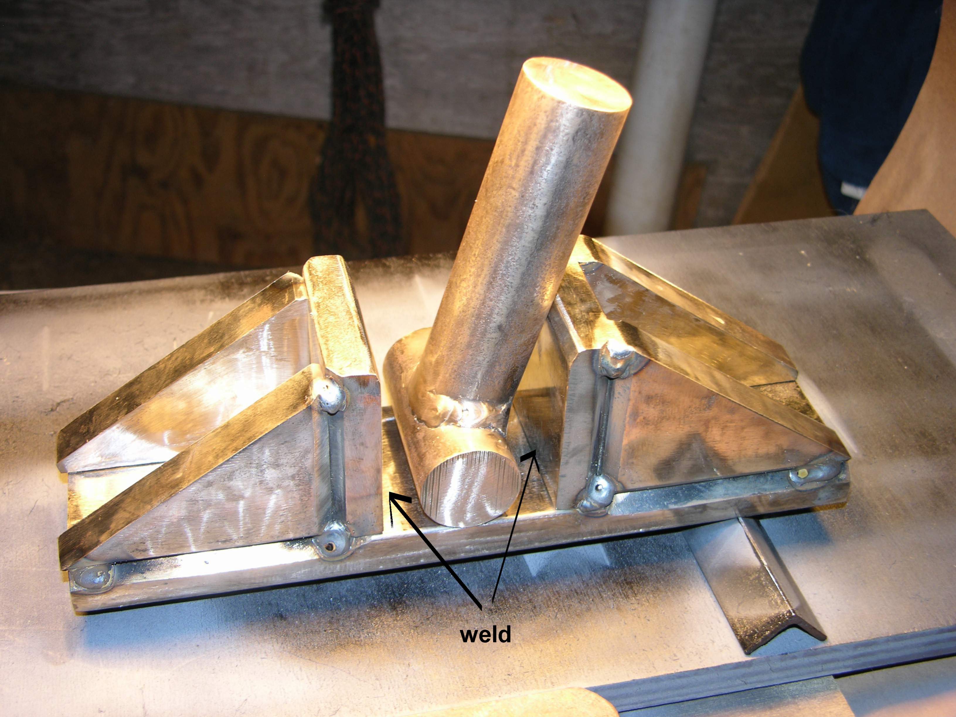

Are you planning on welding all the way around? If so, these two welds right here will bend the bottom plate. You need to think about a strong back under the bottom plate. Or pre-bend before welding.
Yes, shieldarc is correct. I apologize, when I first read your post I was taking it as you were asking about preheating for weld-penetration purposes.
Heating to prevent/fix warpage is definitely an art. Your stitch method may work but I will not comment further. Good luck.

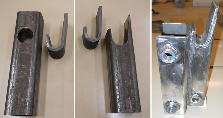

There are several threads on QA setups, mostly for Kubota or JD, but I didn't bookmark 'em - apologies to whoever I "borrowed' this pic from, but this is what I'm going for - just "upsized" to fit my 580 Case. Also, channel/square tubing won't work for my dimensions, so all pieces will be 1/2" FB welded in an "offset H beam" (one of the two channels in the "H" narrower than the other)
Once the "U" pieces are done, I'll use them for a pattern to cut the 1/2" FB pieces out, then weld in the "U" (see pic, thanks to whoever posted this (feel free to claim it, I only know it's NOT mine and I'm very grateful for it)
Hope that clears a few things up, feel free to critique my plan... Steve

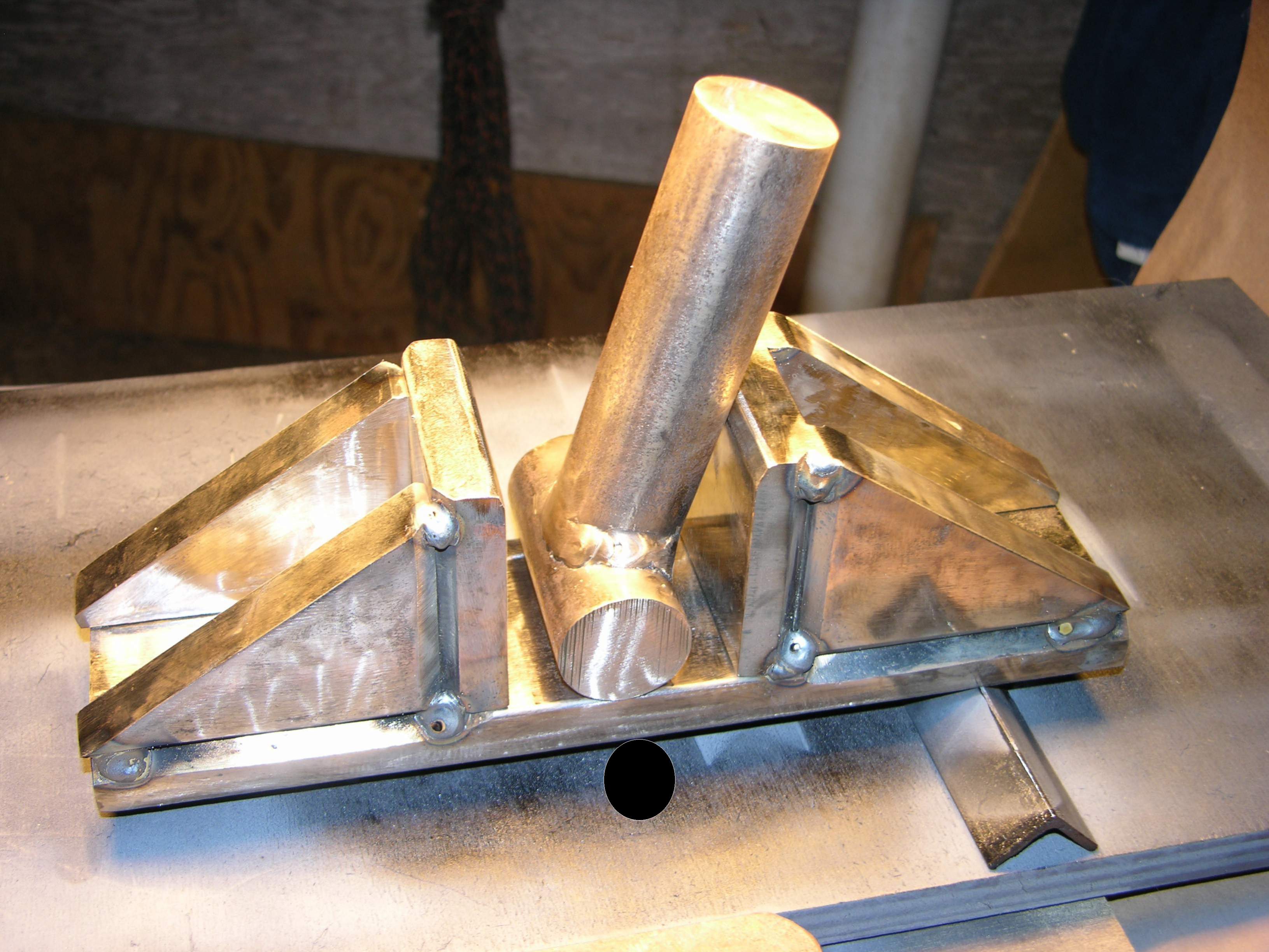

/ Preheat advice requested #9
Me personally I would weld all the way around. Before making those welds on the vertical plates I would put say 1/8-inch or 1/4-inch round stock under the center of the plate and clamp the ends down. This will put a slight bow in the plate. After you make the welds let it cool completely to the touch before removing the clamps.

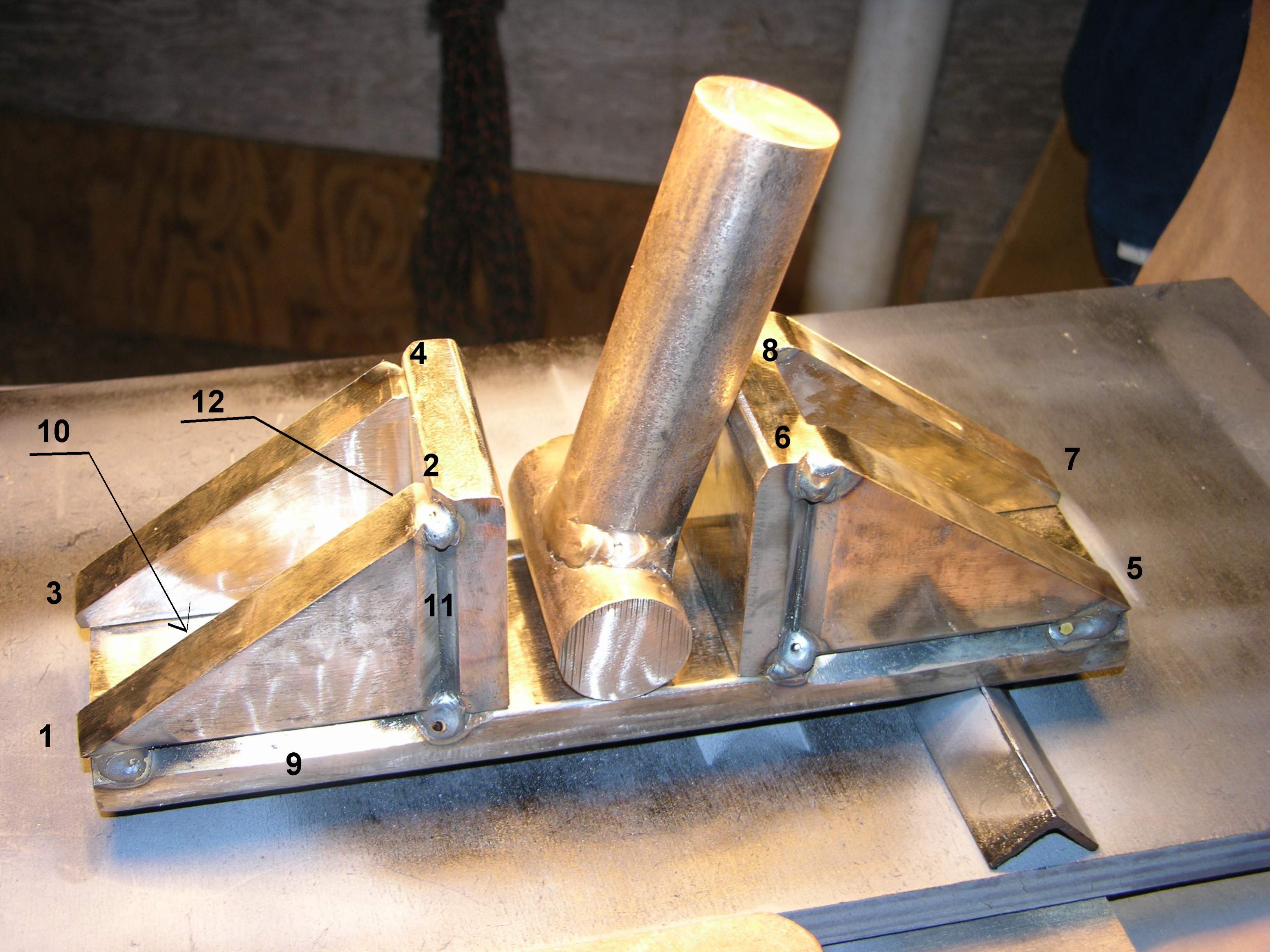

/ Preheat advice requested #10
Here is the weld sequence I would use. Make sure you make the opposite weld each time. And don't be in any big hurry while doing this.
If the vertical plates do bow towards each other you can heat a line on the bottom of the plate to heat shrink it back to planned shape.

/ Preheat advice requested #12
There is more than one way to skin a cat. Your weld sequence will most likely work too.;)
See how I made all the short end welds on the gussets first? Then #9, opposite side to the gusset is #10. Then #11, and opposite side #12. Then jump to the other far side, and do the same thing. Then jump over to the gusset that has #3 and #4 end weld. Moving around to opposites side is key to countering warpage. These welds are all short, other wise I would have you back stepping the welds as well.
As long as the metal is over 50-degrees I wouldn't worry too much about pre-heat, but some pre-heat never hurts. Another good trick is to pre-heat the bottom plate under those welds on the vertical plates.

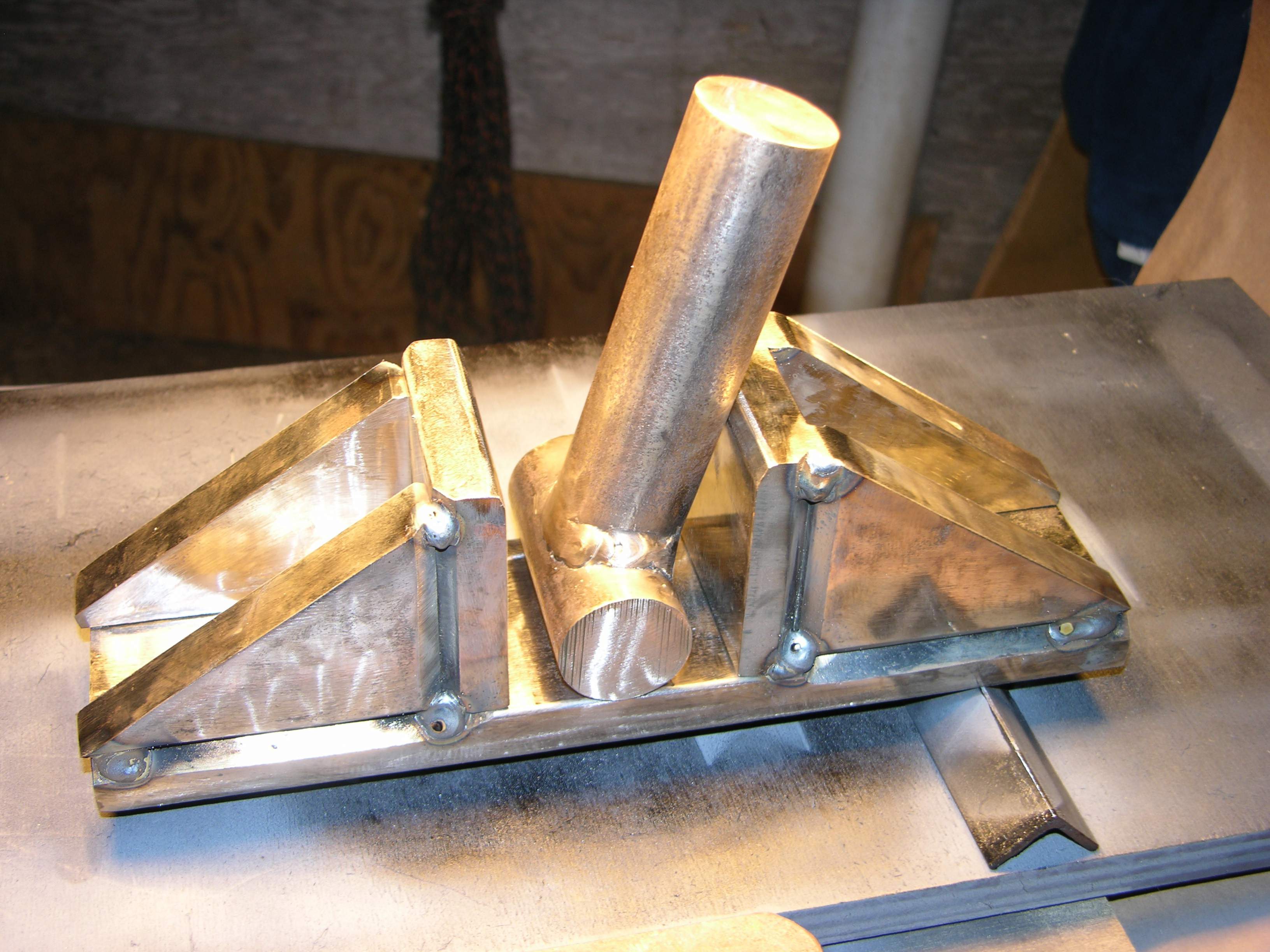

Welding's done except for between the gussets, gonna wait til it's cool for that so I can handle it easier. It was kinda interesting (snug) doing the inside welds, but they look mostly OK for penetration.
At 10-15 minutes after the last weld, measured distance between the uprights - 2-9/16 at the base, 2-19/32 at the top. I'll take it, if it doesn't get any worse than that after cooling. No cross-ways welds, so no real surprise. After it cools, I may do a few touchups but I'm mainly concerned with strength... Steve

/ Preheat advice requested #17
While it's cooling you could take your air compressor and blow air down the center between the vertical plates, that will pull the top of the vertical plates together.:thumbsup:

I think you will get sounder advice from others, Steve but here's a pic of one I built years ago.
Terry
