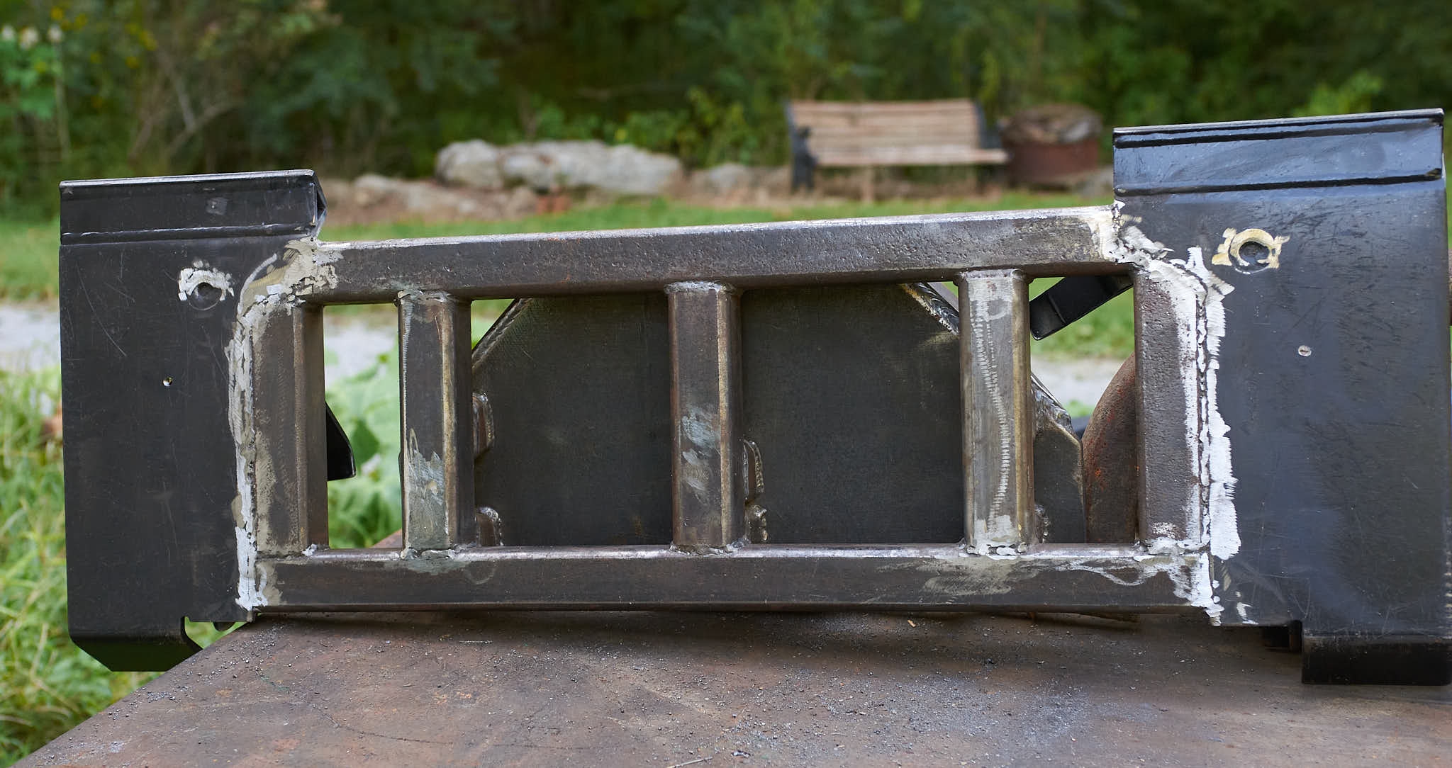

10.8 degrees which I roughly copied from ponytug's adapter in the sense that he used 2x2 tubing at the bottom to establish his angle. I couldn't find enough flat plate in the dimensions needed to totally copy his adapter, but I had enough 2x2 heavy wall tubing on hand to make this version.
Already seeing things I wish I'd changed. If I had used two vertical tubes in the very center of the adapter, I could have sandwiched a receiver hitch tube between them....
Overall, I suspect PowerTracManiac may have the better approach because the basic SSQA adapter he used as a starting point is already completed, and he didn't have to source a lot of other materials other than the angle his welding shop was able to provide.

To illustrate the missed opportunity, I think I could have welded in a receiver tube between two tubes spaced in the center if I had thought of it before welding this up.

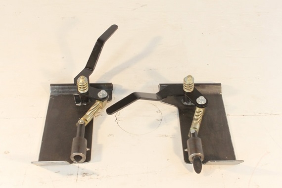

The latches don't seem to operate that smoothly compared to my Kubota (grease will help that). I welded in a couple of stops and a guide plate. Had to cut the latch arms down a bit to clear the PT plate.

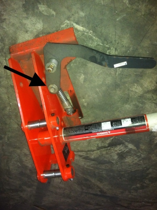

Make sure they go over center when the pin is latched down with the lever pulled up in your case:

Thank you. Is there a way to know when the latch spring is correctly tensioned?
   / Powertrac to ssqa adapter #45
I guess it is correctly tensioned when the latch pin stays down and latched.
What is the reason that your levers work backwards to latch and unlatch?
This is normal:
   / Powertrac to ssqa adapter #46
You are correct. I installed them the wrong way after I took them off to weld the adapter. The latch arms should push down to engage and pull up to disengage the pins.
It looks like I have full engagement and disengagement, but it would have been better not to have reversed the manner of engagement.

Nice work 2 many.
Couldnt u could still weld in a receiver tube to the side of the center post? I don't think being very slightly off center for the receiver tube will affect it significantly.
Also, as suggested above the adapter angle is a compromise. The curl is somewhat limited at full extension in either direction on my PT1460-even with stock implements and no adapter. Since most implements are usually run in the middle range of the curl and not the extremes, I think your angle will prolly work out OK.
