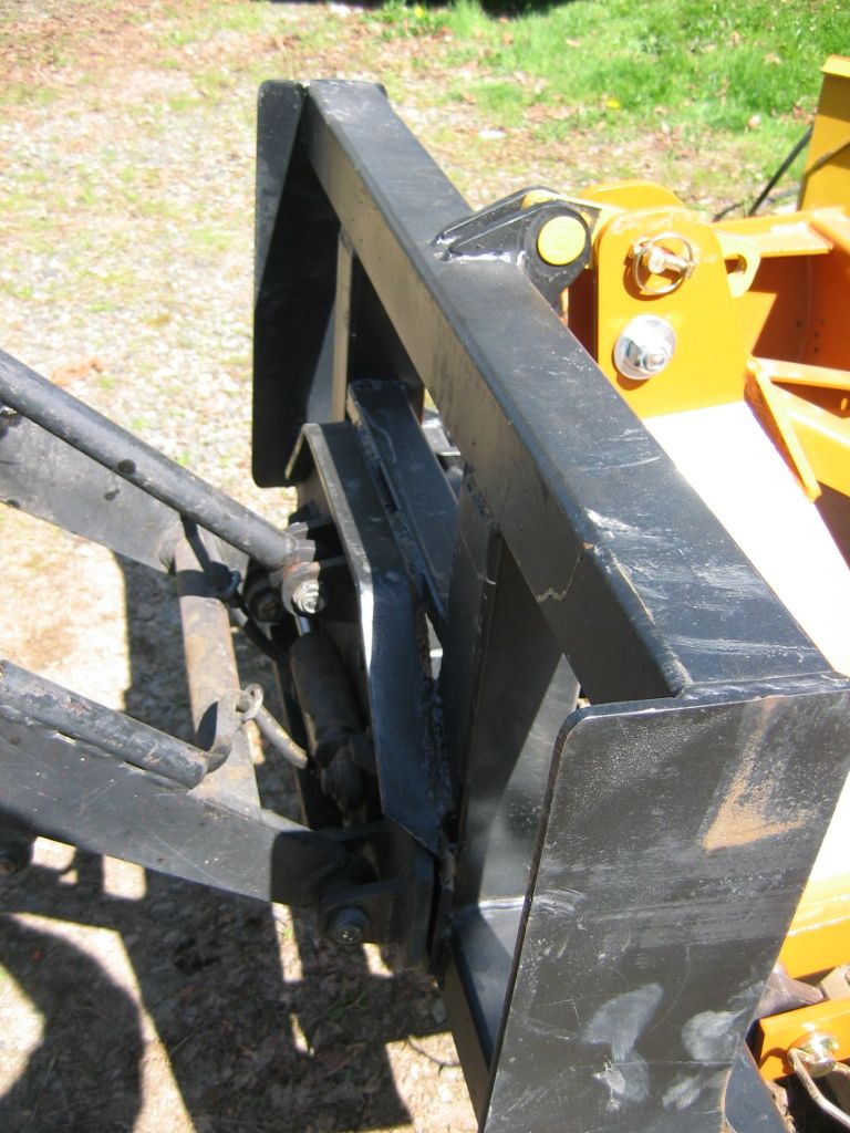

/ Univeral 3 pt adaptor #7
Saddly, I am down in LA warming my toes by the fire... We are in the middle of this vastly large city (if you have never been here, LA and its environs is over 100 miles wide, now bigger than Belgium), so no threat to our personal happiness, but I have a lot of friend in the Malbu and Saugus area and probably a couple that have homes in Big Bear so, yes, in a long winded way, my heart goes out to those people. No one lost anything but many had to spend a few nights on friends couches.
But, because I am in LA I cannot get you any fresh pix. Here is the 3pt I purchased from Lackender, the only photo I have... At the lower right of the picture you can see where the box blade attaches to the 3pt. Picture if you will a simple peice of half inch steel with 3 holes in it (like a 3" wide by 9" long piece with 3 holes). Also picture a lip on the center hole that fits around the flange of the lower holder on the 3pt. Basically if you want to raise or lower the device, you bolt this on in the center bolt and connect your device to the higher or lower bolt. The flange keeps the lower corner from walking in and out...
I hope it makes sense. Give me a month and I will be home I hope.

/ Univeral 3 pt adaptor #8
One other thing on the 3PT. it is a P I T A. Like in a HUGE way. My version is very heavy so nearly impossible for me to lift to connect with my Box Blade (Currently my only 3PT attachment). I hook it onto the tractor, and then monkey around with height and position for an eternity, Just like a CUT.
It may make more sense to have a number of QA Plates made up and weld them onto your implement. At 400 for shipping I bet you can get at least 4 plates if not more made locally.
/ Univeral 3 pt adaptor #9
I think the best solution is to have one 3 pt adapter and also have a bunch of extra plates to weld to dedicated equipment for the PT. I have a 3 pt lifting boom from the tractor supply company that would take a fair amount of metal to properly attach a plate to but the 3 pt adapter works well on this. But I have an old snow plow from a truck that has a plate welded to it. Having the adapter is nice because I share some equipment with my brother and you might end up borrowing something like a york rake from someone.
The 3 pt adapter is a little harder to hook up to a piece of equipment than a 3 pt on a tractor since you do not have one arm that you can raise or lower to align the pin. If I had to hook it up to something extremely heavy, it might be easier to hook it to the implement first but so far, for a back blade, box blade, and lifting boom, it has been easy enough to hook up with it connected to the tractor. Normally, I leave it hooked up to a piece of equipment until I need it for another piece of equipment. There is one change I will likely make. He has it designed so that most equipment hooks up without an adjustable top link. That has worked for everything but the lifting boom. If he welded the tabs for his top link connection a little farther apart, my adjustable top link would fit. Right now, I just use a piece of thin Unistrut as an adjustable top link since it has the evenly space holes already in it.
Lackender can make the extra plates at a reasonable cost. Prices may have changed (steel has gone up a lot!) but my 3 pt adapter with an adapter plate on it was $425. He also sold a very nice adjustable pallet fork for $625. His buckets are well made and I am very happy with the mini hoe. I have already gotten my money's worth out of the mini hoe, 3 pt adapter, and forks. Unfortunately, he made the first set of adapter plates wrong but I caught the mistake before Carl's were shipped. He sent me new plates but it was not until recently that I was able to get them welded on. I found Randy to be a very nice person to deal with and highly recommend him.
