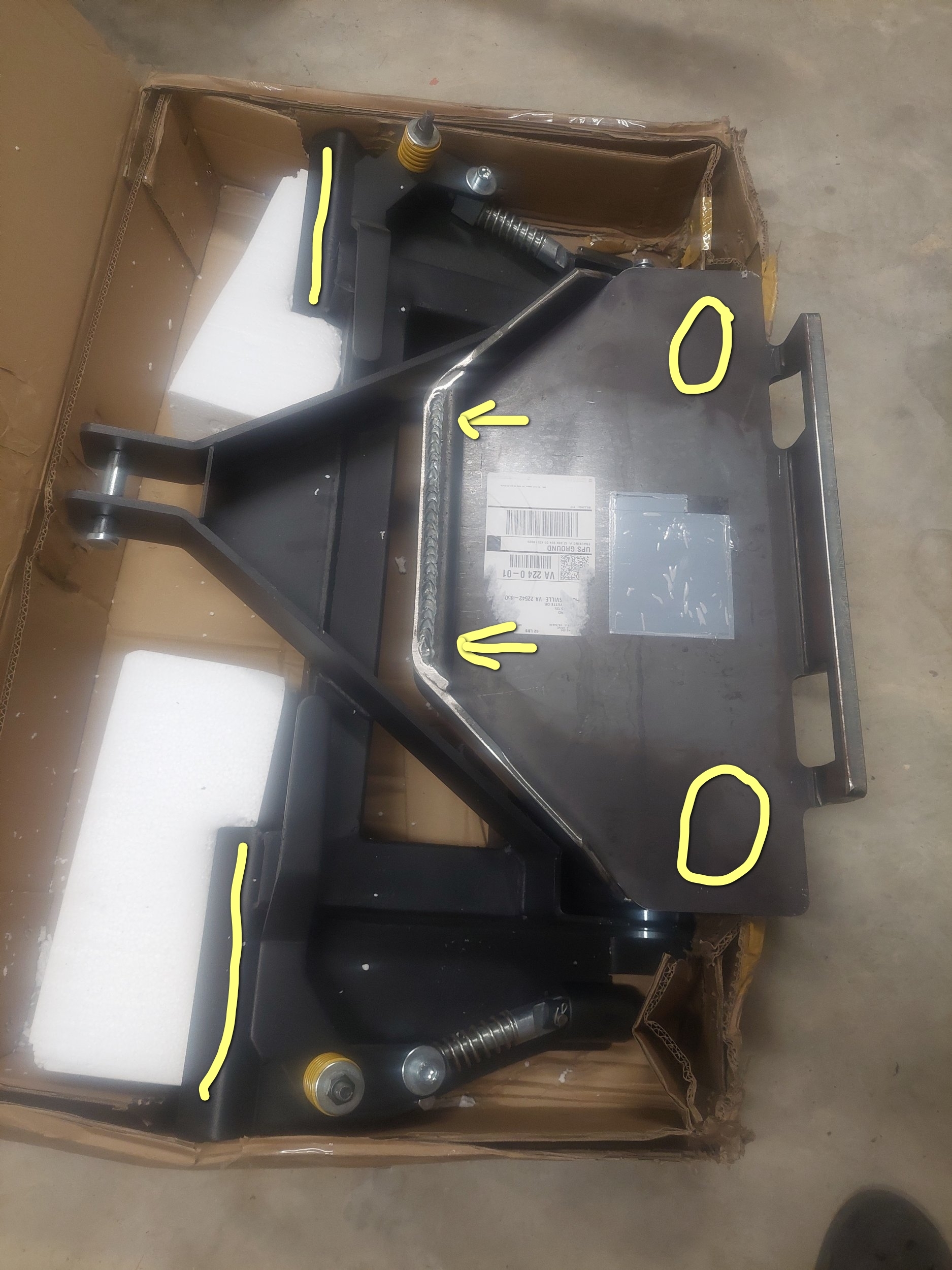

Thought I would start a specific post for this to follow my build.
Here is where I am at this point.

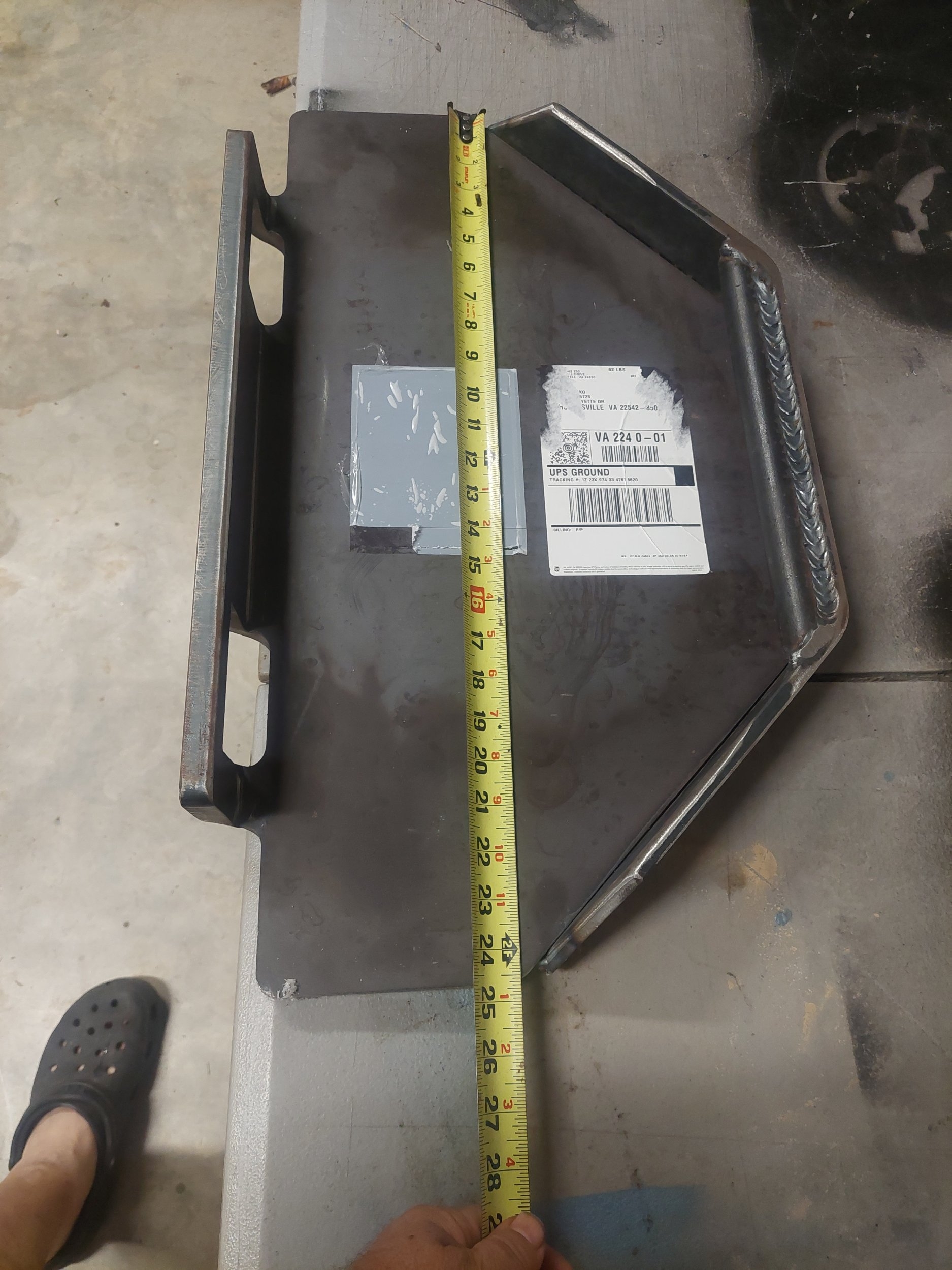

Bought the powertrac adapter plate directly from powertrac. This plate is for a
Powertrac 1460:
Bought the 3 pt hitch to ssqa adapter from Amazon.
Starting to line up the adapter plate to the ssqa to figure out what needs to be cut to make this work.
/ Powertrac to ssqa adapter
#2

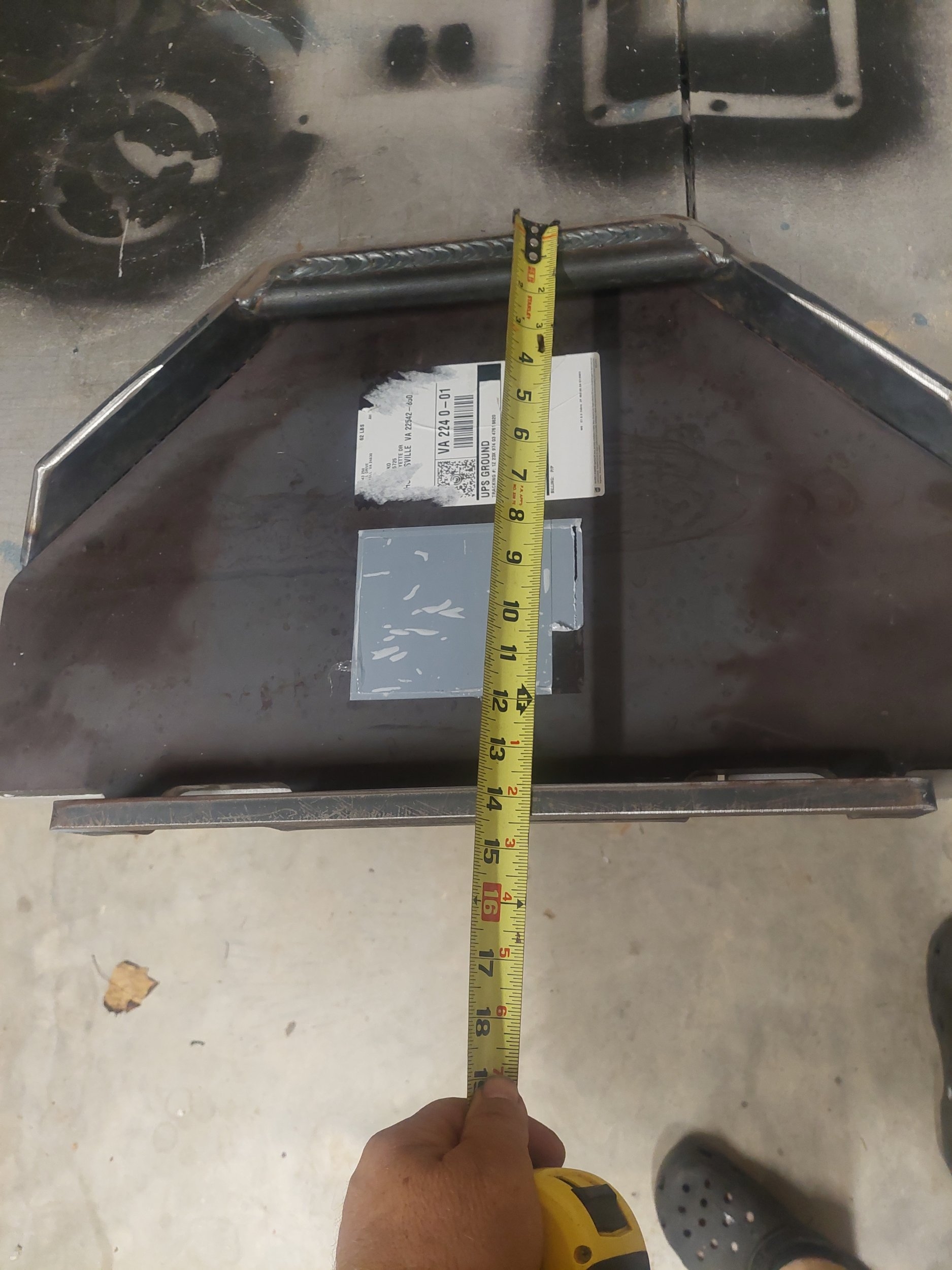

I am thinking the top of my Powertrac adapter plate should be just below the angled "hook" portion of the ssqa-just about where the red line is. I think I will cut off the top of the 3 pt hitch portion of the ssqa plate.
If I lower the PT adapter plate some, it looks like I would cut away less of the 3pt portions of the ssqa. This would lower the point of contact of my PT adapter plate and the ssqa implements would stick up a bit? Don't know if that would be much of an issue or not?
I thought I might get lucky as the PT1430 adapter plate fits inside the 3pt hitch portion of the ssqa plate nicely (as pictured in previous post by another member). Unfortunately, the PT1460 plate looks wider and doesn't fit inside nicely. If you have a PT1430 and or smaller machine this will prolly be a little easier for u to fit your PT adapter plate inside the 3pt hitch portion of the ssqa.
/ Powertrac to ssqa adapter #3
Looks like cutting into the top portion of the SSQA would put the PT plate where it interferes with operating the latch arms?
If you put the PT plate low, that would raise the overall height of where the SSQA carries the implement.
Seems to me the main issue is trying to figure out how the PT plate carries the load and then how to distribute it to the SSQA. On the PT, I think the load is carried at the top of the plate, but force is also applied by the loader arms to the portions of the PT plate I circled in yellow.
Another issue I seem to recall others having was deciding on how to angle the PT plate relative to the SSQA.

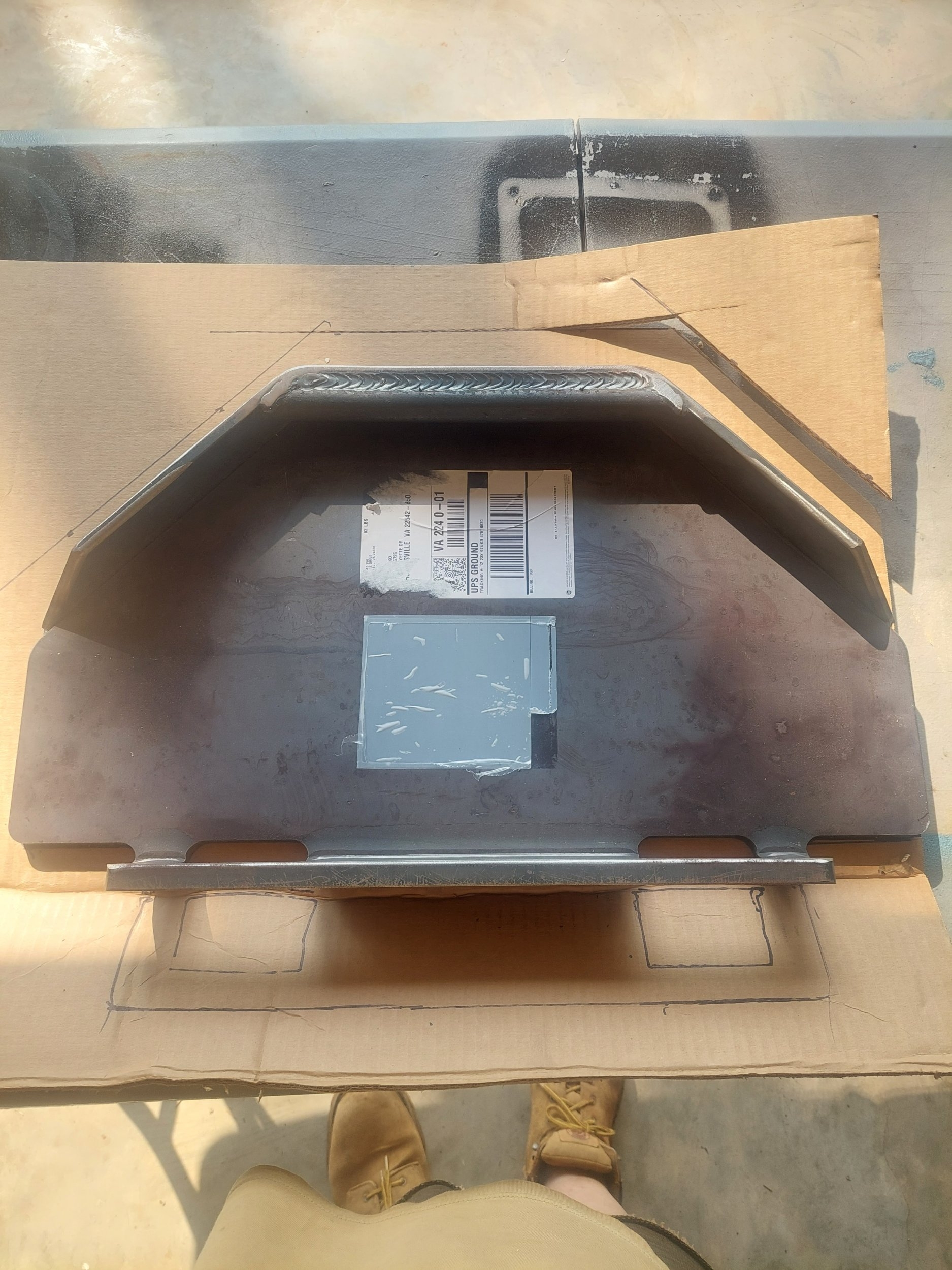

Don’t cut anything off. Make a pattern of the plate from it and make your own. I made 6 of my own.

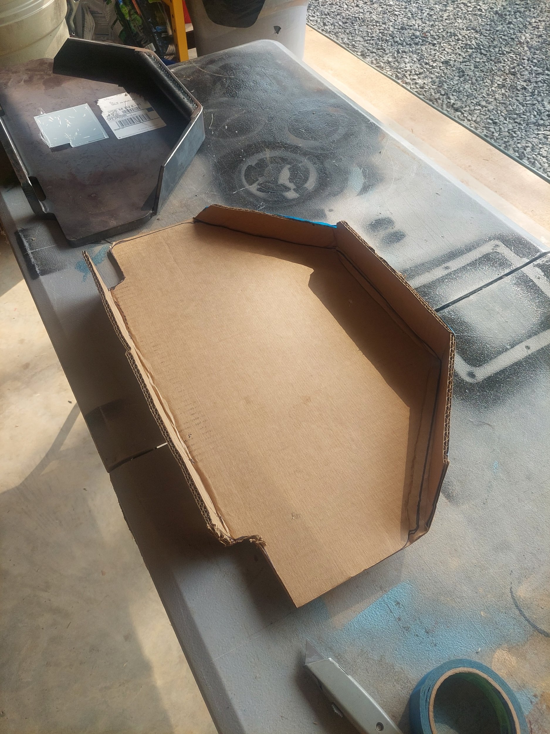

Started the C.A.D design for the adapter plate--cardboard aided design---haha!!!
That cracks me up every time I hear it/say it.
The PT plate is heavy so this should help me figure out the position on the ssqa alot easier.

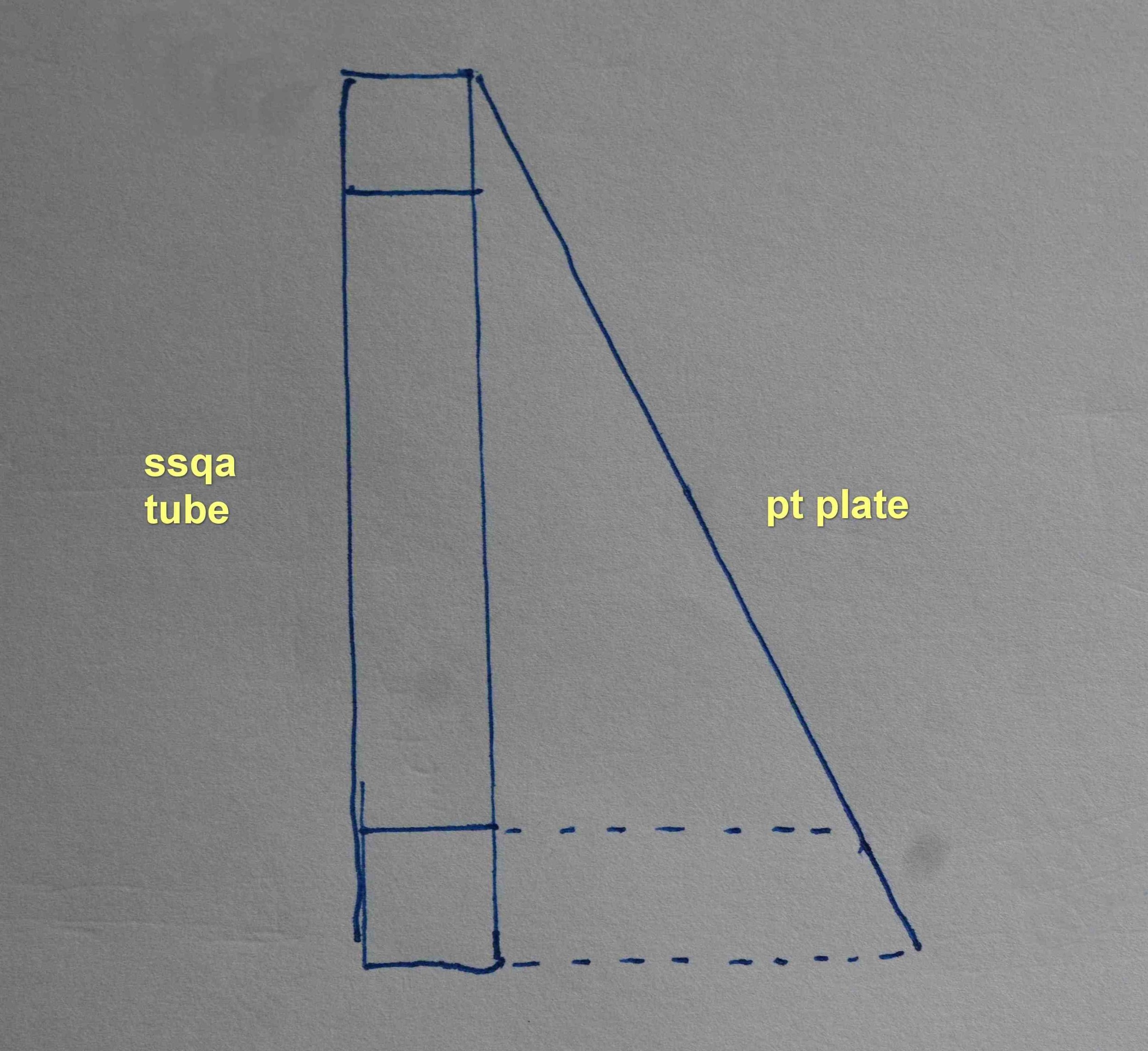

For those SSQAs that have tubes as center cross members, my guess is the easiest way would be to determine the angle needed for mounting the PT plate to the SSQA, and then cutting a couple of pieces of tubing to the correct angle and length.

I am using my cardboard template to fit the location of the PT adapter plate. I cut the middle out of the cardboard adapter where it is too big to fit inside the 3pt side metal portions of the ssqa.
I think I want the top of the PT plate about even with the top tube crossmember of the ssqa. This is a good spot to weld to and places the pt plate about the same distance betwen the top and bottom hook portions of the ssqa plate. I don't think the PT plate will interfere with any implements because it will be set back on the back portion of the top tube crossmember and angled back at the bottom tube crossmember. Does anyone see any implement interference issues with this?

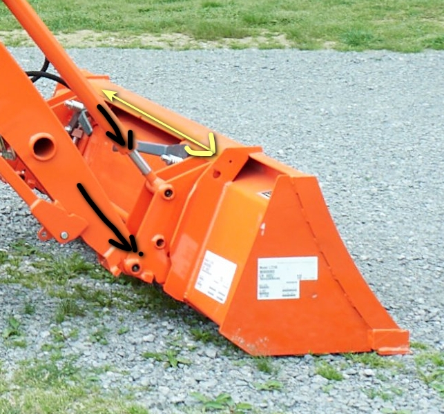

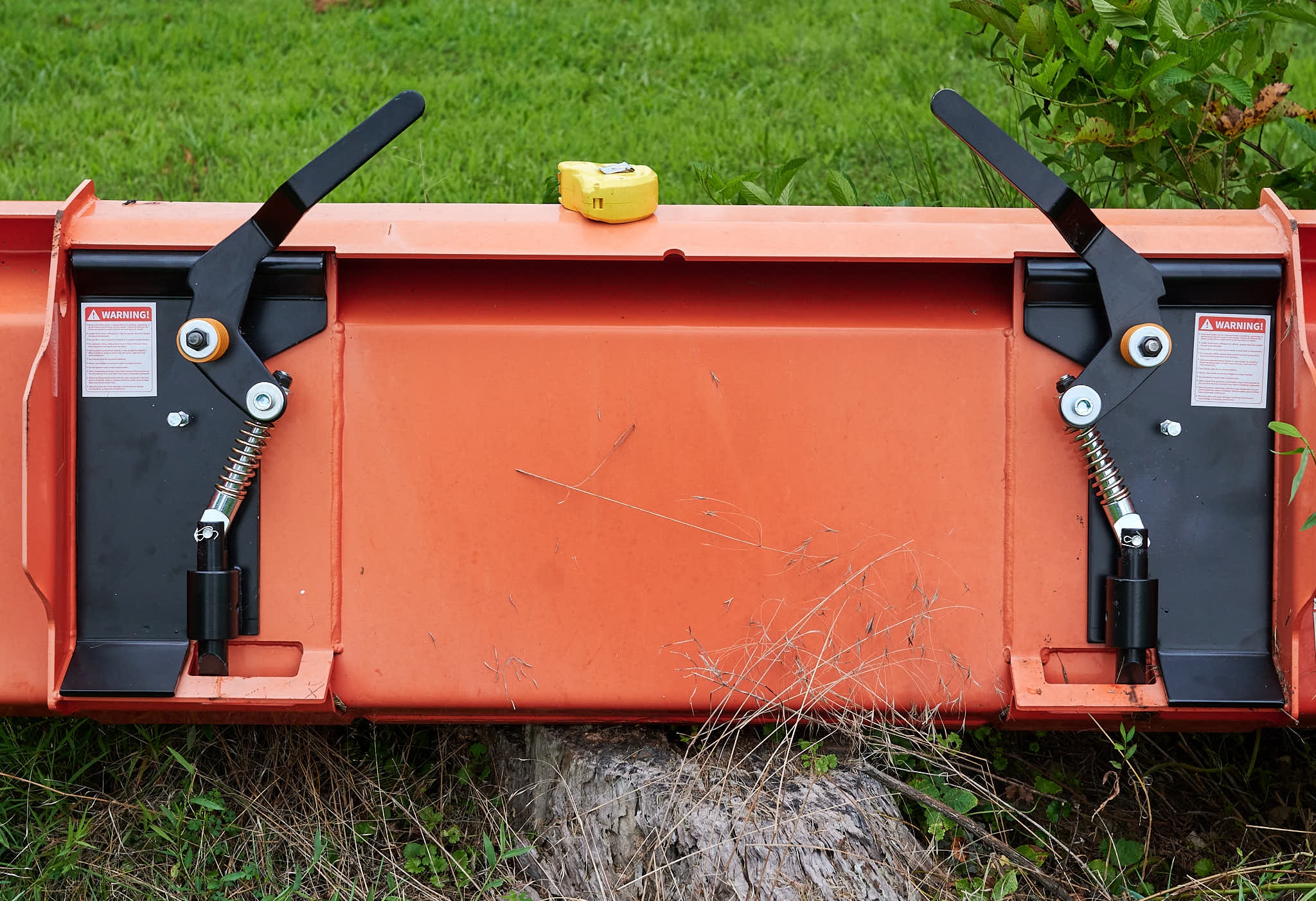

Have you tried putting your SSQA adapter on a SSQA implement yet? The reason I'm asking is the link on Amazon is showing your adapter has an overall width of 30.94 inches. When I measured the overall width of my SSQA mount on my L2501, it's showing 44 10/16 inches wide.
I'll start with an apology for this being confusing because I am confused.
I thought I was going to save myself the trouble of cutting the pieces you've cut off by starting with two latch plates. I also thought it would be easy to weld the tube like shown in green below, but this means installing the plates opposite the sides they are normally intended to be installed.
The other way of maybe dealing with this is to install these the way they are supposed to be installed on a tractor, but cut out part of the latch patch to weld in a tube?
edit: to make less confusing, here is a picture of the way I believe the plates are intended to be installed. The overall width of the top of the SSQA plates end to end is 44 1/4" which now clears the welds on my Kubota bucket.
