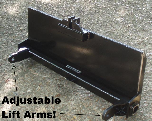

Marrt, Someone made this adapter, One could weld a QA plate to the 3pt framework.

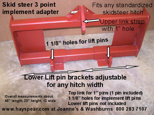

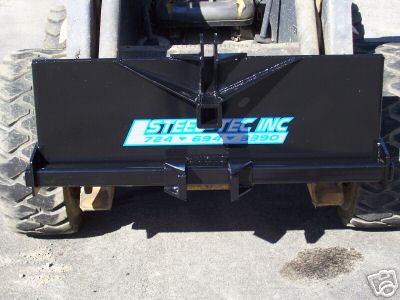

Thanks for the comments. The two attached pictures are for adapters currently for sale on ebay. These don't look as beefy as the Lackender and could be lighter. I don't need anything super strong as the 3 pt. attachments I would buy are "cheap" versions for occasional use only. Also, it looks like I could easily weld (or evem bolt) the PT plate on.

Yes, that Harbor Freight 3 pt quick hitch is very appealing. It can even be had for $80 when ordered from their catalog. I'd be a little concerned about the amount of reinforcement needed for my application. The frame does not take a lot of stress in a normal 3 pt. connection since the tractor's 3 pt. pins connect close to the adater's pins. However, with a PT attach plate welded on, the frame would have to transfer some of the stress loads from the 3 pt. pins up the frame to the PT plate. For a 4xx or smaller class, I'm sure this would work fine. However, for 14xx and up, I suspect it would need some careful reinforcement due to the extra weight of the tractor. Since I don't own a welder yet, it may not be worth the extra cost and expense for me. It's tempting though.
