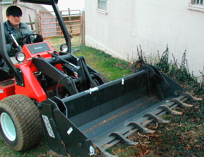

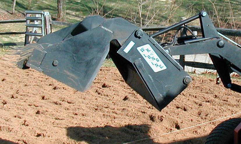

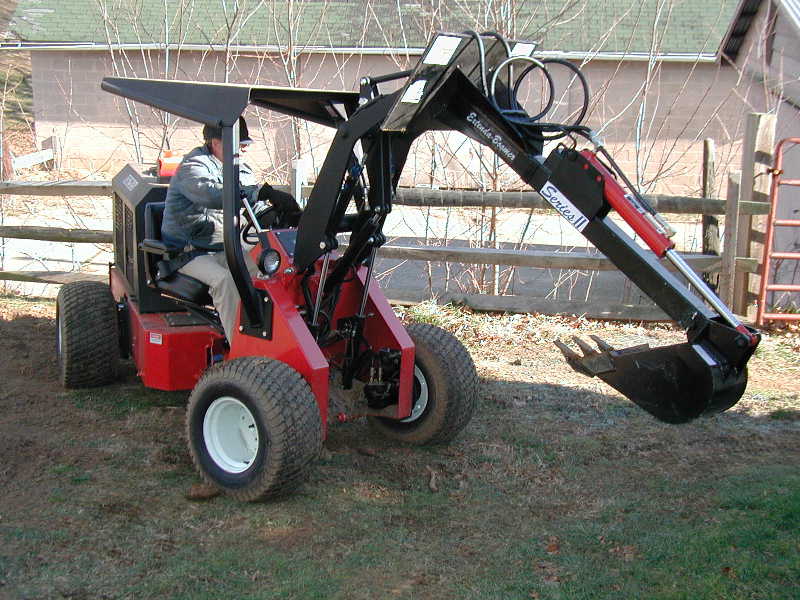

Re: PowerTrac 1845 4 n 1
Charlie, thanks to all the great posts on these forums, yours and others, I've discovered Power Trac and was so impressed I paid them a visit to see for myself just what all the raves are about. Now there's yet another raving Power Trac convert here! What a great bunch of bright talented people putting some well thought out ideas into a product line that is simple, logical, and works. And is built like a tank to boot. What a concept. Now that I've placed my order, subject to my bankers approval, for my very own 1845 I have a question. Well lots of questions actually. But the one of the moment has to do with the Long 4n1. After much thinking about the various alternatives I've decided a 4n1 is a must have. Did you work with Long directly to get this set up or go through Carver? I didn't find any W R Long info on the net. Do you have a number for them? I can hardly wait to get on this thing and ARTICULATE & OSCILLATE many days away! Thanks to all for all the good info. John
