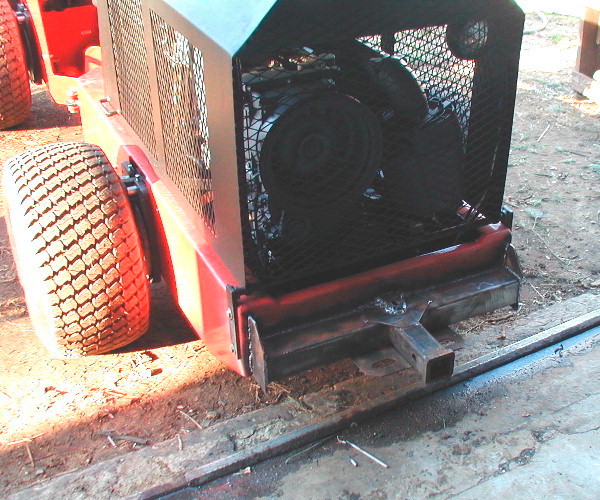

#45
Re: PowerTrac Customizations - PT425 hitch
Well, I took out the tape measure today and measured the distance between the top and bottom ears of the hitch. It is 1 and 7/8" /w3tcompact/icons/frown.gif This is too small to slip in a 2" tube. I'm going to look around and see if I can find some 1 and 1/2 inch or 1 and 3/4 inch tubing and shim it with 1/8 inch flat stock. If I can't find this size tubing, I might be making a smoke wrench adjustment to my hitch, as Charlie did.
/ PowerTrac Customizations #46
A while back, I sent Power-Trac a picture of the hitch we welded on the back of their pretty machine. Those seeing the photos posted here may remember it's a little rough, but stout. More recently, I e-mailed an inquiry (to Kristie Asbury) about the grade of the shear bolt to get as a spare for the post hole digger. Today, I got a call from Terry Estep, at Power Trac, to advise about the bolt. Instead of criticising my modification in any way, he thanked me for the information, and said he has passed on the picture and my other suggestions to the people doing design and assembly. (I had to modify the seat belt retractor mount to align the belt properly, and had the wire pop off the tilt seat solenoid.)

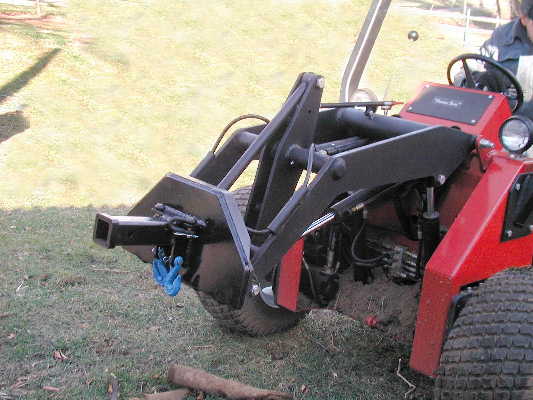

/ PowerTrac Customizations #51
Re: PowerTrac Hook-em Up
Power Trac sells a quick attach plate with a 2" receiver, for use as an airplane tug, pushing trailers and implements around a yard, etc. We decided to weld up our own, to save some money, play with the welder, and add a few hooks and shackles to connect miscellaneous stuff.
/ PowerTrac Customizations #52
If we can't hitch to it with the Power Trac quick attach or the hitch in the picture, we don't want to be associated with it.

/ PowerTrac Customizations #56
Charlie, can you show in a picture how you attached the hitch to the plate? From the one picture it appears you have some type of pin set or is the hitch welded to the plate?
Paul
