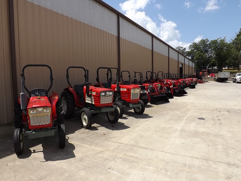

/ Powershift #17
A Yanmar nutters heaven.....:drool:
Oh, that isn't the only pix over there at Fredricks, they have several hundred rebuilt + restored Yanmars.
I can't do it justice showing the several hundred or maybe a few thousand over there.

I wonder how they decide what to put regular ag tires on and what to put the rice tires on? One of those tractors looked like the was nothing g but like a 22 on the name plate area?
And I see they are a Yamaha outboard dealer as well!
/ Powershift
#19
That 850 looks nice! I really liked the look of that ym2610d though!!! And yeah I was wondering the same thing about the tires Clemsonfor. I've seen pictures of a 2210d from Fredricks with rice tires on it and yet mine didn't come with them. I would like to go visit that place just to look around.
