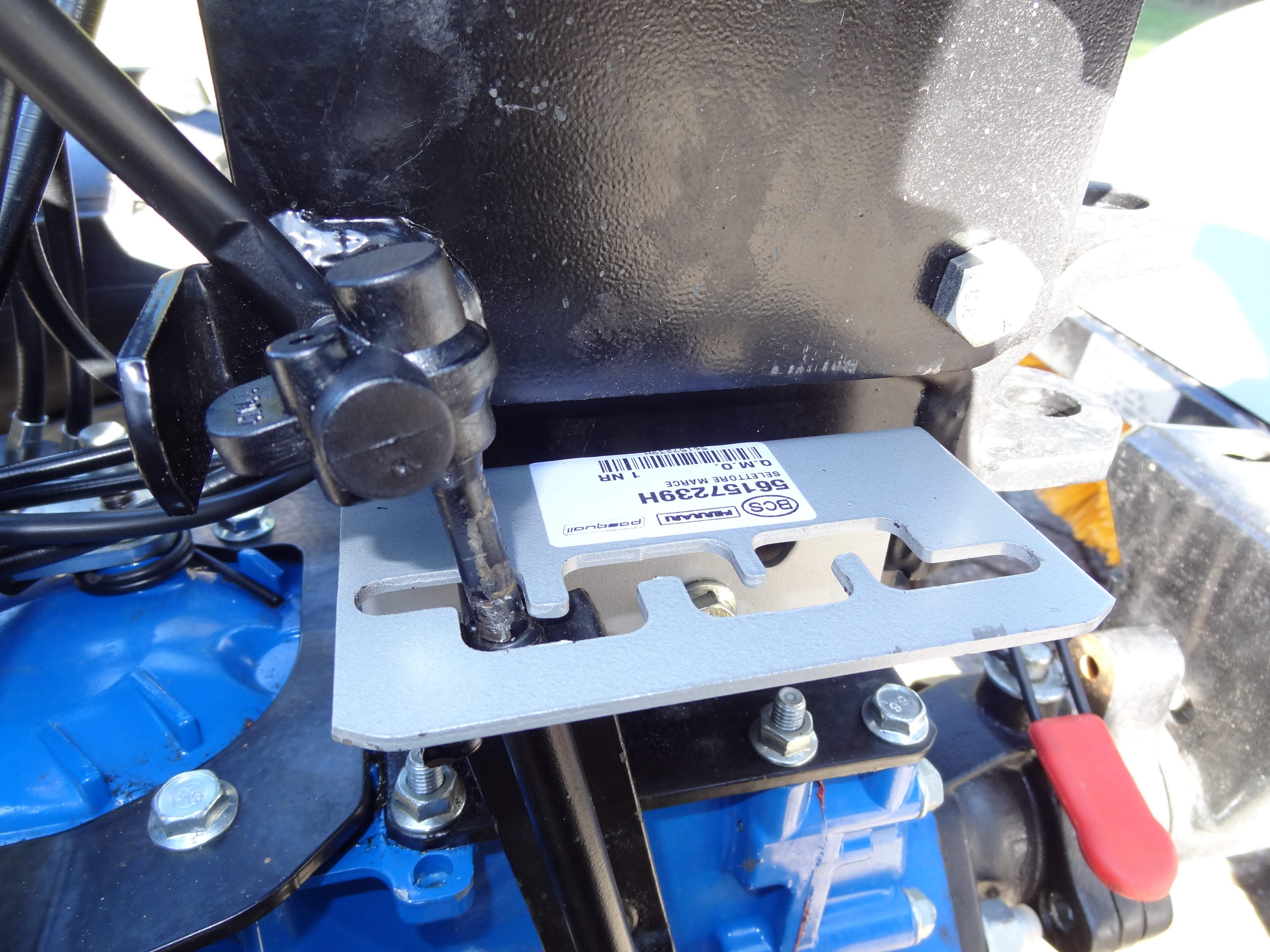

The loss of the transport gear on the new BCS models seems to a frequent topic in this forum, so I decided to take my little test to the next level. As you can see on the pictures below, it all worked out fine :thumbsup:
On my BCS 740 I changed the gear quadrant and the joint to a BCS 853-type (p/n 561.57239 and p/n 552. 47644). As long as BCS does not remove the worm transport gear all together but just blocks it, this gives you the 4th transport gear almost for free.
In order not to compromise safety, I also highly recommend you to change the joint to a BCS 853-type, if you change the quadrant! As seen on my photos, this will prevent you from accidentally selecting the transport gear when in the front-PTO (mowing) mode (left picture), as the joint and the welded tap seen on the far left, only allows the 4th gear to be selected when in the rear-PTO (tiller) mode (right picture), and will block it when in the front-PTO mode.
In order to secure the joint to the gear lever, you will also need the pin (p/n 342.13022). As the gear quadrant comes without any placards, you might also want the decal (p/n 580.57704) too, in order to find the proper gear.
Please do not forget, that because the worm transport gear bypasses the normal gearbox, it will always drive backwards when in the front-PTO mode, disregarding the position of the reverse lever!!!
