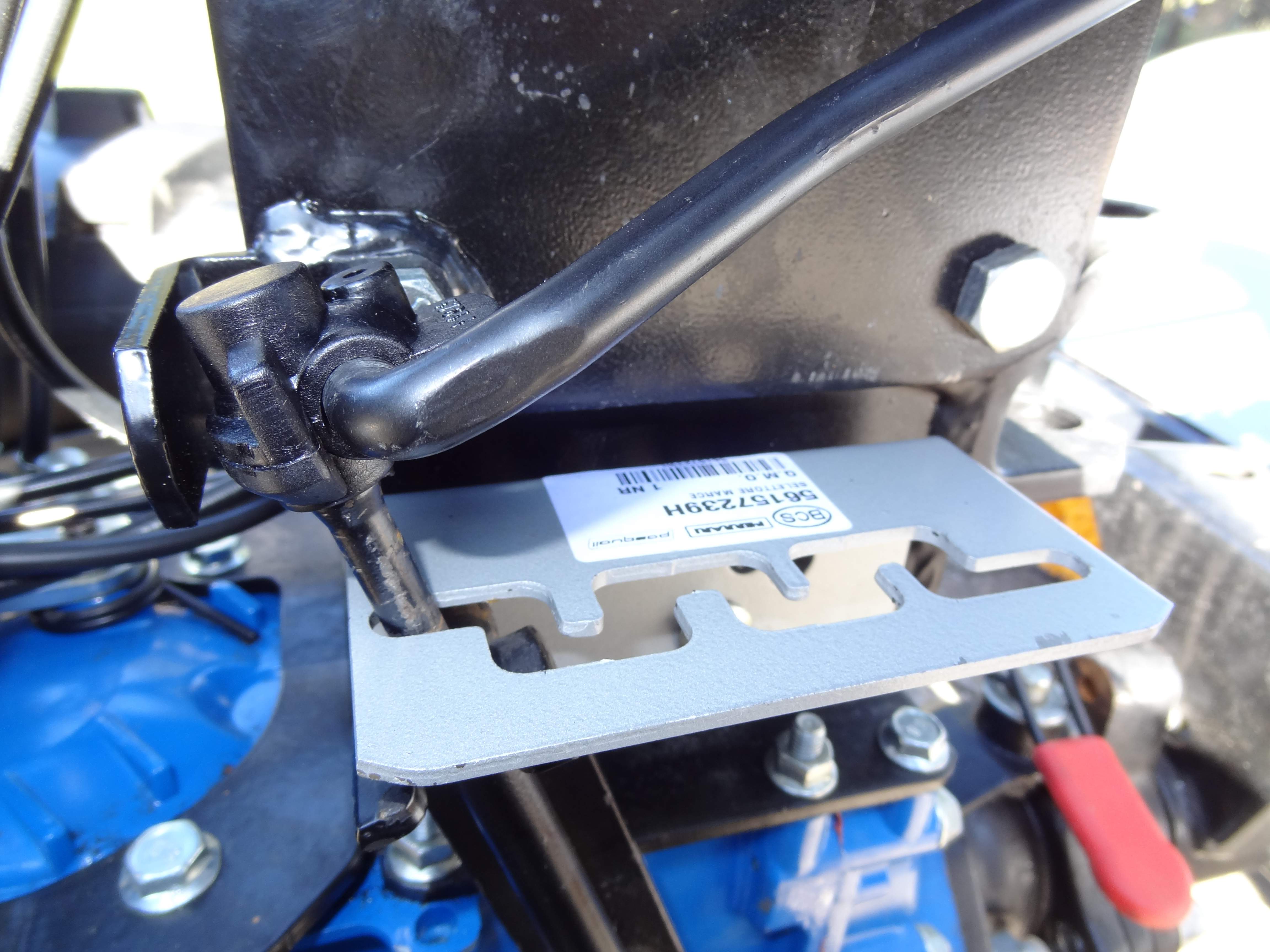

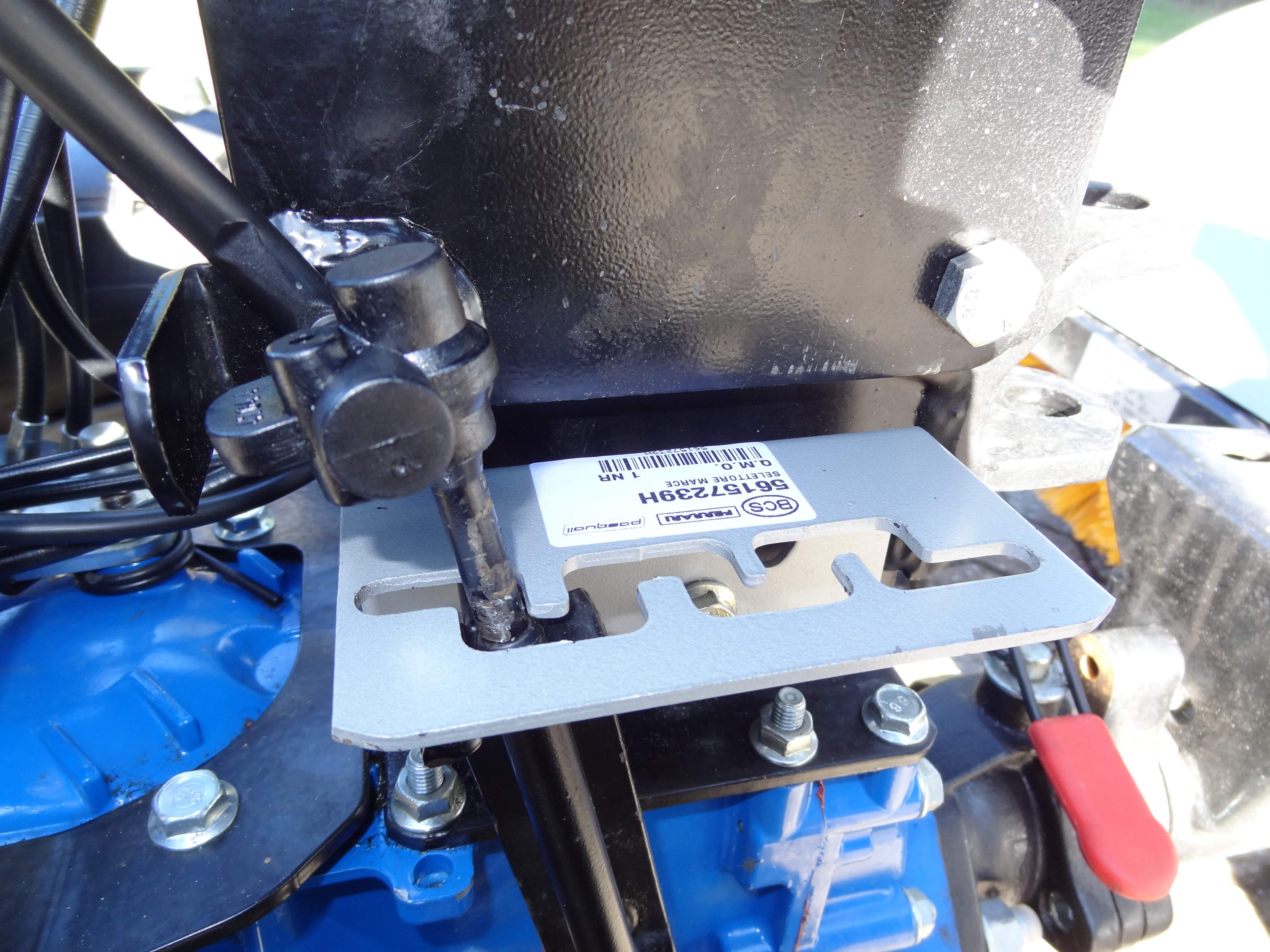

/ "Powersafe" clutch on BCS #126
Hi Stormrider :)
Congratulation with your BCS 740, and welcome to this great forum, where I am sure you will find a lot of useful information, provided by many experienced users.
You are of course aware, that BCS does not recommend the use of trailers and sulkies with their PowerSafe models, as they come to a very abrupt stop when the clutch is disengaged in the 3 working gears! The 4th transport gear seems to work a bit different, and either does not have this braking feature - or it is just less aggressive. The transport gear has probably been blocked due to EU regulations, limiting the speed of 2-wheel tractors to the walking speed "of a driver on foot". I fully understand the concerns that BCS and their layers have, as the tractors have to be safe also in the hands of the "average" - less experienced - user, who perhaps rents a 2-wheel tractor for the first time. On the other hand, in the hands of an experienced owner, who knows his tractor, the transport gear can be very useful with a trailer or sulky.
Your tractor can actually drive without the gear quadrant at all - it is just more difficult for you as a driver to find the proper gear. As you can see on my pictures on page 7 in this thread, the 2 gear quadrants are identical, except that the slot is longer on the one with the transport gear. You can either run your tractor without the gear quadrant, or make the slot a little longer yourself, to enable you to select the transport gear. I got the gear quadrant for 6,87 Euro (7.71 dollar) at my local dealer. If you only use your tractor in the rear-PTO (tiller) mode and you only use it yourself, you can do without the joint. Should you by accident select the 4th gear instead of the 3th, you will drive faster, but in the expected direction at least. But if you also uses the tractor in the front-PTO (mowing) mode, I will highly recommend that you spend 4,07 Euro (4.57 dollar) on the proper joint as well, as it mechanically prevents you from selecting the transport gear when you are in the front-PTO mode (see left picture on page 7). Please remember that the worm transport gear is not influenced by the position of the red reverse lever on the right hand side of the handlebar, but will always drive backwards when you are in the front-PTO mode! That might come as a big surprise to the less experienced user!
As safety should be our top priority when working with a potentially dangerous tool like a tractor, I recommend you to buy these 2 parts. They are so easily changed, and they might save you or someone else a lot of bruises and pain one day!
If you feel comfortable with the speed of the transport gear, I would go for a trailer if I were you.
I am sure a lot of us here in this forum will also look forward to hear about your experiences towing a trailer after a BCS PowerSafe tractor.

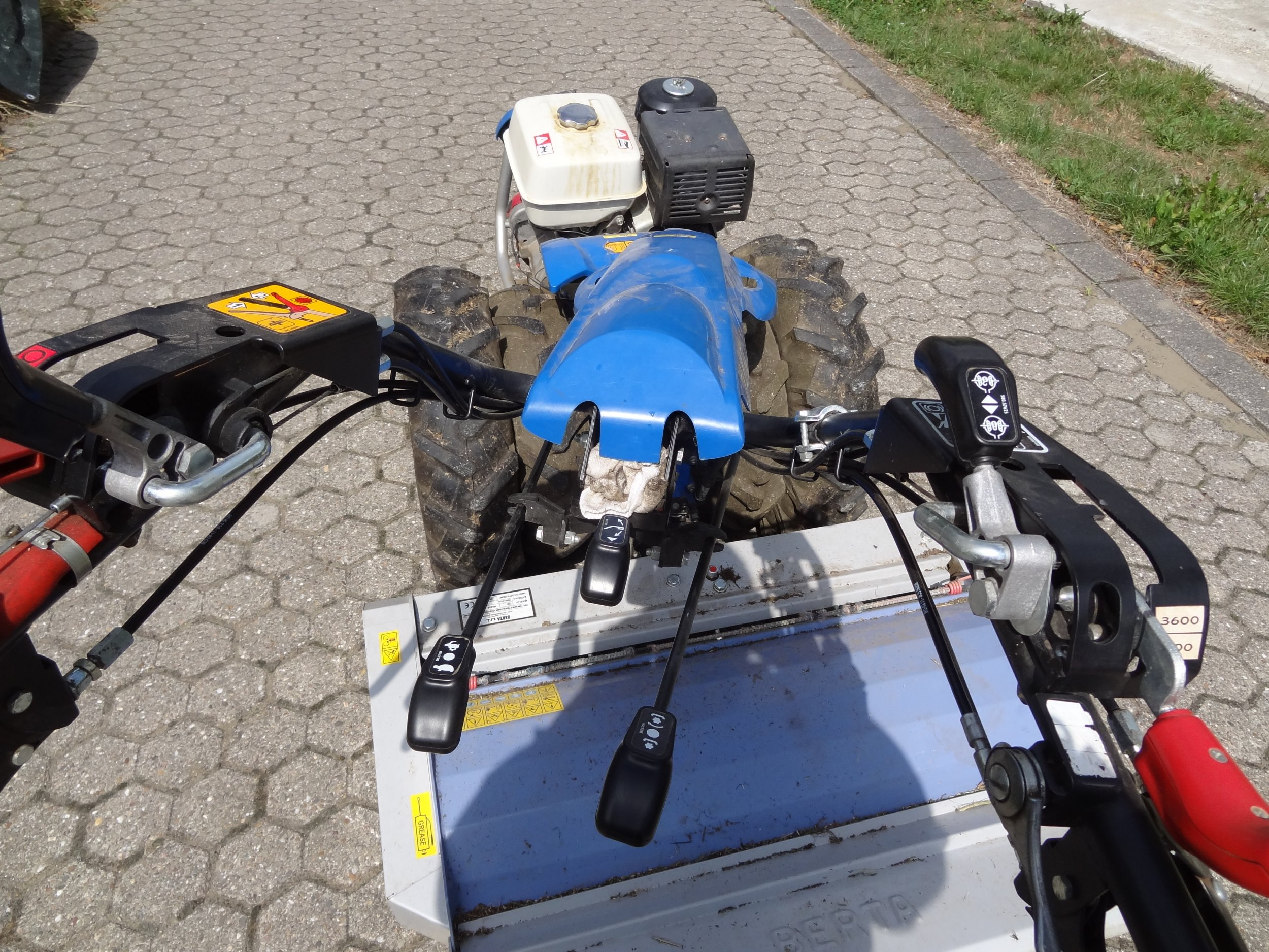

One of the topics that used to be frequently discussed, was the lack of a transport gear in the BCS PowerSafe models. Especially for members with a trailer or a sulky, this was a step in the wrong direction.
As all my 5 implements are used in the front-PTO mode, I have never missed a transport gear although I have one. This is unusual for a PowerSafe model I think, as it seems that it has been removed in all but the very first produced tractors.
My jobs are usually 5-20 km (3-12 miles) from home, so I load my tractor onto a trailer and tow it to the job behind my car. Recently I had a job, where 2 plots were like 10-15 minutes walking distance apart along a forest road. I drove in 3rd gear with like 3/4 throttle, witch fits the walking speed of my old legs (3.9 km/h or 2.4 mph) well. Then I was thinking of my transport gear, and if there was any chance to use it in such a situation, and perhaps run the engine at low idle in 4th gear instead.
For those of our members who are not familiar with the transport gear on a BCS tractor, it is useful to remember, that sadly does this gear not react to the position of the reverse-lever, but will always drive in one direction only! This direction is usually forward when the tractor is in the rear-PTO mode, which makes sense when the tractor is towing a trailer for instance.
I decided to try it out at home first, and the photo below shows my BCS 740 with the Berta flail mower attached, ready for the test. To get a little more space to walk, the handlebars are in the left-of-center position in the rear-PTO mode.
With the 23’’ wheels and the engine at low idle (1400 rpm), the tractor took off much faster than my old legs could follow (6 km/h or 3.7 mph)! It was an interesting test though - and quite fun to see the tractor run this fast, but I will stick to 3rd gear as my personal „transport gear“ in the future, as I have done for 11 years now.
For some of our younger members with faster legs, this might be an option if you have jobs within walking distance, and you have a tractor with a fast transport gear in the rear-PTO mode, but you use an implement in the front-PTO mode.
