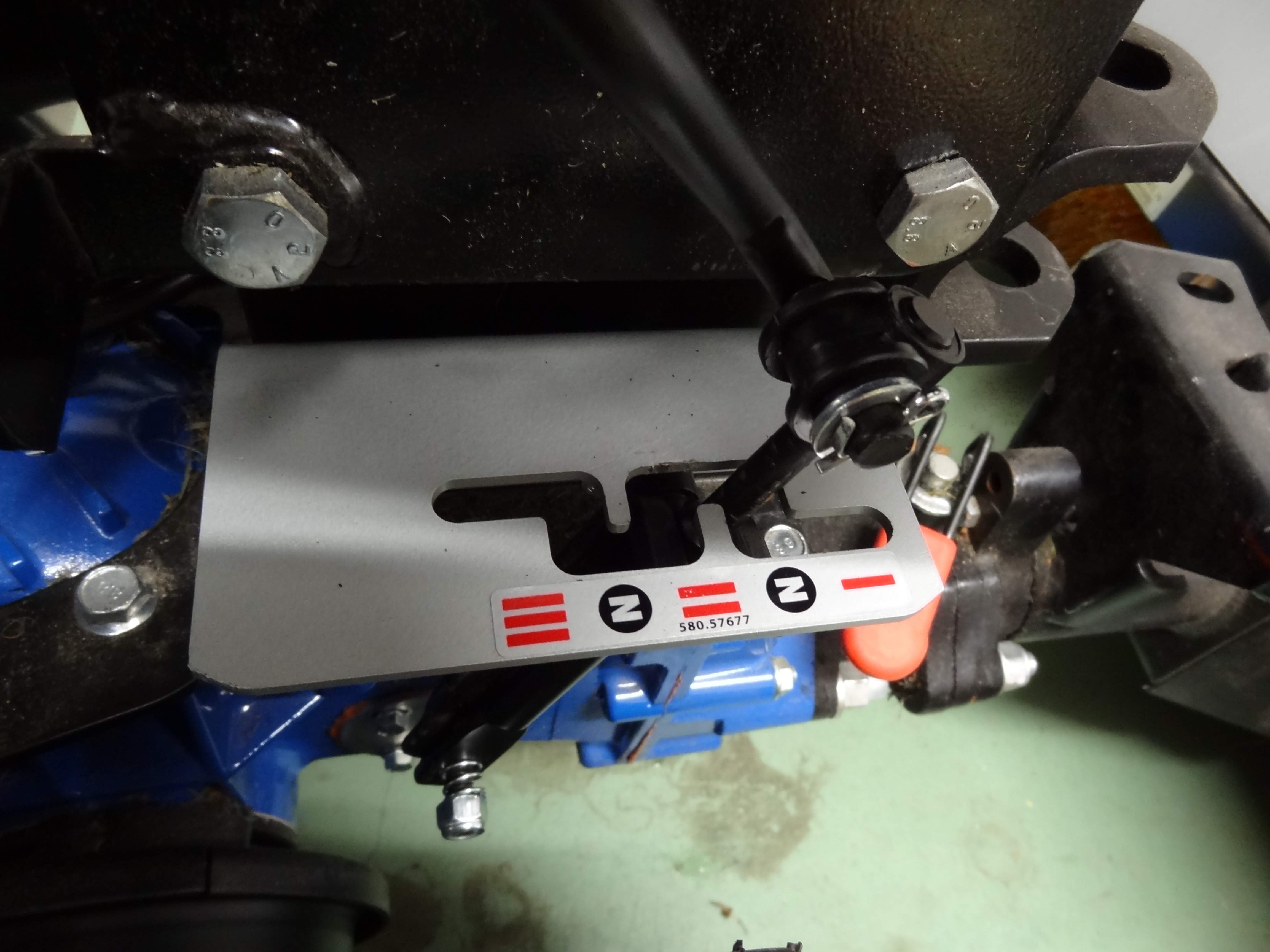

I can imagine this brake function being annoying when you use the tractor with a sulky or trailer. For an unprepared user it can even be dangerous, and that's probably why BCS has put a leaflet in the user's manual, encouraging users not to use sulkies or trailers.
Officially, you only have 3 gears in either direction on the BCSs with the PowerSafe clutch, as the transport gear has been blocked in the gear quadrant. Have you been able to find the 4th gear on your tractor? That might come in handy, if you use sulkies and trailers a lot.

So as a result of these changes BCS decided to design a new style of clutch to resolve many of the regulations.
The PowerSafe clutch uses oil pressure to push a piston forwards that then pushes the drive plates together to provide drive, the clutch unit has a small oil pump that produces around 7-8 bar. When the deadmans lever or clutch lever is released the oil is able to bypasses the clutch piston which then releases pressure on the clutch plates, this release of pressure separates the clutch plates and locks them in place inside the clutch housing causing the machine to stop within 2 seconds. There is no separate braking system in side the clutch or gearbox its all done through the PowerSafe clutch unit.
Due to the revised regulations there is no 4th gear due to the speed it produced, the gears for 4th are not in the gearbox so unfortunately its not just a case of modifying the gear selector plate.
It is not a good idea to use the 'sweet spot' to allow the machine to coast as it could cause rapid wear of the metal on metal clutch plates in the PowerSafe clutch unit, the plates are intended to be either engaged or disengaged not dragging in-between.
It is very important that oil changes are carried out on a regular basis to ensure that the clutch unit is free of any contaminates and has the best quality of oil, while the oil may look clean its EP qualities may have degraded, we recommend that gearbox oil and filters are replaced every 6 months.
