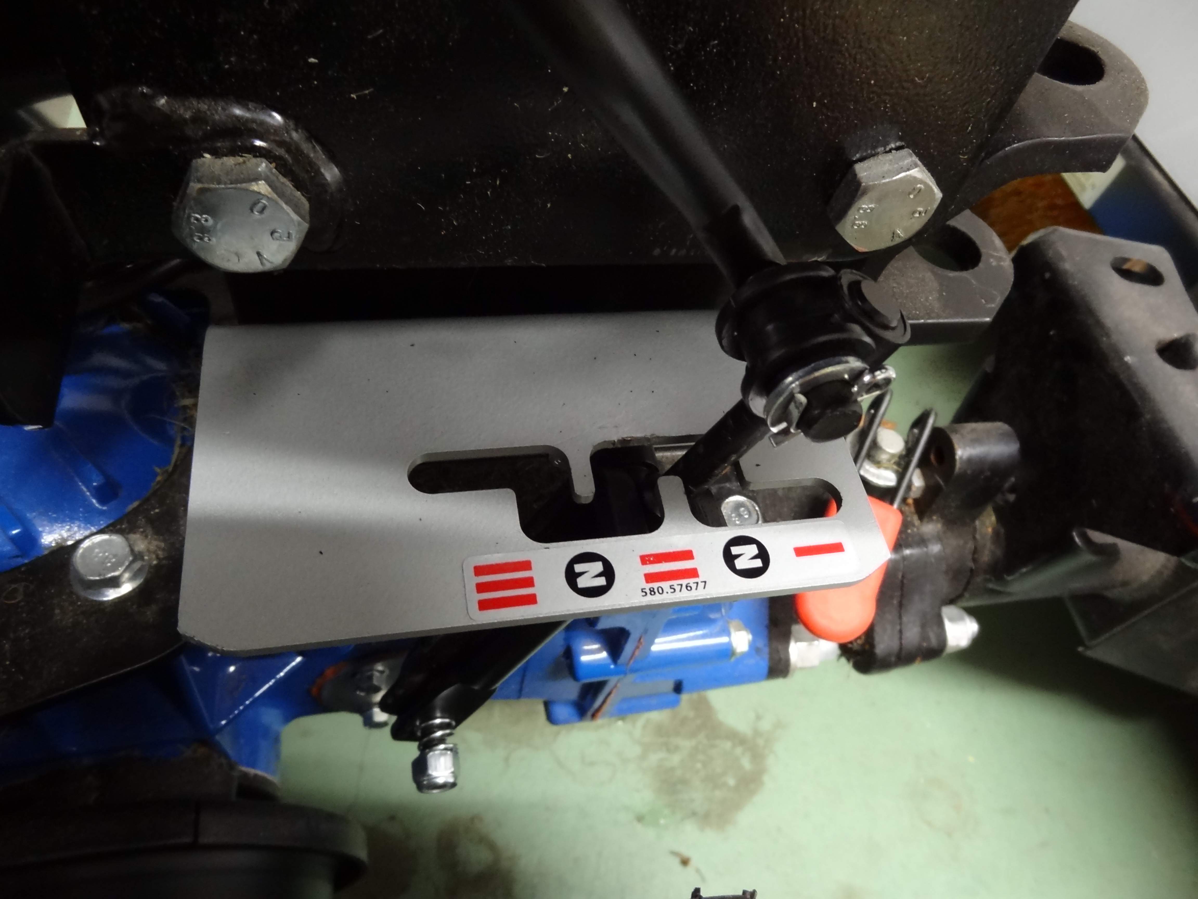

Dear fellow BCS Friends :)
As this is my first contribution in this great forum, I will first of all like to say "thank you" to all of you for sharing your knowledge and experience with us new guys! I was planning not to mention anyone in particular, but now that I have read a great number of posts, I have to give an extra big applause to Bill (farmerboybill), Jean Marc Montigny (oldmech) and to John Wilhelm (BCSSHOP) for sharing your immense knowledge with us, and to take all the time necessary to write all your posts.
After 2 hard winters 2009/10 and 2010/11 with a lot of snow, I decided to spend some of my savings on a 2-wheel-tractor and some snow removal implements. After a lot of resurge, I finally decided to get a BCS 740 with a BCS Sweeper and a BERTA Snow thrower. Sadly we haven't had any snow since :mad:
According to the BCS catalog, the BCS 740 has 3 working gears in each direction. The BCS 740 seems to me to be the same tractor as the BCS 853 sold in USA, so I wondered if perhaps my 740 would in fact also have a 4th transport gear. My owner's manual covers both the 700 and the 800 series, and has a nice table, showing the driving speeds in each gear. Not surprisingly the 740 runs at the same speeds as the 853, indicating that it is in fact the same tractor, but the table even indicate, that the 740 will run 8.35 mph in 4th gear at full throttle!
Having read this thread, and the concerns from oldmech, clytle and others about losing the 4th high speed transport gear, I decided to do a little test.
Looking at the gear quadrant (see attached thumbnail), one could get the idea, that BCS simply cut an extra opening for the 4th gear on the 853, but didn't do so on the 740. So I removed the gear quadrant, and suddenly I also had a 4th gear with high transport speed :thumbsup:
There is a dangerous little catch though: the 4th gear will always run forward in the rear-PTO (tiller) mode, disregarding the position of the quick reverse control lever!!! This can come as a big surprise, when you use an implement in the front-PTO (mowing) mode, and you select the 4th gear. The tractor will suddenly drive backwards towards you, with more than 4 mph at half throttle surprise!
So to those of you who uses implement in the rear-PTO (tiller) mode on your 740 - or maybe even have an trailer or sulky - it might me an idea to change the gear quadrant to a 853 type, and you will get a 4th transport gear almost for free :thumbsup:
Best regards
Jens
