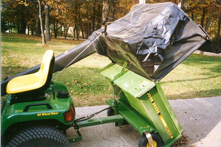

The power flow blower works great, at least for me the last 15 years. There may be a "wet grass" limit, but I haven't found it yet. Only time I get a plug is from not emptying the bag/cart in time.
Get a hyd. dump MC519 cart. I just dump the cart from the tractor seat.

That's awesome! Where did you find a kit for turning that MC519 hydraulic?? If thats possible then i think thats my solution! The only reason i ever steered clear of the MC519 was the lack of power lift, or hydraulic.
/ Powerflo - What's it work like? #10
I bought it through my Deere dealer. Very handy.
PM me if you want the name. I believe someone made them for this dealer. Have had mine for ?? yrs, since '99 or so.
