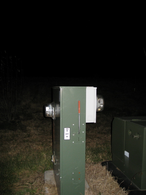

With three different buildings to feed power to and a meter that's 300 yards from the house if I wanted to use a transfer switch I would need to make a pad and install a standby genset.

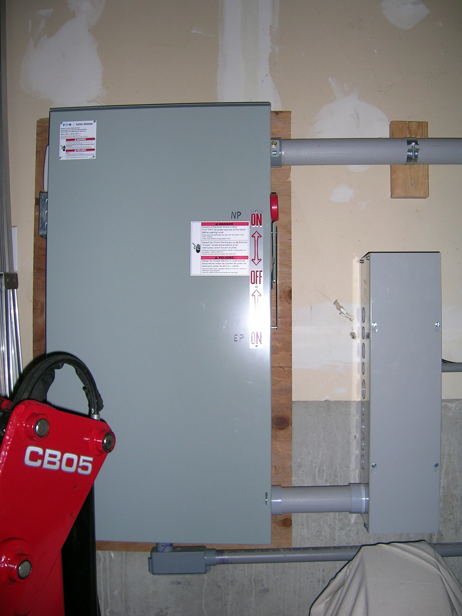

I just have a 200 amp transfer switch between the panel and the meter. Right next to it is a large 50 amp 4 prong twist lock plug.

My incoming line run to a 200A main disconnect then to a 200A transfer switch. The ground/neutral from the meter is connected to a ground rod on the "incomer" side of the transfer switch. There is also a ground rod connection on the generator side of the transfer switch. This totally isolates the load and generator from the power co. system.

The ground and neutral has to be tied together at the service disconnect.
The service disconnect can be the main panel if it is the first place the main can be opened.
If there is a disconnect prior to the panel this that is were it has to be bonded.
From the bond point you have to run 4 wires. to the next device (assuming 120/240 single phase).
