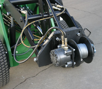

I know a couple of you have the winch from PT for the 400 series machines. And I know we've had this conversation before, but I'd like to have it again if you don't mind. Thanks. :)
Looking at their winch, it appears to be just a HUGE motor with a cable drum directly fastened to it. There's two hoses coming off the motor that go to the AUX PTO ports on the FEL arms. So that means in and out are controlled by the knee lever, correct? How can you pull the cable out as there appears to be no free-wheeling capability? It would be easy to put a cross-connector right at the motor ports with a valve that could be opened to allow fluid to bypass the tractor hydraulics to spool the cable out manually. Then close it for power application. But as I recall in a previous conversation, I thought someone said they did that, but it was still very hard to pull the cable out as your are fighting the internal gearing of the motor VS the hydraulic fluid.
Any thoughts, comments, suggestions from the PT group? Thanks. :thumbsup:

I have tried put a bypass from in to out so I could manually pull the cable out. I could not really do it. I used it last year to winch a log up a hill. It works but is kinda of slow. My main purpose is recovery in case I get stuck in the swamp. Of course since I got it I have not been stuck much.

OK. So a few more questions, if you don't mind.
First, did you get the log up the hill, how big was it, and did it seem to strain the machine at all?
Second, about how slow are we talking? Say, how long would it take to move something 10'? 30 seconds, 5 minutes? Just a ballpark guess would be fine.
Which PTO do you run it off of, main or AUX? In the Power Trac photos it shows running off the AUX, which makes sense to me for directional control.
I've been doing some reading. There's two ways for me to approach it.
1. Get a really big displacement motor and direct drive it (like the PT design). It will be slow, but simple, simple, simple. I could put a removable pin in the shaft to make it freewheeling. Not too hard.
2. Get a small displacement motor and drive a gear reduction. More complicated but some options there.
I've been looking at something like a 0.33 cubic inch motor. At the 4GPM flow rate of the AUX PTO, I should be able to get about 2800rpm out of that motor. Put that into a 50:1 gear reduction and I should be looking at something like 56RPM on the final drive. On a 4" diameter drum that's about 12.5" in circumference, so we'll round things down to about 60RPM on a 1' around drum, so about a foot per second at maximum flow. That doesn't seem too bad to me.
Smaller displacement motors are cheaper than larger displacement motors. But gear reductions aren't cheap.
I've found some references to using center-pivot irrigation gear reductions for winch drive. Someone on TBN has a couple, and he also posted on another forum. Looks interesting. Brand new center-pivot gear drives are less than $300. A motor is about $150. So I'd have $450 plus steel, some bearings, and hoses.
Anyhow, just throwing some ideas around.
Either way I go will require shaft, drum, bearings, plate steel, hoses, and a removable pin for free-wheeling. I found a center-pivot gear reduction that is towable. That turns out to be.... a removable pin in the shaft! hahaha.
Anyhow, any insight would be appreciated. I'm still leaning towards the large displacement motor, slow speed, simple idea VS the gear reduction. It would also be less weight and easier to use on my trailer and PT VS a larger unit with gear reduction.
Thanks, again. :)

The log was about 500 pounds. No trouble moving. I was running it off the aux, but Terry said it could be run off the PTO. You would need a reversing valve. It was about 5 minutes to move it 75 feet. Just a guess of course. It was not supper slow, but I could have just pulled the log by driving backwards. I wanted to see the winch in action.
I think it would work very well with the PTO HYDRAULICS. I would like to have a release so I could pull the cable out manually. Think about that.

Bob mentioned he tried a bypass valve and still couldn't overcome the motor to spool it out. More research on that is needed by me.
I don't want to use it for recovery as the PT never gets stuck.... never, ever, never.... :laughing: If you don't count that time I was brush hogging downhill, went over a log that I thought was about 4" and turned out to be a bit over a foot on the other side, and had just enough momentum to carry me forward enough to be full turtle... no wheels on the ground. Not one. :rolleyes: Even then, I was able to get my chainsaw and cut a piece of wood, shove it under the brush hog and press myself off the log with the FEL arms.
I want it for dragging downed trees down some steep slopes that I'm not able to get near enough with the PT without cutting out trees I don't want to cut out. We have about 20 acres.... there was a 4 acre field, a 6 acre field and a 10 acre plot of trees. We re-forested 4 acres with alternating rows of pines and mixed hardwoods. We let the 6 acres go wild(regret that) to see what would happen. The forester estimated the 10 acre plot to have somewhere between 10-20,000 trees. So, I'm looking at about 1500 locust trees per acre, 60' high average, 3-18" in diameter, with spacing varying from 10' apart to 1' apart... in 7-8 years of wood burning, I've cut down about 50 per year, so about 400, and its cleared about 1/4 acre at best.
Intermixed with the locusts in the 10 acres are a lot of nice maples, several species of oaks, and quite a few ridiculously large multi-trunked cherries. I'm managing the forest for maples (syrup when I retire, maybe) and the other hardwoods, by removing the locusts and cherries. Every time the wind blows, some cherries come down and I'd like to cut them up and use them before they rot on the ground. They rot really fast. I can't pull them out with the little PT425 efficiently (too many cuts), so I'd like to anchor the winch at the base of the hill and drag them down and up onto skid logs to get them off the ground. Then I can cut them up as needed or give them to someone that wants to make boards.
So a hydraulic winch on a 2" hitch plate would allow me to do a few things.
1. Pull small to medium locusts out of the jumble and down the hills safely directly from the PT.
2. Allow me to anchor the winch to a tree, use the PT for power, and pull large cherries down the hill safely with the tree taking the stress of the load VS the PT FEL arms.
3. Allow me to set it on the trailer 2" receiver, power it with a gas motor, and parbuckle logs onto the trailer to take home (about 9 miles).
4. Allow me to perhaps use the winch powered off of the log splitter to lift some of the larger rounds that I sometimes get from friends/family.
Anyhow, not a huge priority right now, but if I have a plan, I can scrounge parts over time and eventually put something together. :)
