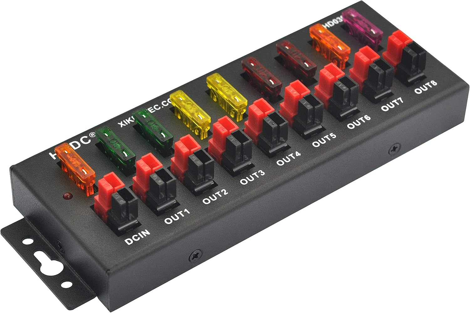

As I get deeper into this farming thing, I’m adding more powered equipment in the cab. I have a nav system, camera system, bail thrower controller, and now a hay preservative system. Everything takes power, and I don’t want a rats nest of power leads coming from the battery into the cab. How have you all solved this problem? What I am thinking of is the main lead of sufficient size up to a bus bar in the cab with some sort of plug system so I can just plug in. It would also be easier for taking things off in the winter time. Any ideas? If you have solved this problem, I’d love to know what parts you used. Not that I think it makes a difference, the tractor that I am working on is an LSMT7101. Thanks.

I have no idea about power to your cab as my Kubota M9's have 3 dedicated and fused circuits that I can tie into. They all terminate in the cab and have Molex blanking plugs on them. Even my open station has them.

What I've done with all my vehicles is to install an extra fuse block in the cab. Then run one positive and one negative wire to the fuse block from the battery. That will give you multiple hookups and they will be fused, always a good thing. Here's an example: Amazon.com
   / Power to the cab #8

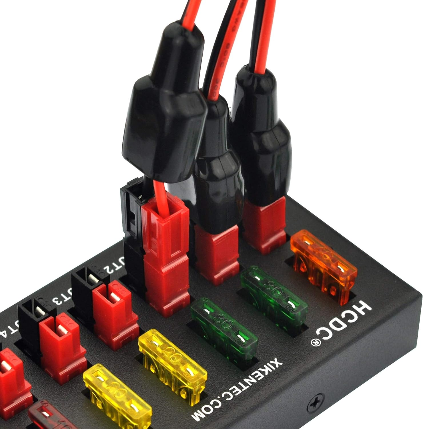

I use this Anderson Powerpole fused buss block:
I mounted it below the dash where it's easily accessible and ran #10 wire forward to the battery.
It provides 8 individually fused circuits, up tp 40 amps, for all my plug in equipment.
