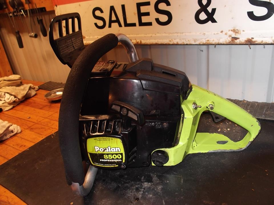

Yes, I set it about 0.010. I couldn't find the exact specs but I think that's about right for most small engines.
I would like to get it going again. I've got an old 14" Poulan that's about 25 years old and it just keeps going.
I cann't confirm the 0.010 gap but have always just used the thickness of a paper matchbook cover or a good business card.
Seemed to always work for me. Probably close but not exact thats for sure.
You got me thinking though next trip out to the shop I am going to check if match cover is close to your 0.010 number
cheers

It has a magneto to make spark?? Try a wire brush or sandpaper
to make the metal nice and shinny! I have seen many a small engine
that the mag got rust and no spark!

The rust doesn't effect the magnet to make spark. The rust will cause the air gap to get smaller to the point it rubs the coil, and that will effect spark. So minor rust coating is no big deal but crusty buildup will.
cheers
.010” is too small of gap. The matchbook cover described would be between.020.-.040” open the gap and spark should be present. In the past I have used neon bulb to verify spark strength over shocking my self. You can use voltmeter on high dc voltage setting at least that would help with strength of spark. Mind you negative leads both bulb and or meter to known ground. I have 3 Poulan saws only use synthetic fuel in them to assure stability.

FYI speaking of gap on magneto not gap on spark plug
