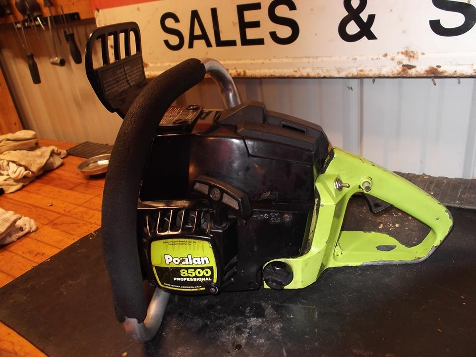

I've run out of things to try on my Poulan Pro 20" (actually a Husqvarna). It wouldn't start and had no spark. I checked the plug, and it sparked on another saw. I disconnected the kill switch, no change. I got a new coil (with plug wire) and still no spark. I rechecked the gap and the plug. Still nothing. This is a pretty simple system. Is there anything else to try before I throw it away?

Are you only checking for spark using a spark plug...??
If so...try using your hand/fingers...hold the wire and ground the base of your hand to the engine...slowly turn the crank at first...

Did you check the air gap on the coil, besides the gap on the spark plug?
/ Poulan Troubleshooting
Yes, I set it about 0.010. I couldn't find the exact specs but I think that's about right for most small engines.

To you, you have checked everything: spark plug, ignition coil. But to me you have not checked everything. Try few more things:
  • Check if the air filter is clogged. Clean it.
  • Gas to oil ratio might be inappropiate
  • Fuel might be bad

I cann't confirm the 0.010 gap but have always just used the thickness of a paper matchbook cover or a good business card.
Seemed to always work for me. Probably close but not exact thats for sure.
You got me thinking though next trip out to the shop I am going to check if match cover is close to your 0.010 number
cheers
.010” is too small of gap. The matchbook cover described would be between.020.-.040” open the gap and spark should be present. In the past I have used neon bulb to verify spark strength over shocking my self. You can use voltmeter on high dc voltage setting at least that would help with strength of spark. Mind you negative leads both bulb and or meter to known ground. I have 3 Poulan saws only use synthetic fuel in them to assure stability.
FYI speaking of gap on magneto not gap on spark plug
