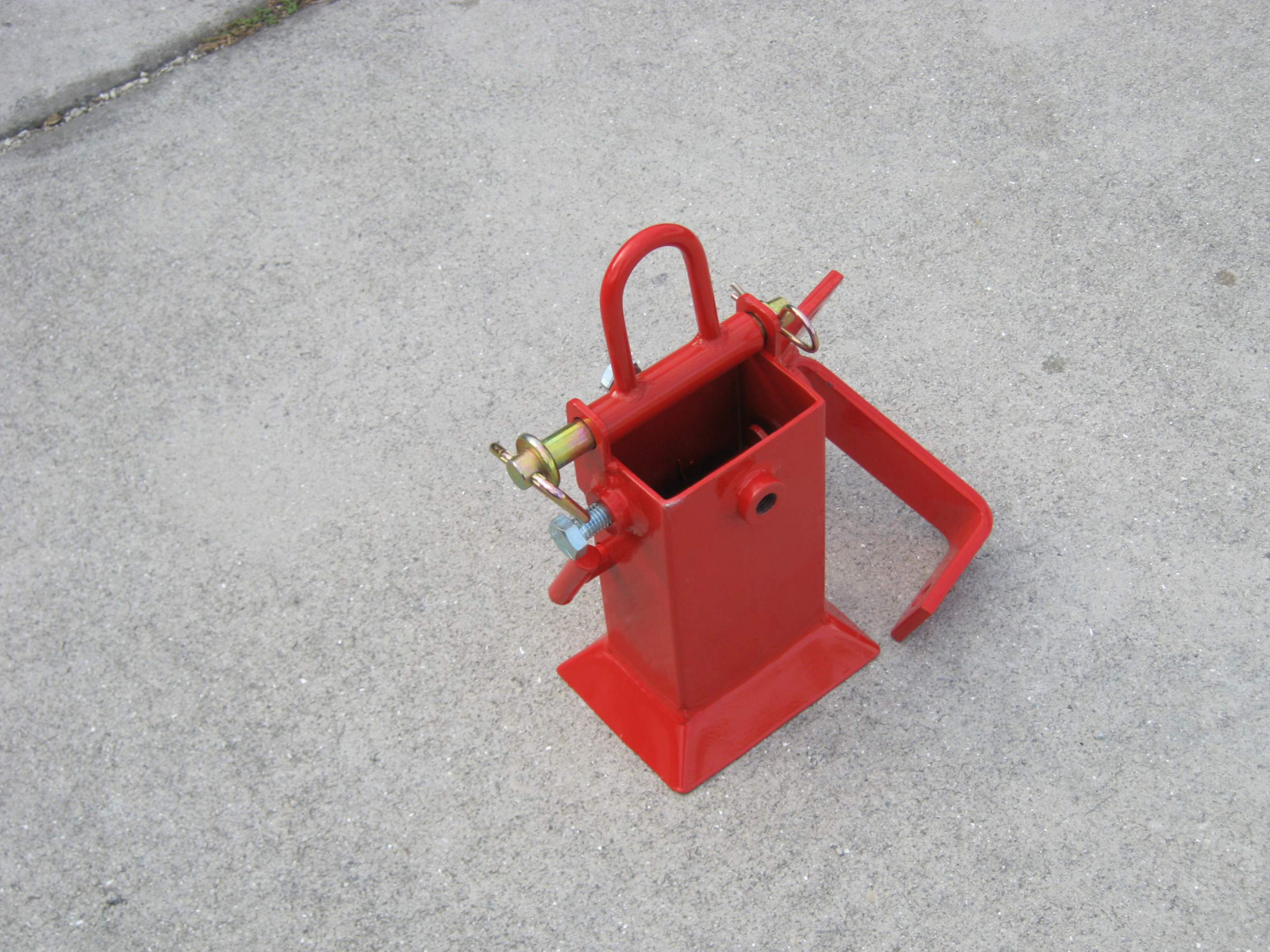

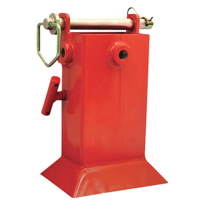

I sold it with one of my tractors but I had this tee post puller . Of course mounts on FEL . It was made by Speeco , this was over ten years ago . It has a rope tied to it to release the tee post were you want to drop it .

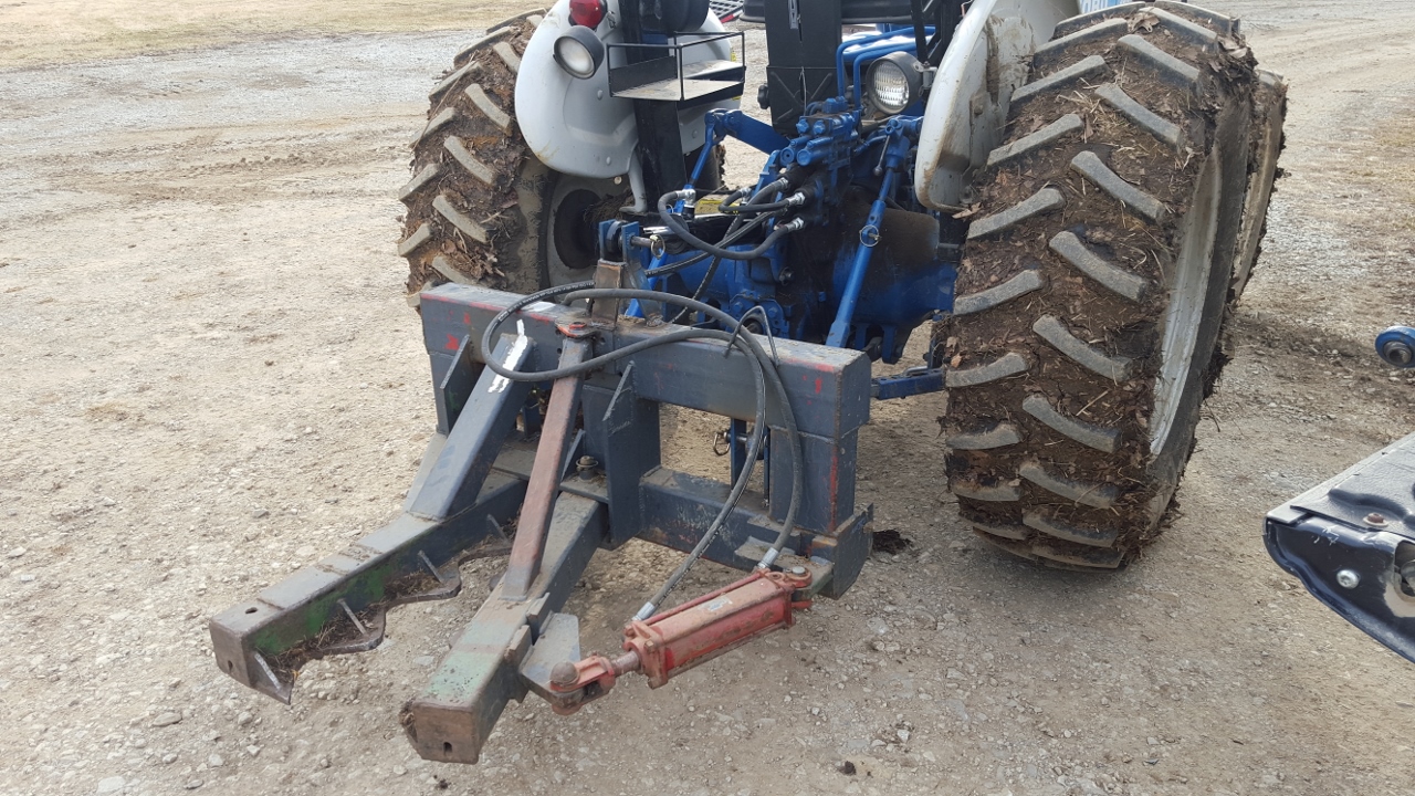

Built this one. As Don said, gotta be gentle on the bite with small stuff.
