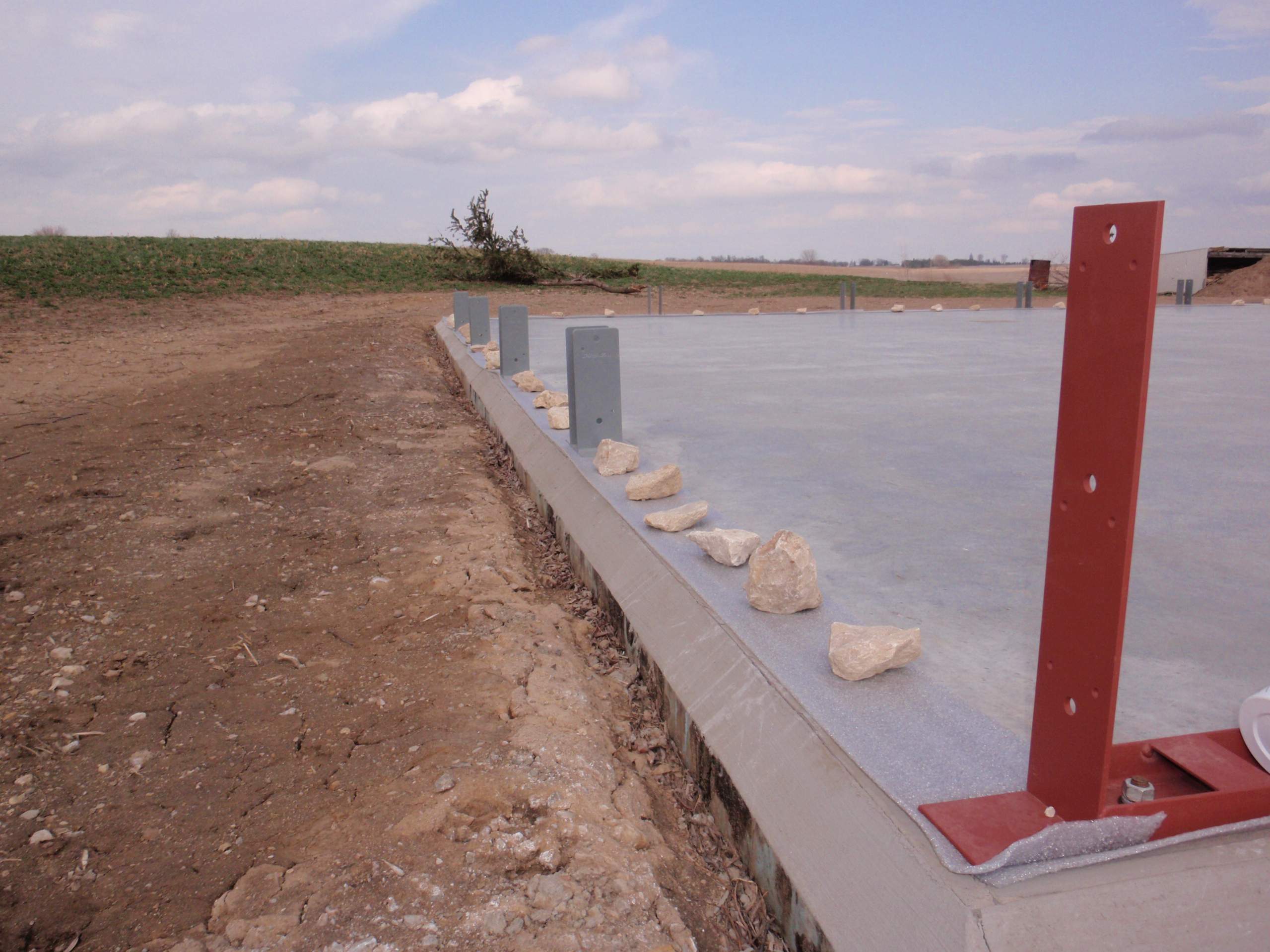

I'll second keeping the wood out of the soil.
Pour footings with integral, metal attachments to anchor the posts above grade.
This discourages rot, allows you to use shorter posts and allows you to easily remove/replace a damaged post in the future.

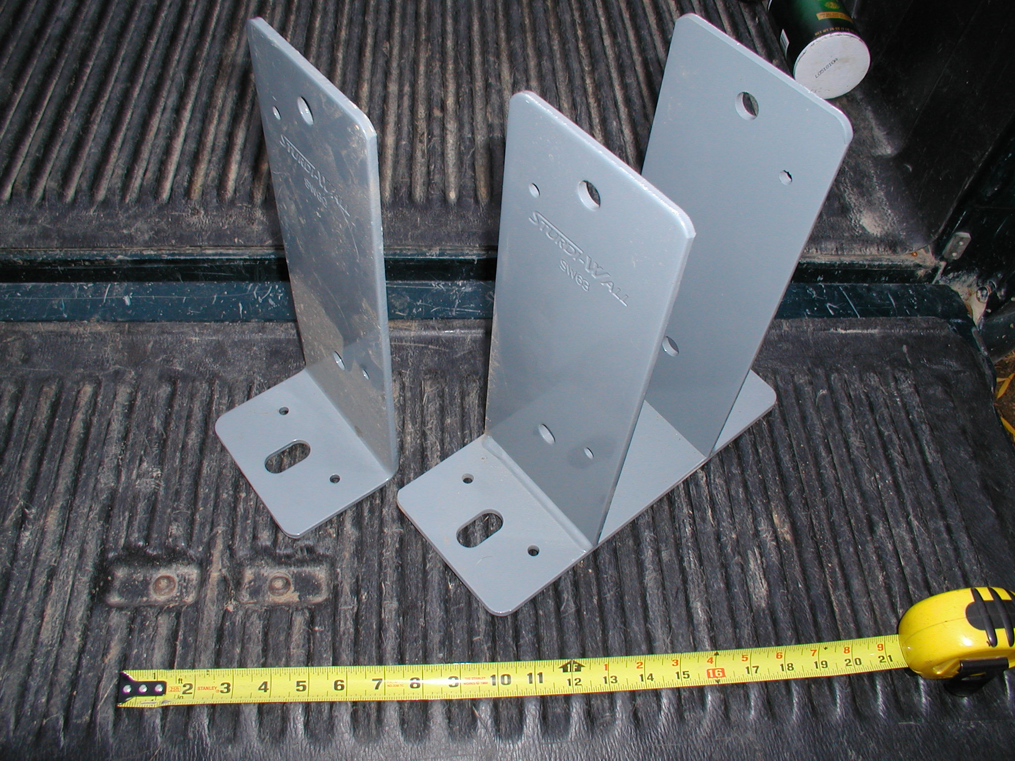

Or buy these Perma-column brand, Sturdi-wall brackets like I used...
Perma-Column | What are Sturdi-Wall Brackets

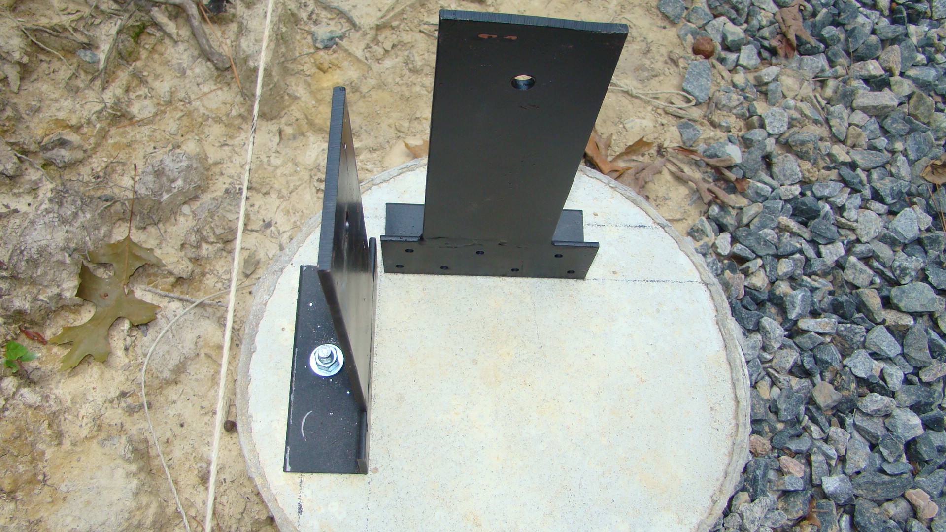

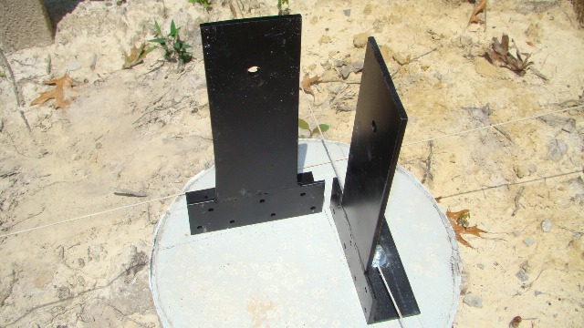

I looked at something like that but they were pricey as all get out. I made my own out of 3/16 flat bar welded to 3/16- 2x2 angel iron pieces 5 inches long. The flat bar pieces were 4 inches wide and about 8 inches high and both the flat bar and the angle pieces were drilled with a 1/2" hole to attach to the concrete pad and the post. I saved enough on these brackets to pay for almost all of the concrete it took to pour my piers.
I am curious, how far apart did you space them? How high are your sidewalls? Also, what are the specs of your slab, wall, footers, etc? I tried to get some info about spacing of sturdi-wall brackets from a vendor, but they wrote me back saying I should ask a structural engineer. :(
/ Post for workshop.....Solid vs Glulam #39
Check what your local code allows. Also has to be something sheathing can marry to also. 4' OC is usual for post&beam.
/ Post for workshop.....Solid vs Glulam #40
No code requirements where I live. No permits needed for construction, plumbing, etc. here, believe it or not. :)
I was thinking he did post frame, not post and beam. I'm going to build a post frame building, and don't want to sink posts in the ground. Sturdi-wall brackets look thoroughly decent. Poly protectors look dodgy to me. Don't really want to go with lumber link, timber linx (timber link is more a modern spin on timber framing, really). It would be very unwise to use strongtie's post bases for this purpose. Wanting this thing to last a heck of a lot longer than 40 years, and seen too many treated posts dug up that rotted under the 40 year mark.
