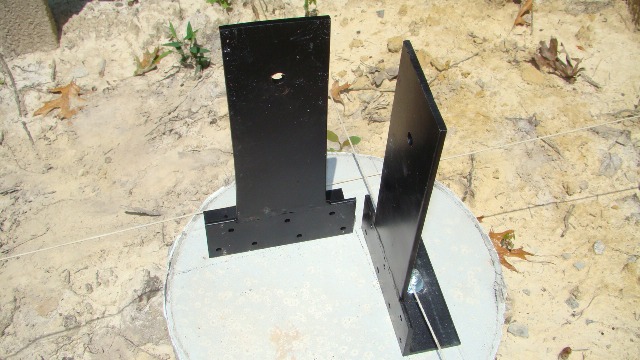

/ Post for workshop.....Solid vs Glulam #36
Or buy these Perma-column brand, Sturdi-wall brackets like I used...
Perma-Column | What are Sturdi-Wall Brackets
I looked at something like that but they were pricey as all get out. I made my own out of 3/16 flat bar welded to 3/16- 2x2 angel iron pieces 5 inches long. The flat bar pieces were 4 inches wide and about 8 inches high and both the flat bar and the angle pieces were drilled with a 1/2" hole to attach to the concrete pad and the post. I saved enough on these brackets to pay for almost all of the concrete it took to pour my piers.
I am curious, how far apart did you space them? How high are your sidewalls? Also, what are the specs of your slab, wall, footers, etc? I tried to get some info about spacing of sturdi-wall brackets from a vendor, but they wrote me back saying I should ask a structural engineer. :(
