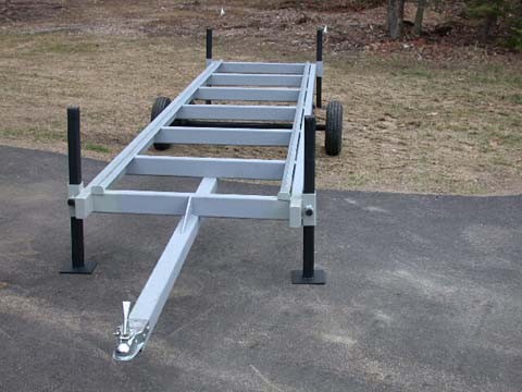

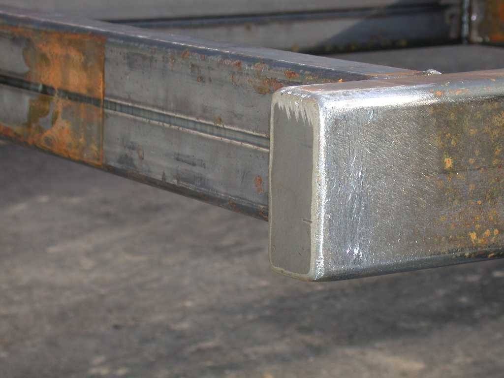

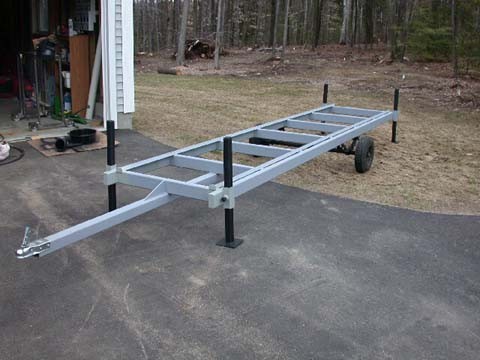

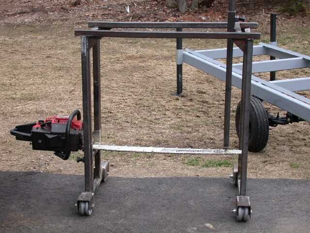

Ok, here are some photo's of my progress.
