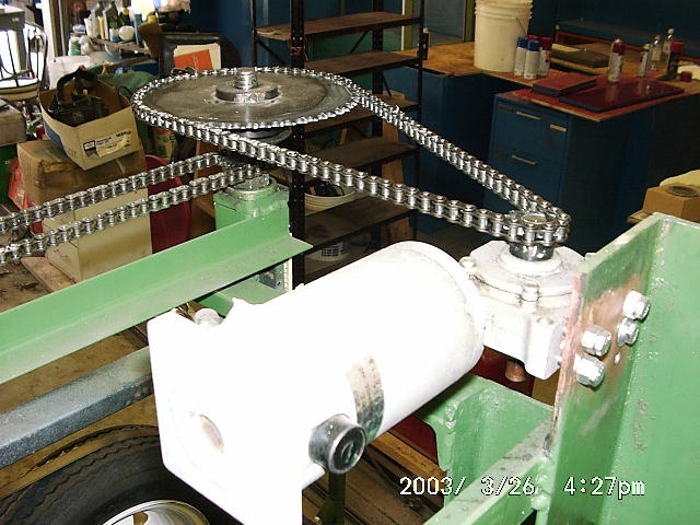

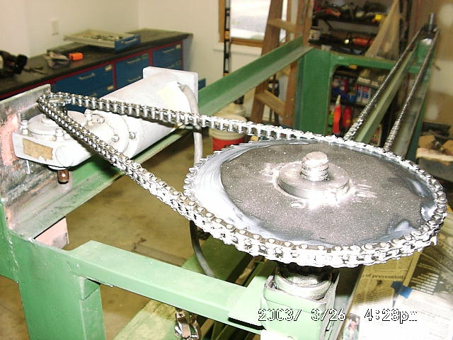

And here is how the whole table of the saw moves up and down.

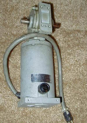

sprocket
This little motor turns the larger sprocket which turns a Acme threaded rod on both sides of the frame inside the 2" square channel legs.
gary
