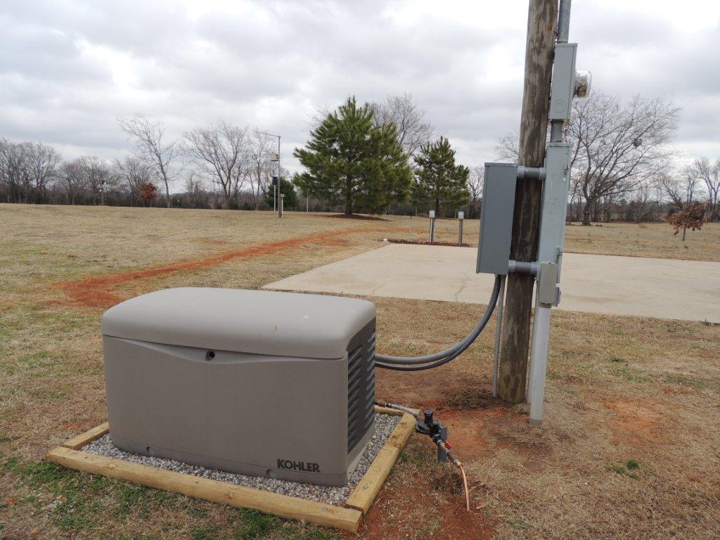

A couple of years ago I invested in a Kohler 20kw LP gas powered whole house standby generator. It was one of the best things I have done. It easily runs our 4-ton heat pump and other appliances. (The emergency heat strips on the heat pump are locked out when on generator power.) So far it has over 50 hours of running time and has worked flawlessly when the utility power goes off both in summer and winter. The generator automatically starts and comes on line in 10 seconds when a power outage occurs...no muss, no fuss and I don't have to worry about a power outage if I'm away from home.
Bill
That is a sweet setup! I called to see what it would cost to get natural gas to the house and after they stopped laughing, was told something around 1,000,000 US. Actually I thought that's a pretty good deal when i found out the main was about 30 miles away, on the other side of a river. :)
