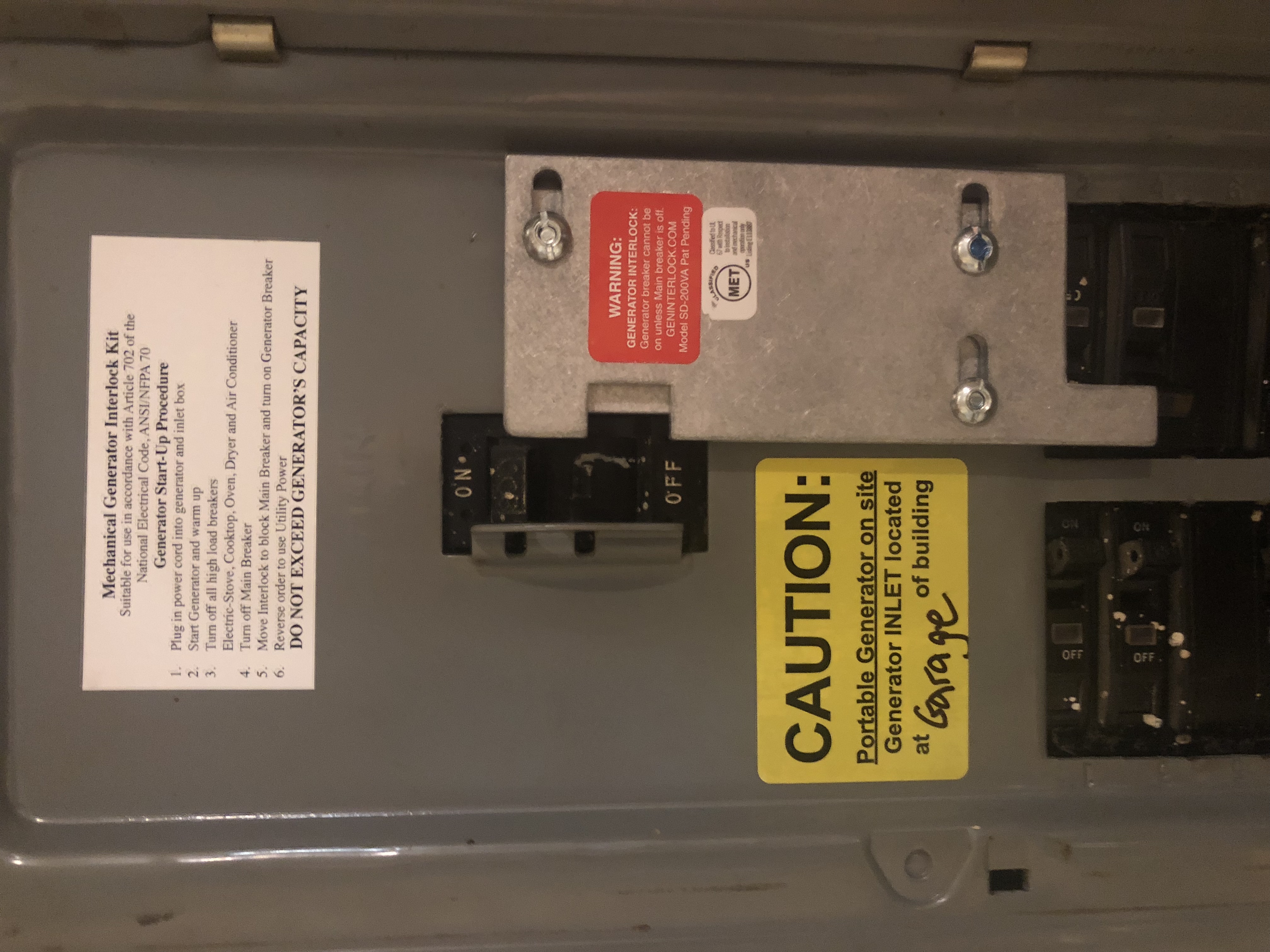

Really excited to finally get everything set up. Figured I would share my setup with everyone. Using a portable generator to back feed panel. Safety panel interlocks in place!

The generator interlocks are the most important part of the setup IMO. This setup requires a 2 pole 50 amp breaker to be placed in the breaker box. The interlock kit makes it impossible to have both the main breaker and generator breaker on at the same time. It will only allow one or the other at a time. This prevents the generator for back feeding the main power lines or the generator and main line both attempting to power the house at the same time.
I did have to replace my electric water heater with natural gas so that I could free up 2 poles in my breaker box. That was extra cost but not required by most folks.

By the way, those safety switches ate just great, and so very, very simple. On ours, it is a circle rotates back-and-forth between the main power and the generator power. It has only one slot in it, so it will not allow both switches to be on at the same time.
